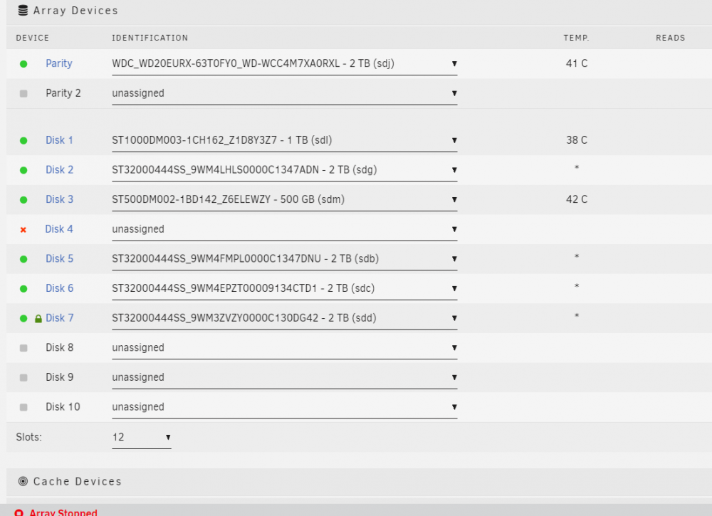

This is where i'm at:image.thumb.png.e575c6fff1a7c429107e14a06f8e51fd.png
Disk 5 is empty, because i've just moved everything off in the last unbalance move.  It's still in xfs, can i format it in xfs encrypted, and then move the emulated Disk 4 over with unbalance.  Then when emulated disk 4 is empty, create a new config carry them all forward, remove disk 4 and mark parity not valid.
I'm just not sure how i format Disk 5 to encrypted xfs in the above workflow?
\\Edit:Or do i have to move emulated Disk 4 to Disk 5 formatted in xfs as is?
Edited by alexdodd
18 hours ago, alexdodd said:
if i put no device in its place, start and rebuild parity that is correct right?
It will start with an emulated disk4 (assuming parity is valid), you don't want to rebuild parity now if there's still data there.
Yep, so i started with it emulated, moved it away to other drives, started a new config carried the config forward without the dead drive, rebuilt partiy.  I think I might actually be starting to get the hang of this without worrying so much.  I doubt myself everytime in case I screw it up 😂
So now I have an empty 2tb drive (sdg/Disk2), but formated in XFS, still added to the array.  However I want this in an encrypted FS.
In my head i need to create a new config, but if I assign the drive to the same slot, how do i force unraid to format it?
Is there something i'm missing?
Edited by alexdodd
1 minute ago, alexdodd said:
So now I have a 2tb drive with nothing on, formated in XFS, still added to the array.  However I want this in an encrypted FS.
Yep. No need to do a new config, just stop the array, and set the desired file system type on that drive to encrypted. When you start the array, the drive should show up as unmountable, and you will need to confirm the prompt to format it.
New config is only for recalculating parity, and since parity has no concept of files or file systems, it's not needed to redo parity when changing formats. Parity stays valid through the entire process.
