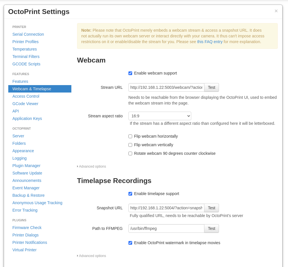

  • You need video drivers installed on unRaid for the kernel to see a camera.
    • (on Version: 6.10.0-rc1) - install DVB Drivers in Community Apps and select LibreELEC
    • This will need a reboot after installation
  • plug in your camera, you should see /dev/video0 appear in a terminal session on unRaid
  • Install OctoPrint-Spants
    • add the following:
      • variables:
        • ENABLE_MJPG_STREAMER         true
        • CAMERA_DEV                            /dev/video0
        • MJPG_STREAMER_INPUT           -y -n -r 640x480 (can change to suit)
      • port:
        • webcam           container port 80      host port 5003
        • snapshot          container port 8080  host port 5004
  • In octoprint's webcam settings
    • set the stream url to     http://IPADDRESS:5003/webcam/?action=stream and test - it should work
    • set the snapshot url to       http://IPADDRESS:5004/?action=snapshot and test
    • IPADDRESS is your unraid server address if you used bridge networking

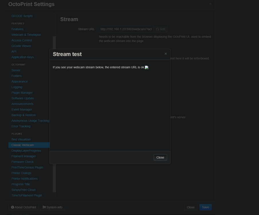

I got it seeing the printer so half the battle but not having any luck with getting the camera to to show.
I installed the dvb drivers. In unraid dev I video0 and video1 (tried both).
Only difference I can see I gave the container a local IP.
Fumbling at this but can't get a stream.

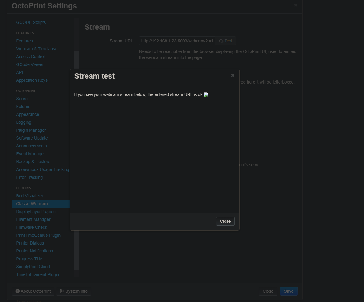

Any pointers? I have read through the previous threads but not having any luck with USB camera.
I installed the usb plugin for unraid and I can see the device is connecting fine.
When you have the docker image running, what dev are you pointing to for usb camera?
For my particular setup it was /dev/video0
This was set under the actual edit details for the image.
I also found that if you have any vm's running, they have a habit of auto connecting the camera to themselves, so having the USB Manager plugin helped oodles as I could easily detach from the vm before running up the docker so as to allow the camera to connect ok. As I had already set this in the docker image config, it would crash on loading if the camera was already assigned to a vm.... Did my head in for a couple of days
I have tried /dev/video0 and video1. I see both in the the unraid /dev/. I don't have any vm's running. I do have the usb manger installed and it see's the camera and notes it as disconnected.
Im trying to remember, but I think the default web address could be incorrect with the docker config.
How is your docker network setup and what url is the webconfig set to in octoprint config?
DJ
DJ
--net='br0'
--ip='192.168.1.23'
http://192.168.1.23:5003/webcam/?action=stream
Just for anyone trying to get simpleprint to work with this octo-image..
from simpleprtint support:
In particular the sentry_sdk dependency of sqlalchemy is more than 5 years out of date and can be fixed by upgrading it to the newest 1.x version 1.4.49.
pip install sqlalchemy==1.4.49
Running this fixed it simple print hanging on code generation. A shout out to the sinpleprint support team, they were super helpful.
--net='br0'
--ip='192.168.1.23'
Yours looks almost exactly the same as mine cept for the obvious ip address difference....
What error message etc are you getting when you goto test the webcam address?
No error, just no image
In the logs I see some warnings, i'll grab them on the next reboot, I don't see them now.
I have -y -n -r 1024x768 in mjpg streamer input fyi.
My camera can do this res but prefers 720 x 568. But just send it I reckon :D
Originally I just tried 640x480 but that wasn’t working either.
I do see some errors but it's mostly complaining that it can't get the stream for images, which... yeah. :p.

Mate, you have got me.
If it was me, i would drop linux mint or something on there as a vm, make sure the octo print one is off and see if you can attach the camera to vm and see if it is actually working. What model of camera is it too btw?
Yeah pulled the camera off and tested it on a windows box, physically works fine.
I see this spamming the container logs
MJPG Streamer Version.: 2.0
 i: Using V4L2 device.: (null)
 i: Desired Resolution: 720 x 1280
 i: Frames Per Second.: -1
 i: Format............: YUYV
 i: JPEG Quality......: 80
 i: TV-Norm...........: DEFAULT
 i: init_VideoIn failed
Not sure what to do about it though :(.
So it awesome that you plugged it into a windows box and it worked fine... Done well. But, like in my post earlier, I couldnt get the usb-serial driver to work "native" on my box that I am using with my anet a8+. I had to plug it into a usb hub (nfi why but something I had seen in the past). Can I ask you to try on a vm on that unraid machine please? 20 mins to spin up mint and you can delete when done, or even win10 if you can be bothered(understand if you didnt want too :))
I setup a windows 11 vm and the usb camera worked fine mounted to that. I got a few suggestions over on the octopi forum but most of the nix commands don't work on the console (lsusb etc). Maybe I'll just setupa  pi vm LOL.
So I'm reading the old dvb method is no longer valid and a custom kernel is needed. This seems kind of nuts though.
I'm unclear if this outdated or stil lvalid. I don't see the kernel helper in apps though.
