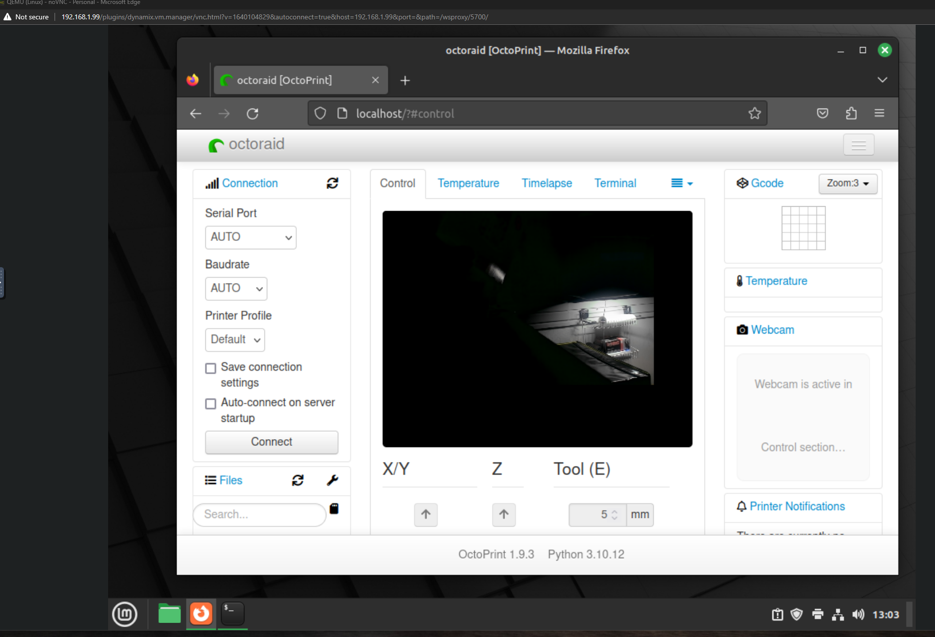

So I instaled mint and then used octo deploy. Now I'm having the reverse issue of getting the printer to show up, but the camera works fine, though a full VM seems over kill.
But I think this limted the issue to the docker container or unraid config somewhere.

Right soooo, turns out a had accidently unplugged the printer from the PC when moving cameras around. No serial in VM solved.
So VM looks like it will work though YEEESH, huge resource waste compared to the docker.
But zero luck with docker octoprint vidoe. I ran through every possible permutation of device and /dev/video* again just to make sure I hadn't missed some combo. Also tried same with MS life cam.
I might try with some other container for vid over usb, I mean somebody has to have this working as general practice, octoprint being a little nich compared to video security etc.
Mint VM runniing OCTO_deploy script, webcam up, printer up.

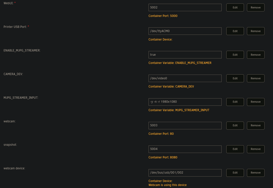

Hey everyone,
I finally got this working (with USB Camera)
Note* I did have to install the DVB drivers (a reboot might have been needed)
I could not get it the usb camera to show as dev/video0 (this is why I had tried it)
The webcam device, to find the right path you have to go with lsusb (terminal on unraid) which will return bus/dev/ mine was 001/002.
for me this gave me the full details in terminal as well
udevadm info    --name=/dev/bus/usb/001/002
As for the Classic Webcam settings are as such:
Stream URL:
http://[IP]:5003/webcam/?action=stream (as the docker settings tell you)
Snapshot URL:
http://[IP]:5004/?action=snapshot (as the docker settings tell you)
