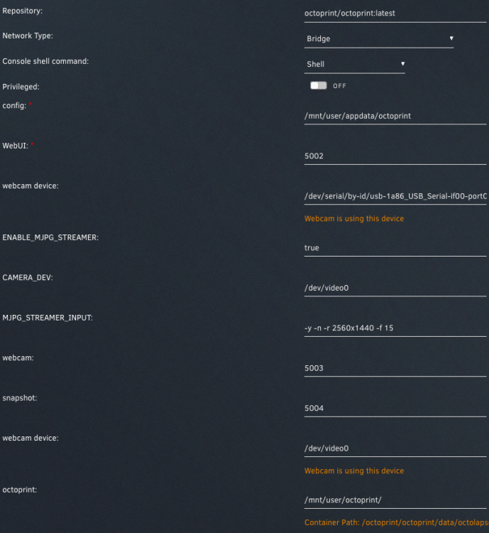

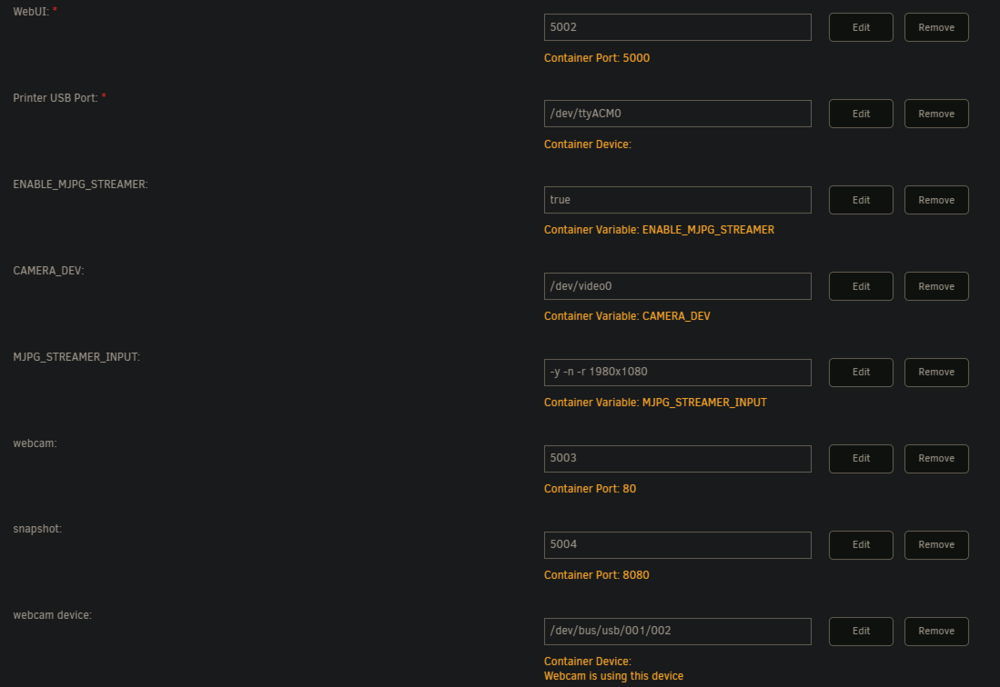

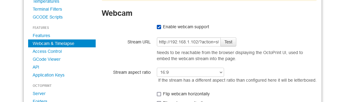

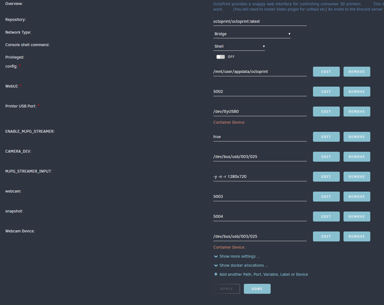

Can somebody help me get webcam working?
I setup Octoprint with this template and my settings are as indicated below:
The printer is detecting fine, but the webcam doesnt work.  I enter http://192.168.1.102/?action=stream in the test URL in Octoprint but nothing comes up.
SOLVED!!!
I have figured out a solution in case anybody comes across this in the future having the same issue.
First off, if your webcam is showing up as a USB device when you type the command "lsusb" in unraid, but NOT assigning a dev/video0 to it, it is a driver issue.  My picture above shows me using the USB Device ( dev/bus/usb/003/025) because I had no dev/video0.  I figured out that it was because my webcam (Logitech C270) was old and even tho is was listed correctly in USB devices, it was missing drivers.  This thread talks about this issue.  So I went to the Unraid app store and searched for DVB drivers by ich777 and installed that.  Upon server reboot, I was now getting a dev/video0 and dev/video1.  I tried both and the octoprint log spazed out with dev/video1 (so I guess that was incorrect) but worked correctly with dev/video0.

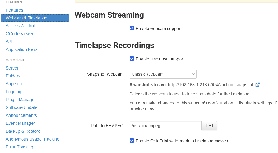

The last part of the puzzle was figuring out the stream URLs to enter in octoprints timelapse settings page.
They are:
Stream Url: http://xxx.xxx.xxx.xxx:5003/webcam/?action=stream
Snapshot URL: http://xxx.xxx.xxx.xxx:5004/?action=snapshot (This did work for me but then gave me problems later.  http://127.0.0.1:8080/?action=snapshot later worked for me)
I needed to enter the port numbers set on the unraid template.  the internal port numbers of 80 and 8080 dont work.  You can also test the stream url by just entering it in your browser, and should see your webcam if its working.
Edited by 007craft

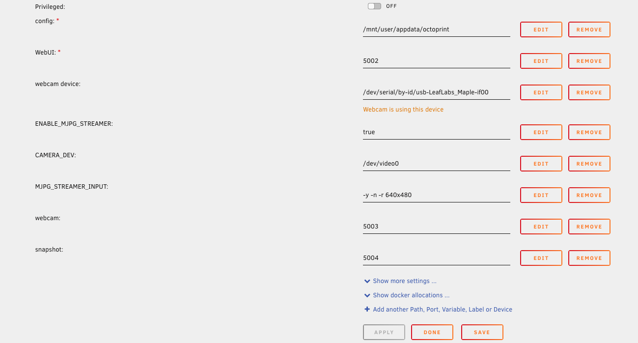

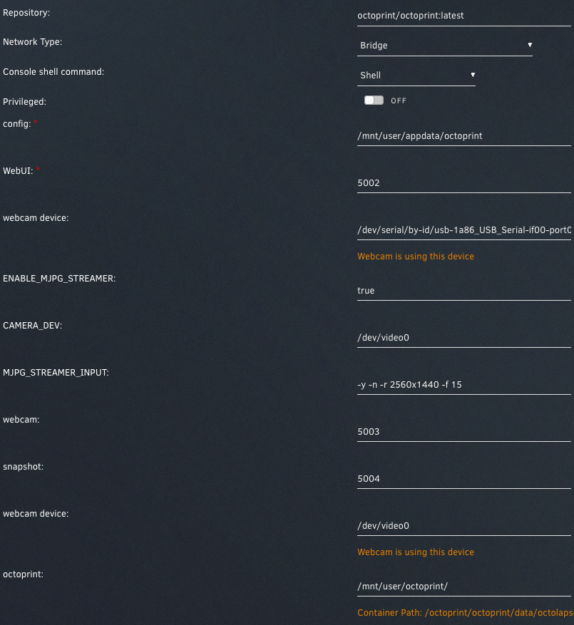

On 3/3/2022 at 12:01 PM, spants said:
best to use the /dev/serial/by-id/ method rather than usbtty as the port may change if you plug the printers in differently
When I use /dev/serial/by-id/usb-1a86_USB_Serial-if00-port0 (The only entry I have, and is indeed my printer as when I unplug it, that entry goes away), it doesn't work.  But when I use /dev/ttyUSB0 it works.  Why is this?
Edited by 007craft
I have no idea - it should work! (sorry, I know that isn't a proper answer. I will reinstall my setup and check in a couple of days)

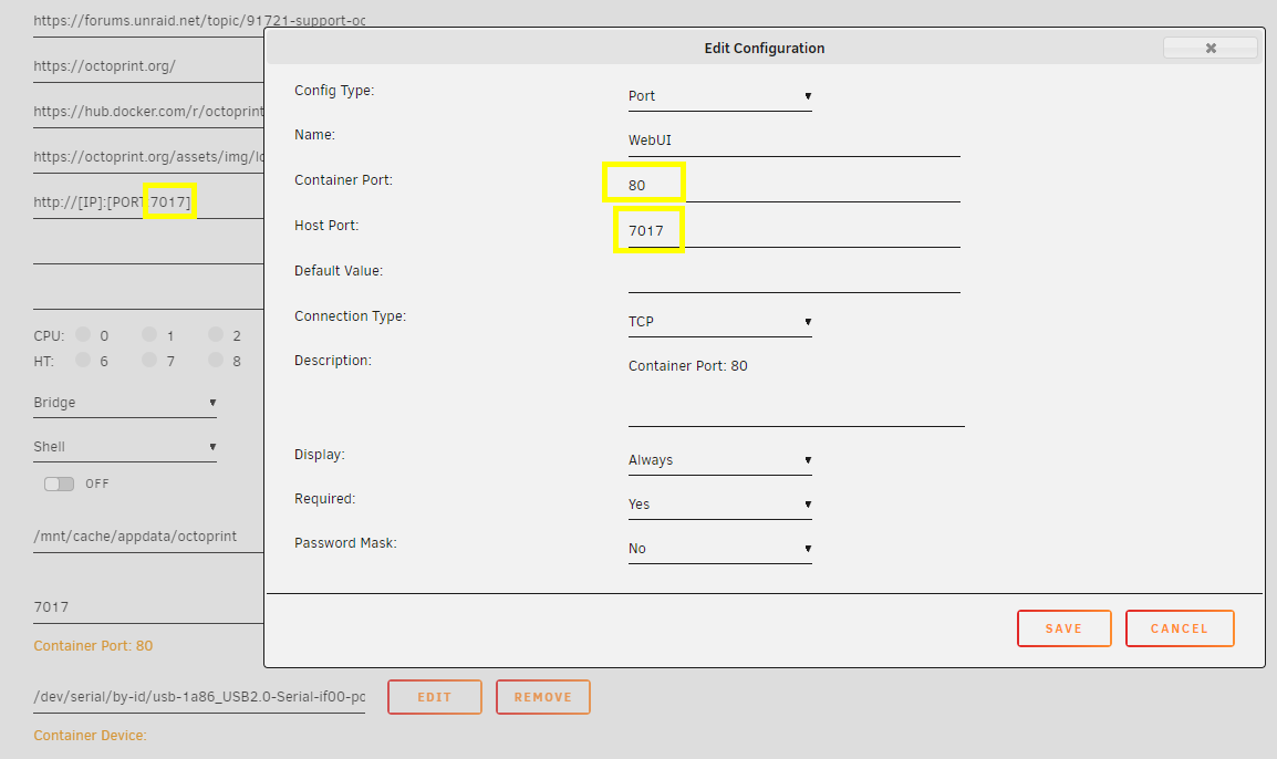

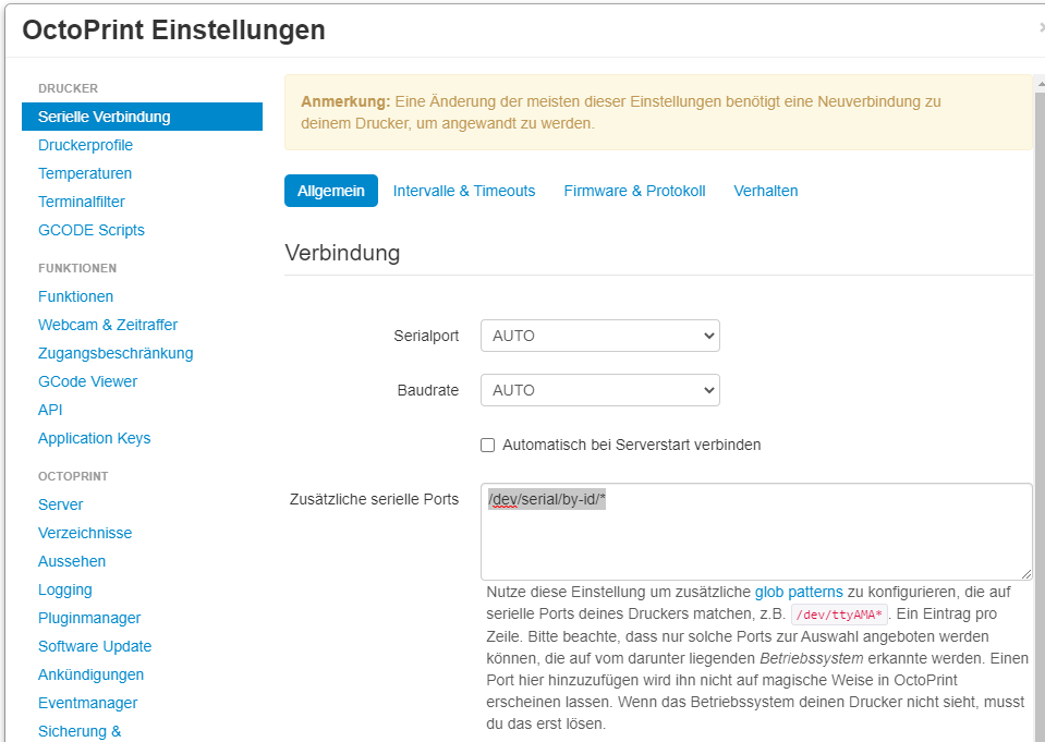

I found it out. You need to add "/dev/serial/by-id/*" to the Octoprint settings of the additional serial connection ports:
Is this available as Container Variable? Maybe it can be prefilled so the user does not need to add it.
PS I was really confused about the port settings. The container uses port 80 for the web-ui, while the template uses port 80 for the webcam?! As I don't have a webcam by now, I changed it as follows:

Anyone have any experience or tips for setting this up behind nginx.  Not really sure what I should do to make the webcam accessible remotely.
It seems as though every day this breaks for me - when I restart the docker after doing a backup, it moves all the keys around, resulting in the key for the USB ID of the printer being changed to the setting for camera, etc.
I don't have a camera plugged in and I have removed those entries to allow it to start - it works fine until it restarts and then it dies, so I have to reinstall it again.
Any workaround?
Any workaround?
If you use the "by-id" serial identification this won't happen as it uses the identity of the printer.  If you use ttyACM0 or ttyUSB1 methods, these can change
Thanks - I do use the By-Id method - the issue is that the template changes the key from printer port to camera port - so it thinks the camera should be my printer.
Had to wait for it to do a backup before I could show it.
It does this - I had previously removed the webcam device key, as well as ENABLE_MJPG_STREAMER, CAMERA_DEV, MJPG_STREAMER_INPUT, webcam, and snapshot. All I had was the printer USB port key - as you can see it's removed the printer USB port and replaced it with webcam device, which means the container doesn't start.
Now that I think about it - it could be because the printer is not powered on when it does a backup, so when it comes back the USB device does not exist, but I don't know why it would change the template.
I'll try creating an automation to turn the printer on during the backup window - however I have also tried setting community apps backup to ignore the octoprint folder, but it still happens. I've had plenty of containers where I've edited the templates and I've never had this happen.
