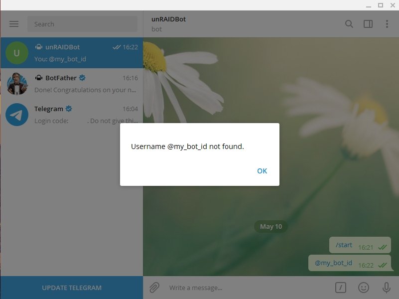

May 10, 20206 yr Author Thanks T0a Unfortunately the Get Channel ID method didn't work as it just revealed the @botname instead of an id. I've since tried to just delete this all and start again but now Telegram just seems all screwed up as I get "Username @my_bot_id not found" when I try to get the bot ID. Edited May 10, 20206 yr by Dal1980

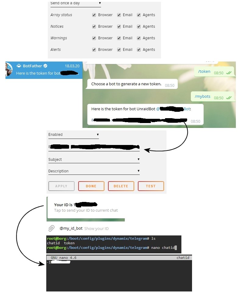

April 13, 20215 yr Hi, Looks like there is a missing step and a missing field in the Unraid UI in order to fully configure the Telegram agent. I think we need to put the telegram chatid somewhere. When you read the /boot/config/plugins/dynamix/notifications/agents/Telegram.sh script, you see that it references a /boot/config/plugins/dynamix/telegram/chatid file containing the chatid number. But in the Unraid telegram agent configuration UI, there is no chatid field (I'm using 6.9.2) In order for the Telegram agent to work, I had to create the file with my bot chatid: echo "MyChatIDnumber" > /boot/config/plugins/dynamix/telegram/chatid (Just replace MyChatIDnumber by your chat ID number including the minus (-) sign if any) Then clicked the test button in the Telegram agent configuration page and it worked. How to retrieve chatid : How to obtain Telegram chat_id for a specific user? - Stack Overflow How to retrieve token : https://core.telegram.org/bots#generating-an-authorization-token Edited April 13, 20215 yr by prune added link to chatid and token retrieval howto

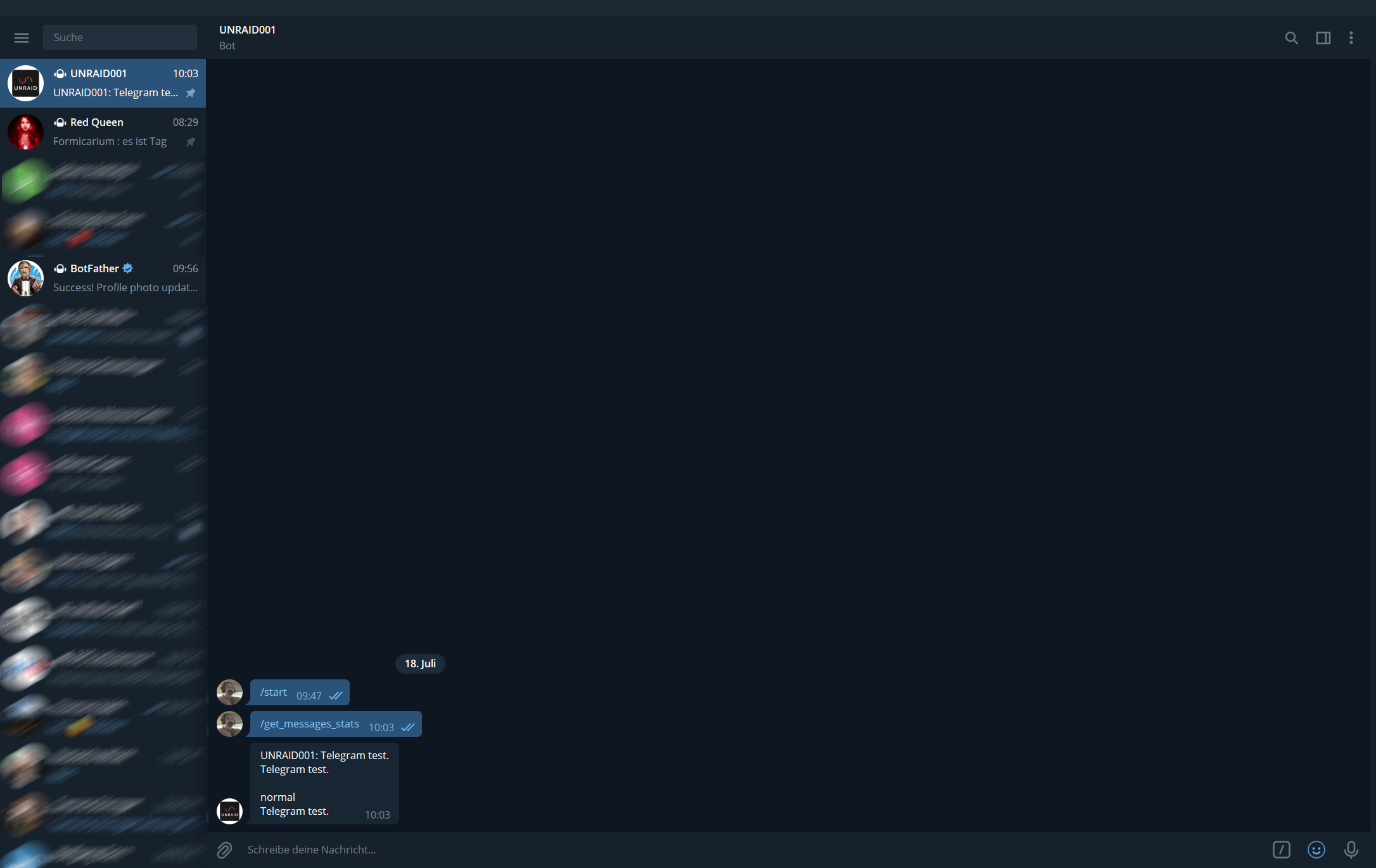

July 18, 20215 yr i have these problems on different telegrammbots i use... my solution that works for me is: after entering the chat in the telegramm client, i sent theses commands: 1.) /start 2.) /get_messages_stats after these two commands i receive the testmessage from unraid Edited July 18, 20215 yr by MadJoe74
May 27, 20224 yr On 4/14/2021 at 12:20 AM, prune said: Hi, Looks like there is a missing step and a missing field in the Unraid UI in order to fully configure the Telegram agent. I think we need to put the telegram chatid somewhere. When you read the /boot/config/plugins/dynamix/notifications/agents/Telegram.sh script, you see that it references a /boot/config/plugins/dynamix/telegram/chatid file containing the chatid number. But in the Unraid telegram agent configuration UI, there is no chatid field (I'm using 6.9.2) In order for the Telegram agent to work, I had to create the file with my bot chatid: echo "MyChatIDnumber" > /boot/config/plugins/dynamix/telegram/chatid (Just replace MyChatIDnumber by your chat ID number including the minus (-) sign if any) Then clicked the test button in the Telegram agent configuration page and it worked. How to retrieve chatid : How to obtain Telegram chat_id for a specific user? - Stack Overflow How to retrieve token : https://core.telegram.org/bots#generating-an-authorization-token This is the one. Wish I had seen this before Quote In order for the Telegram agent to work, I had to create the file with my bot chatid: echo "MyChatIDnumber" > /boot/config/plugins/dynamix/telegram/chatid (Just replace MyChatIDnumber by your chat ID number including the minus (-) sign if any)
June 2, 20224 yr On 4/14/2021 at 1:20 AM, prune said: Hi, Looks like there is a missing step and a missing field in the Unraid UI in order to fully configure the Telegram agent. I think we need to put the telegram chatid somewhere. When you read the /boot/config/plugins/dynamix/notifications/agents/Telegram.sh script, you see that it references a /boot/config/plugins/dynamix/telegram/chatid file containing the chatid number. But in the Unraid telegram agent configuration UI, there is no chatid field (I'm using 6.9.2) In order for the Telegram agent to work, I had to create the file with my bot chatid: echo "MyChatIDnumber" > /boot/config/plugins/dynamix/telegram/chatid (Just replace MyChatIDnumber by your chat ID number including the minus (-) sign if any) Then clicked the test button in the Telegram agent configuration page and it worked. How to retrieve chatid : How to obtain Telegram chat_id for a specific user? - Stack Overflow How to retrieve token : https://core.telegram.org/bots#generating-an-authorization-token Many thanks for this ! How Lime fix the problem ?

August 4, 20224 yr On 7/18/2021 at 9:41 AM, MadJoe74 said: i have these problems on different telegrammbots i use... my solution that works for me is: after entering the chat in the telegramm client, i sent theses commands: 1.) /start 2.) /get_messages_stats after these two commands i receive the testmessage from unraid Oh jeez, thank you for this! I was going to go through the whole chatid thing, but this worked absolutely fine. Thank you!
November 19, 20224 yr On 4/13/2021 at 4:20 PM, prune said: Hi, Looks like there is a missing step and a missing field in the Unraid UI in order to fully configure the Telegram agent. I think we need to put the telegram chatid somewhere. When you read the /boot/config/plugins/dynamix/notifications/agents/Telegram.sh script, you see that it references a /boot/config/plugins/dynamix/telegram/chatid file containing the chatid number. But in the Unraid telegram agent configuration UI, there is no chatid field (I'm using 6.9.2) In order for the Telegram agent to work, I had to create the file with my bot chatid: echo "MyChatIDnumber" > /boot/config/plugins/dynamix/telegram/chatid (Just replace MyChatIDnumber by your chat ID number including the minus (-) sign if any) Then clicked the test button in the Telegram agent configuration page and it worked. How to retrieve chatid : How to obtain Telegram chat_id for a specific user? - Stack Overflow How to retrieve token : https://core.telegram.org/bots#generating-an-authorization-token Genius thank you! It's Nov 2022 and this still is required.
January 21, 20233 yr Just wanted to share I ran into this same problem but adding the chatid manually did not make sense to me as the telegram.sh script has logic to grab the chatid automatically. What fixed the issue for me was running these two commands below on the Telegram bot itself and trying the TEST message again. I even removed the chatid file I had created manually and tried it again and the script populated the file. 1.) /start 2.) /get_messages_stats

July 19, 20242 yr On 4/13/2021 at 7:20 PM, prune said: Hi, Looks like there is a missing step and a missing field in the Unraid UI in order to fully configure the Telegram agent. I think we need to put the telegram chatid somewhere. When you read the /boot/config/plugins/dynamix/notifications/agents/Telegram.sh script, you see that it references a /boot/config/plugins/dynamix/telegram/chatid file containing the chatid number. But in the Unraid telegram agent configuration UI, there is no chatid field (I'm using 6.9.2) In order for the Telegram agent to work, I had to create the file with my bot chatid: echo "MyChatIDnumber" > /boot/config/plugins/dynamix/telegram/chatid (Just replace MyChatIDnumber by your chat ID number including the minus (-) sign if any) Then clicked the test button in the Telegram agent configuration page and it worked. How to retrieve chatid : How to obtain Telegram chat_id for a specific user? - Stack Overflow How to retrieve token : https://core.telegram.org/bots#generating-an-authorization-token I have done all of this, but the test notification is still not going into the chat. Im not sure what's missing, but its frustrating / annoying that UnRaid as NOT fixed this in the settings to simplify it after 4 years.
July 22, 20242 yr On 7/20/2024 at 6:16 AM, Kitra said: I have done all of this, but the test notification is still not going into the chat. Im not sure what's missing, but its frustrating / annoying that UnRaid as NOT fixed this in the settings to simplify it after 4 years. I completely agree with you. It seems the Unraid team is focusing on changes that confuse users. In version 6.12.10, which I’m currently using, the Telegram.sh script has been updated. There's no need to add a minus sign anymore. Simply enter the chat ID numbers in the /boot/config/plugins/dynamix/telegram/chatid file—no spaces, no minus sign, just the numbers. That’s all you need to do.

October 15, 20251 yr Can confirm that you need to add your chat id with echo "MyChatIDnumber" > /boot/config/plugins/dynamix/telegram/chatid. To get your own chat id, do the following (from here):Find UserInfoBot: Search for @userinfobot in Telegram.Start the Bot: Open the chat with @userinfobot and send the /start command.Retrieve Your CHAT_ID: The bot will respond with your chat ID, which is the unique identifier used by Telegram to direct messages to your chat.
