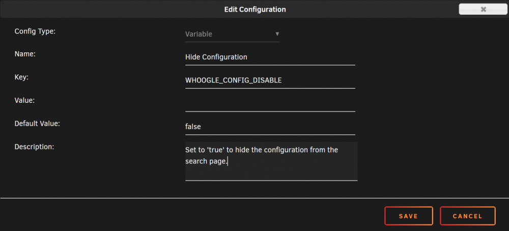

5 minutes ago, presence06 said:
No I haven't.. I had it facing the internet but have since just been using it locally now anyways. I cannot get the config to not show.
At some point I got it working and not sure what I exactly did.  But simply WHOOGLE_CONFIG_DISABLE set to 1 disables it.  I have nuked the container and tried multiple times and it works.  I know without a doubt I tried this before but dunno
thanks @jmztaylor for confiming what those types of values should be. I added that info to the main post.

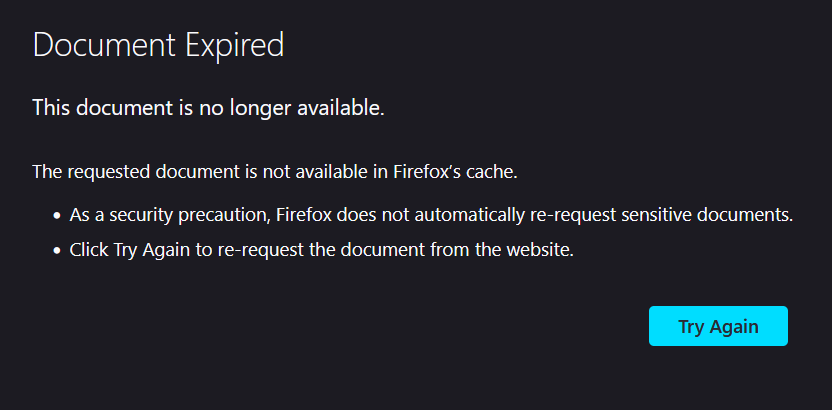

Ever since the latest docker update, when I follow a link from the search and then click Back in the browser to go back to the results I get the following:
It used to just go back to the search results. While Firefox is my main browser, the same thing happens in Chrome, Edge, and Brave. Any ideas on how to fix?

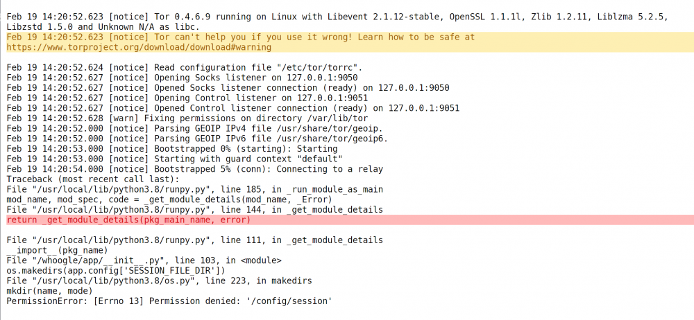

On 3/6/2022 at 11:21 AM, Squid said:
chmod 0777 -R /mnt/user/appdata/whoogle-search
Sorry for the newb question, but whoogle-search doesn't appear to be in my appdata directory. How do I find where it is installed?
