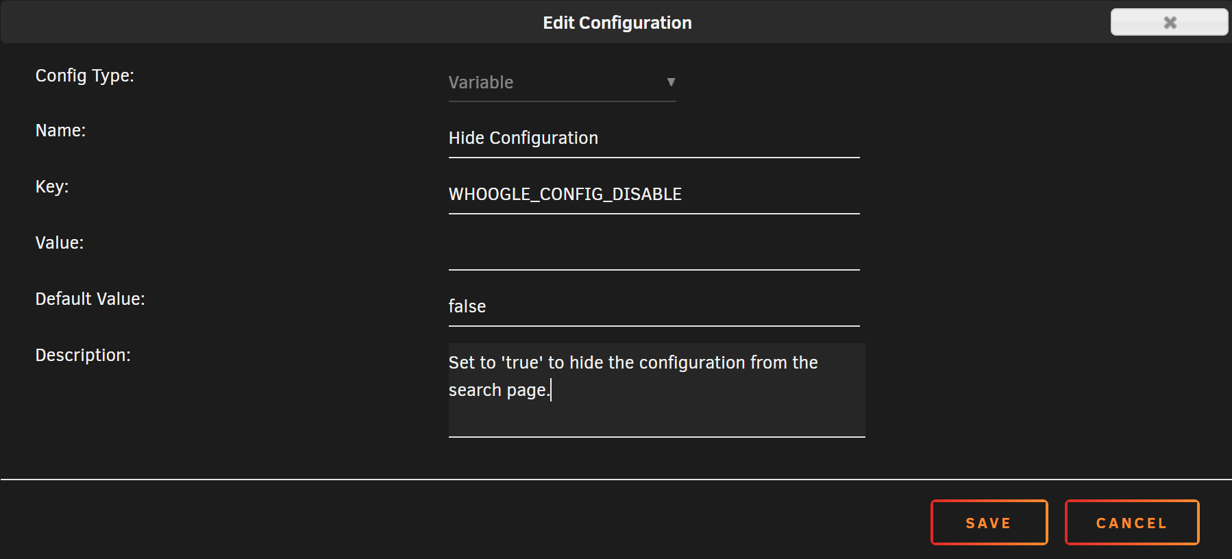

I'm really enjoying this docker but didn't want the configuration accessible in the event some random person stumbled on my subdomain. To hide it create a new variable. (See image attachment.) Then simply change the value to 'true'.
Is this variable working for you?  Once I add the variable, the config option goes away (great!) but when I change the value to false, the conifg is still not displayed.  I've added the variable like you did above, so curious if you're having the same issue I am. I can view the config if I remove the variable.
Interesting. I just assumed false would bring it back since it's pretty standard for false to be opposite of true in configs. It looks like you actually have to remove the setting all together. Sorry about that.
No worries, I thought the behavior was weird too.  This is still helpful once you get the config changed IMO.

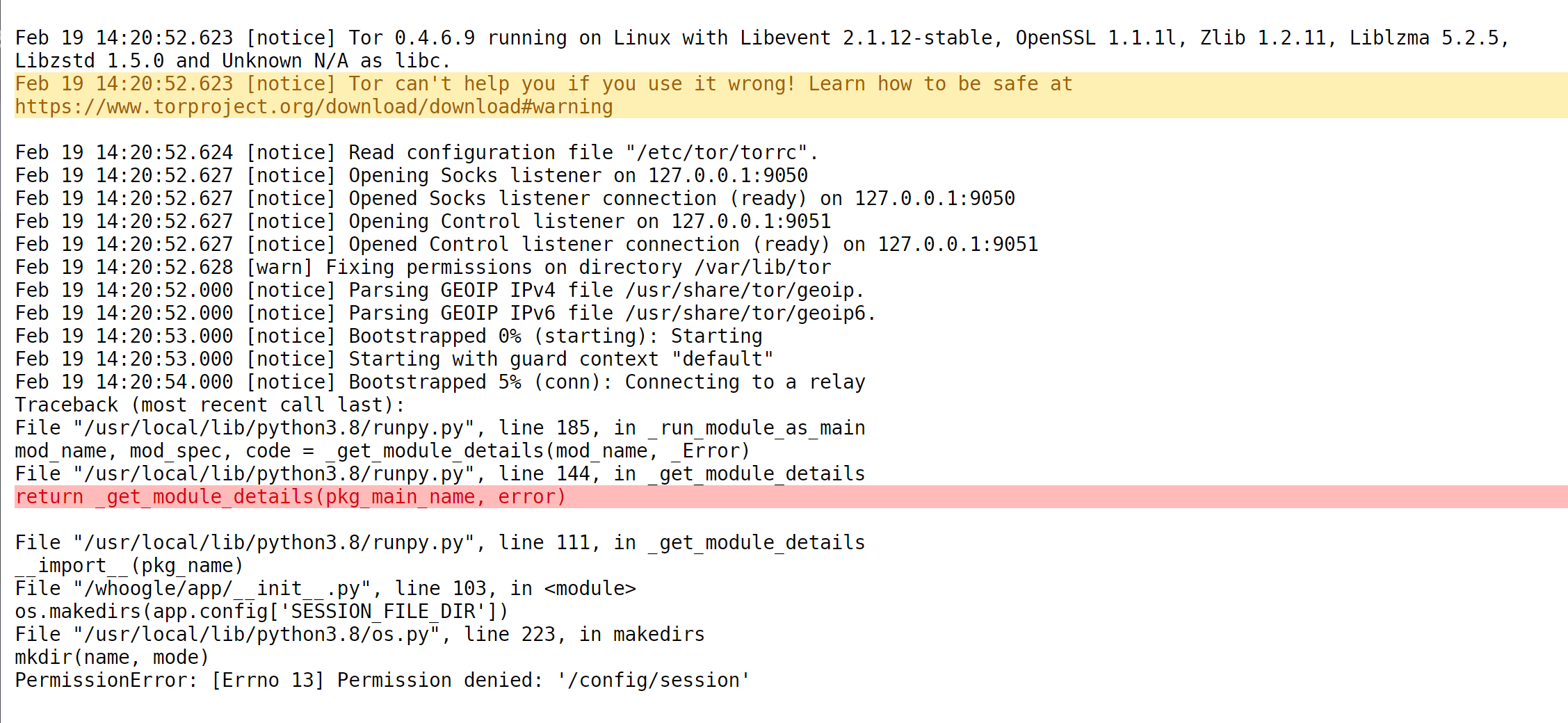

So, my Whoogle stopped working a couple months ago and I stopped using it so I could wait for a fix. Seems there is not fix as it is still broken. Any idea what's happening here? Is this an issue with me or is this Whoogle itself being broken?
The WebUI var does not seem to do anything as the container port is another var.
Also any way to disable Tor on the container? Be good to have that as a option.
chmod 0777 -R /mnt/user/appdata/whoogle-search
Thanks Squid! Fixed it right up. No idea why I keep forgetting with Linux it's usually a permissions thing. LOL
This doesn't seem to work anymore? I set it to true, go to my search page, the config is still there. I've blown away the container and appdata folder, reinstalled and set it to true, same thing.
EDIT- Tried setting to 1 instead.. still shows the config option.
I am seeing this same behavior.  Did you solve this?
