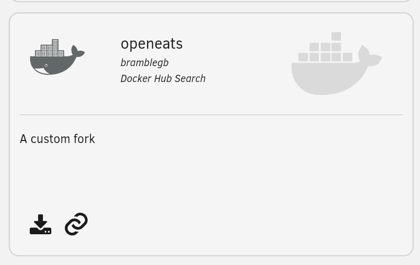

You cannot change the name, you have to download my container from Community Apps( see photo) and use the same settings.
You may need to delete the current one as having two containers with the same name can cause issues.

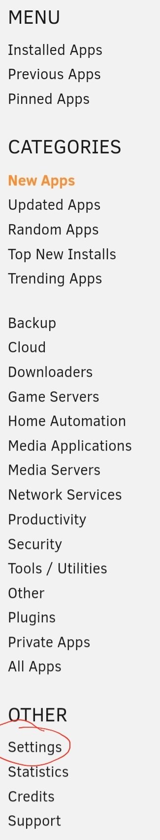

Du musst "Enable additional search results from dockerHub:" an machen, under Other-> Settings.
Und dann "Click Here To Get More Results From DockerHub" drücken wenn du nach openeats suchst.

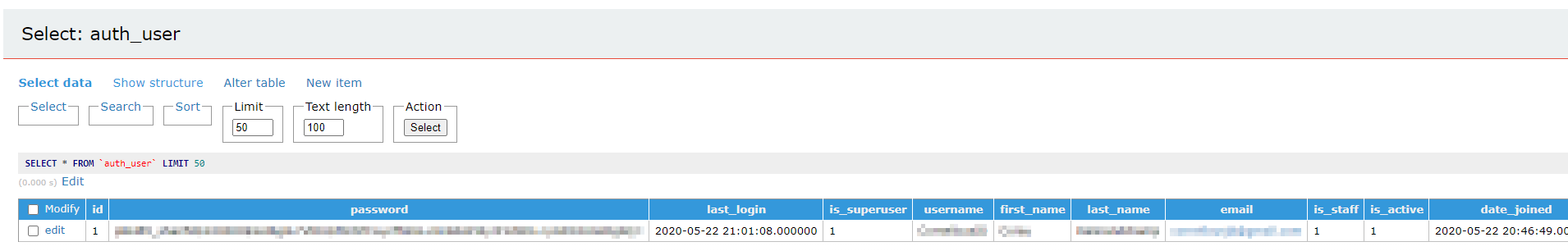

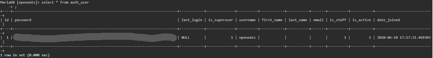

Your variables all look fine to me. If you drill down into your database anto the "auth_user" table do you see your admin user you selected in the container?
If you do not see it there, then you may want to try blowing away the database itself and the appdata folder for OpenEats and force an update on the container (this will re-pull it fresh) and fire it up again, and create the database with the user.
EDIT - This is what mine looks like - I'm the only user listed, and this username was my supseruser user/pass I put into the container as a variable.
Edited by CorneliousJD
I see the same thing when querying that table.
When you open the website, does it say you are already logged in?
Your username here shows "openeats" -- try login in with user and pass of openeats maybe?
It doesn't appear to have listened to your "admin" username you specified in the screenshot, the default it will make is openeats//openeats. Give that a go.

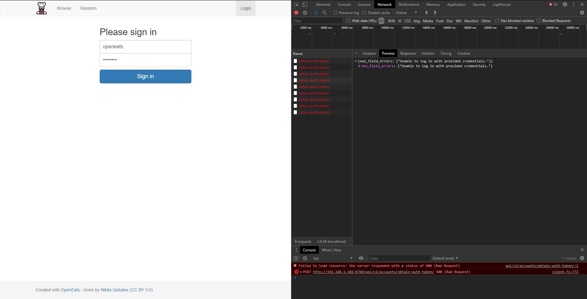

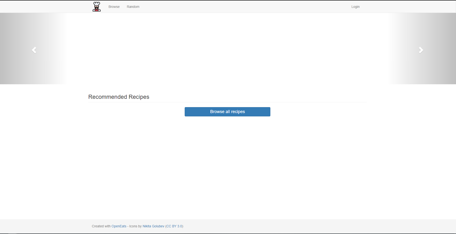

No. I'm given the option to login, which doesn't work.

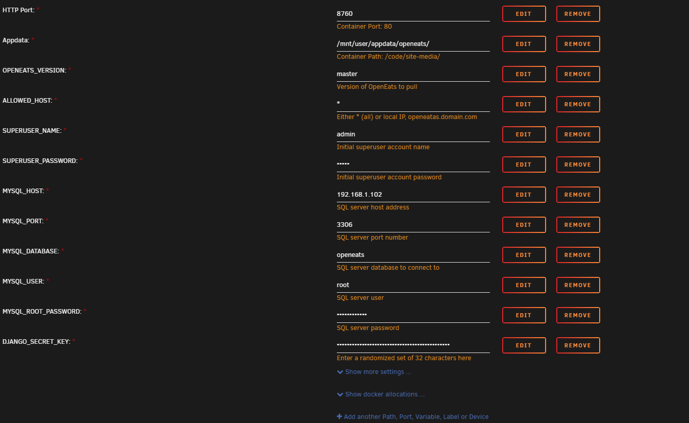

I blew up the openeats database, deleted the docker and appdata folder, and recreated everything from scratch. Still no dice on signing in.
Another issue I noticed as I was getting it set back up is that I cannot successfully connect to the db with an alternate user that I have set up for this. I have to use the root db user or django kicks me back an error that it can't connect.
I just noticed something in the logs. Anytime I attempt to login, I'm met with this line:
192.168.1.158 - - [10/Jun/2020:14:59:47 -0500] "POST /api/v1/accounts/obtain-auth-token/ HTTP/1.1" 400 68 "http://192.168.1.102:8760/login" "Mozilla/5.0 (Windows NT 10.0; Win64; x64) AppleWebKit/537.36 (KHTML, like Gecko) Chrome/83.0.4103.97 Safari/537.36" "-"
I highlighted the 400 for effect, and it indicates to me that there is an issue with the login. I see 200 codes in other places, like when navigating to the main page:
192.168.1.158 - - [10/Jun/2020:14:59:33 -0500] "GET /api/v1/recipe/mini-browse/?limit=4 HTTP/1.1" 200 52 "http://192.168.1.102:8760/" "Mozilla/5.0 (Windows NT 10.0; Win64; x64) AppleWebKit/537.36 (KHTML, like Gecko) Chrome/83.0.4103.97 Safari/537.36" "-"

I have mine setup using another user, make sure whatever user you setup has full permissions over that database in question.
Also see my previous reply, your select statement showed "openeats" as the user, NOT "admin" like your variable states, so that may have something to do with it, it doesn't seem to be actually writing your intended superuser user/pass.
If the select satement shows username of "openeats" again I'd try logging in with that for both user AND password.
If that doesn't work try "openeats" as the username with the password you actually specified.
If that doesn't work, I'd try again setting "openeats" as both the superuser username and password when setting up the container.

I've tried all of these suggestions, and the same outcome every time: no error message, and no login. Each time it logs with what I'm assuming is a 400 error code.
This is what I get when I use anything but the root user:
django.db.utils.OperationalError: (1045, "Access denied for user 'openeats'@'172.17.0.1' (using password: *******)")
My permissions for my openeats user is as follows:
At this point, I've nuked everything from orbit and started over about 5 times, with the same results every time. Either I'm overlooking a fundamental step, or something is royally broken somewhere that I can't seem to track down.

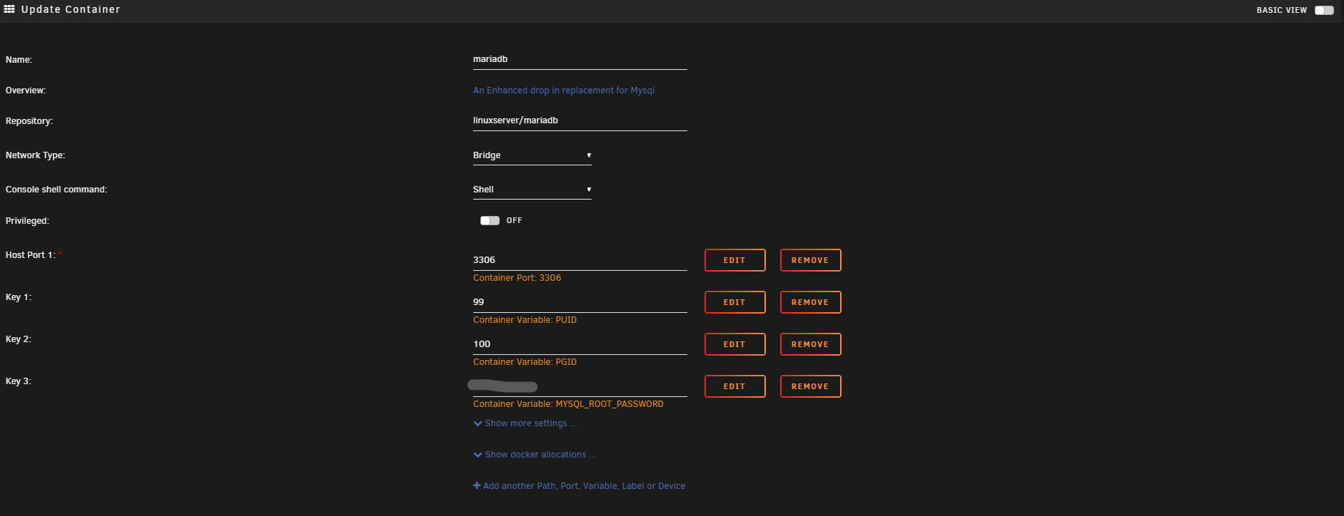

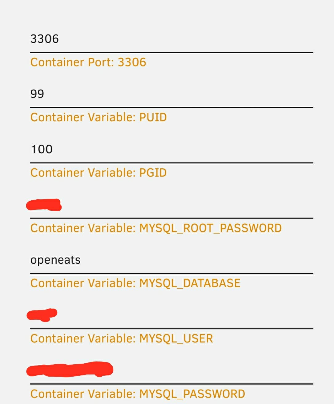

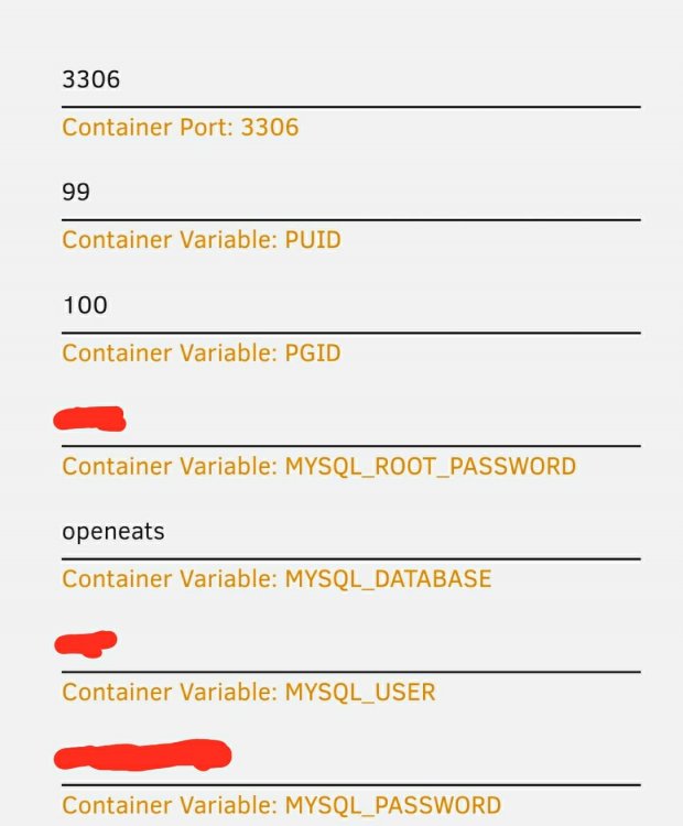

The last error is explainable because you only allow openeats@localhost but you are connecting from [email protected]
Can you share the settings that you are starting the mariadb container with?
image.thumb.png.cd052168069259631b636de958e9254b.pngHere is the docker settings page for mariadb.
Try adding these as well. And then using the added account in the openeats container settings
I've got my user working now. I had to modify the host connections in the database itself. I don't think the issue is on the mariadb side, as the tables have been created and the openeats docker starts up fine and seems to communicate with it. When debugging through the browser, I noticed that I AM getting a 400 error code that says "Unable to log in with provided credentials."
