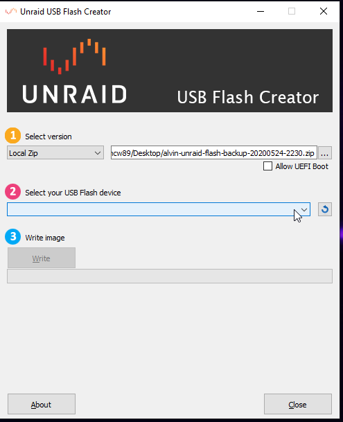

Hi is there anyone having issue with unraid USB FLASH CREATER? I'm creating a backup flashdrive for my current unraid server but the usb flash creater just doesn't seems to see it. Please help..
Sandisk ultra fit USB3.1 16GB

Have you tried the usb flash creator with a USB2 port? - yeah i fact i tried all the usb ports. no luck. i guess it's like i saw at another forum, UNRAID is just not supporting newer flashdrive.
