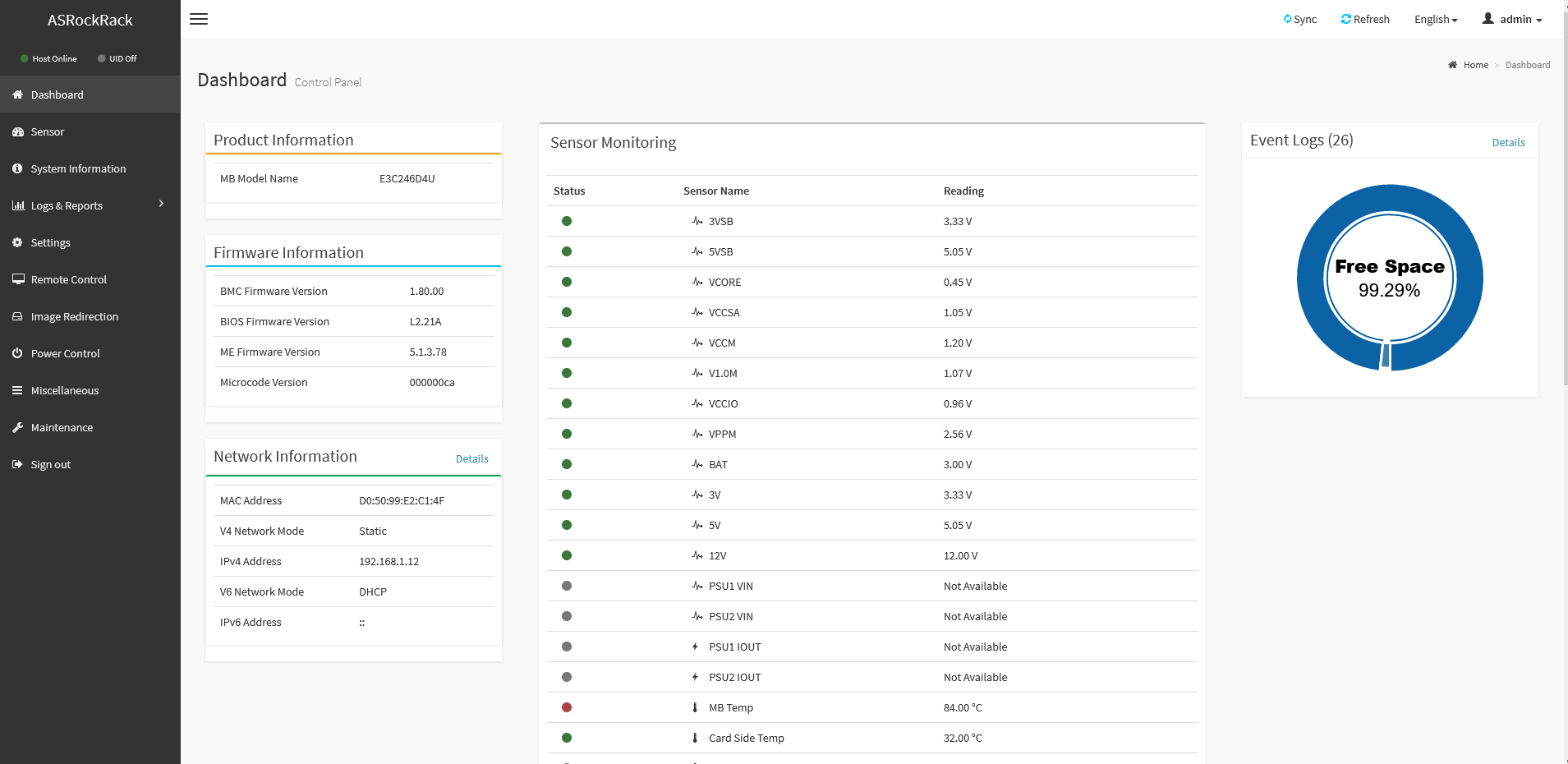

The latest versions of ASRock IPMI run as HTML5 in a browser.  Before that it was JAVA based (still an option), but the HTML5 is so much nicer.
Here's a screenshot:
One thing you need to be aware of is that you will likely need a special BIOS from ASRock to support the iGPU and IPMI/BMC. EDIT: no special BIOS needed on the E3C246D2I.
I have the mATX E3C246D4U motherboard and E-2288G CPU.  ASRock has provided several of us unRAID users with a special BIOS that allows the iGPU to be utilized for transcoding even though the board was designed for video output via the BMC only.  I am fairly certain they have a version of the BIOS for the E3C246D2I as well. (Not needed)
Through IMPI over the network you can power the server on and off, enter the BIOS, update the BIOS or BMC firmware, get server logs and temperature sensor readings, etc.
