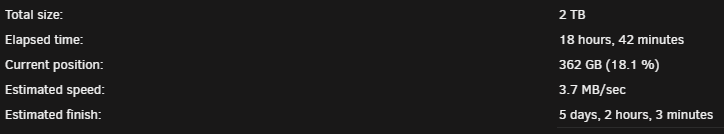

Within 20-30 mins though, the speed slows to a crawl and the estimated time goes from hours to days. I've tried stopping, rebooting, and kicking off the process again with the same results.
I've set the md_num_stripes tunable to 4096 based on a number of posts in the forum, doesn't seem to have made a difference. I've disabled everything I could find including docker, nothing should be taxing these drives at all apart from the parity build. I know the parity drives are not the best model, but could that explain such terrible performance?

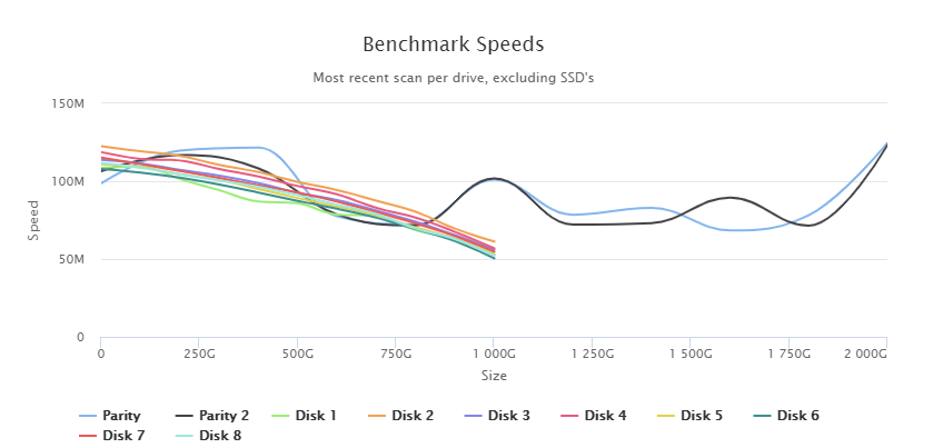

Nothing jumping out, though you're using a RAID controller and those are not recommended, they can sometimes have unpredictable performance issues, cancel/pause the sync and run a diskspeed test to check disks are performing normally.
Interesting results, the parity drives actually seem to perform better in some places, despite them being an inferior model.

On a second look the problem might be the parity disks, those disks are SMR, and while SMR generally work great with Unraid I remember havinbg very bad performance with those specific models, most SMR disks behave normally during sequential writes, not those, they slow down a lot as soon as they fill the small PMR cache and need to write to the SMR zone, even for sequential writes.
SMR would explain it. The parity runs fine while the drives are still using their pseudo-CMR buffer, then once they move to SMR tracks the performance falls off a cliff.
If it were me, I'd replace them, but it depends on your use-case. Those drive probably have 10-20GB worth of buffer on them, so if you can get off this initial massive write, and the rest of your writes to the array aren't going to be very big (less than the buffer size) then the performance won't be too bad. That said, as Johnnie points out, it will be unpredictable.

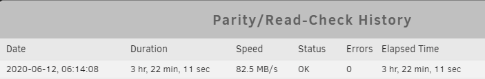

I realised that I had enough space to clear out one of the WD Reds, so I took it out of the array and made it parity.
Made a world of a difference, definitely a 'THAT'S more like it' moment.
Thanks everyone for your help here!
