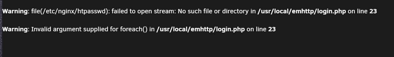

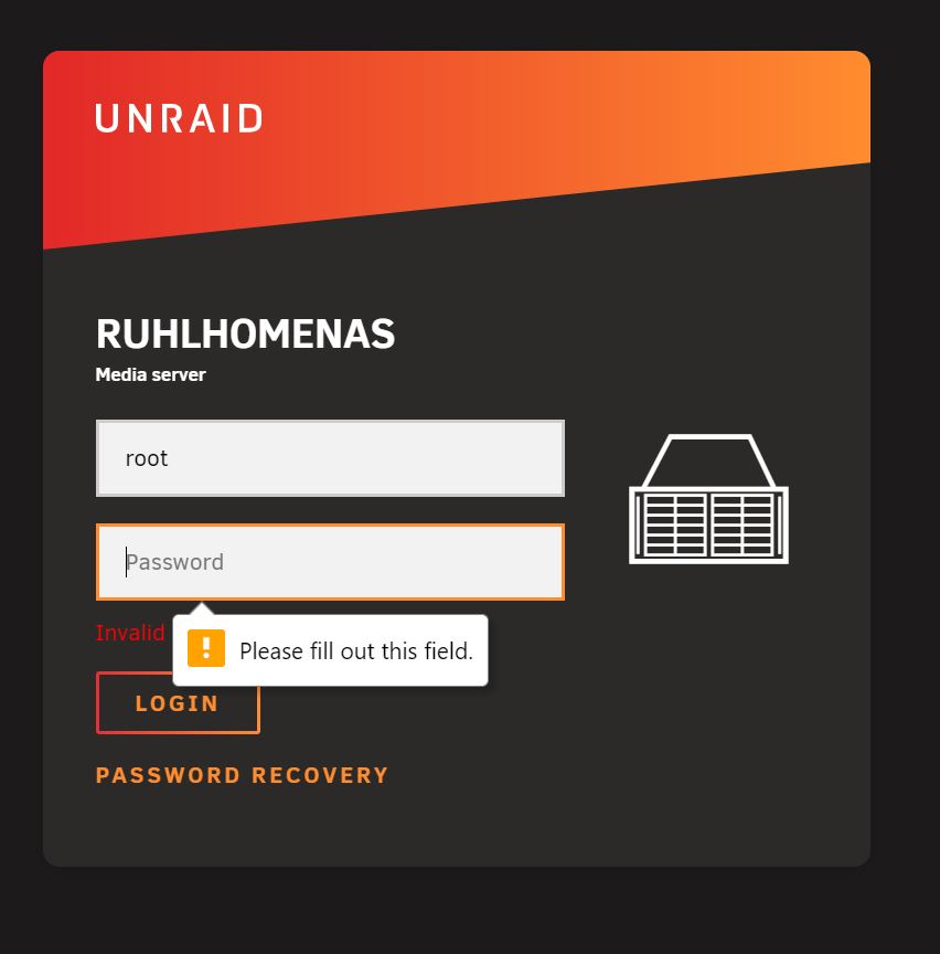

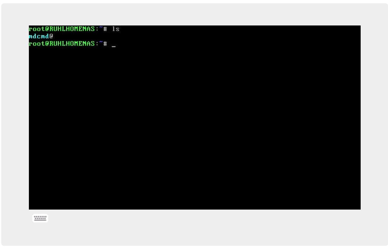

I AM NOT VERY HAPPY THAT IT WILL TAKE UP TO THREE DAYS TO GET A NEW KEY FOR A FAULTY USB DRIVE.
LOGIN PIC - 03 SHOWS THAT THE  iKVM HTML5 SHOW THAT IT DID LOGIN BUT I STILL COULD NOT FIX THE PROBLEM.
I TRIED TO FOLLOW INSTRUTIONS TO COPY FILE TO NEW USB.   A NEW REGISTRATION KEY IS REQUIRED.  NOW A WAIT FOR THREE DAYS ?

@Frank Ruhl
Please calm down on the caps, it's considered as shouting and thus rude.
Your reply here seems to be about two things. One is the timeframe for getting a replacement key manually. There is a system in place were you can replace a key yourself, but it has a one year cooldown between uses. You've made no mention of weather or not you've even attempted this. If you have, there are suggestions above for using a trial key, which did work for me until my key was replace by the UnRAID team.
The second thing seems to be some sort of issue? I recommend making a post in the general support forum. That is where you'd get support for problems, this is a feature request thread and isn't related to the problem.
