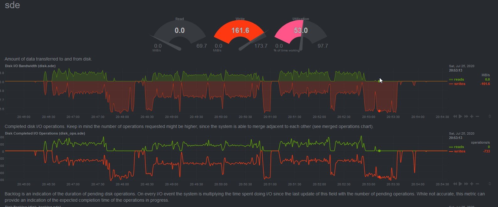

This is what I am seeing on both the drive I am writing to and the parity, they are exactly the same:
Notice that they go in spurts exactly as expected, full speed with writes only but then they will have equal parts read and write for long periods between??

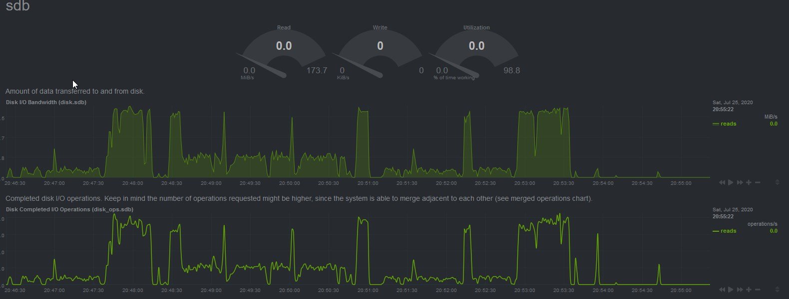

This is another drive in the array:
As you can see it matches the parity/destination drive reads with no writes, as expected.

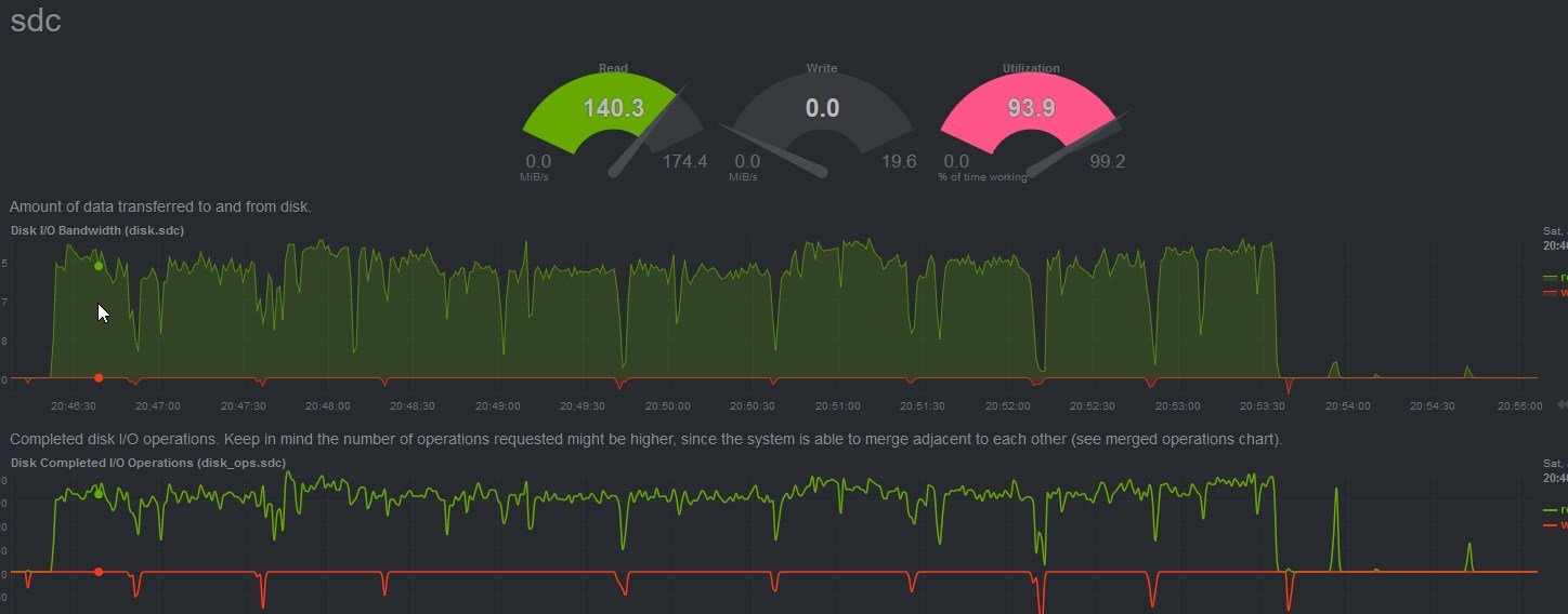

Here is another strange thing, the source drive is reading at full speed (~160mb/s) the whole time?
Anyone know what is going on? Why is anything being read on the parity or destination drive?

5 hours ago, TexasUnraid said:
I was under the impression that with turbo write, I would basically get full performance of the drives, they would all just need to be spun up and the parity would mirror any writes.
Currently, and against some users wishes, including my own, Unraid disables turbo write when i/o from multiple array disks is detected.

15 minutes ago, TexasUnraid said:
I am also curious why the parity drive is being read? Seems like it would only ever be written to unless it was rebuilding something? I can't think of a reason to read the parity besides a parity check or rebuild?
Any time you are not running in Turbo mode the parity drive is read as part of a write operation.  This section of the online documentation explains how the Unraid write modes work.
