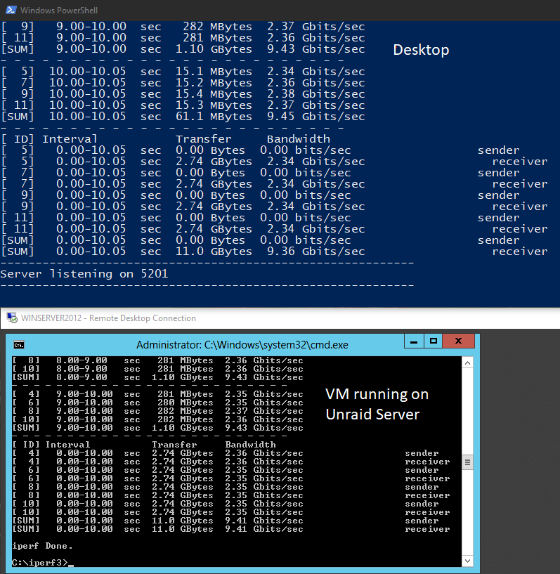

August 1, 20206 yr Author Forgot to mention... I get about the same speeds testing with a VM running on the server to the server's iperf3 server. So it's something local to the server itself. Edited August 1, 20206 yr by ryann
August 1, 20206 yr Author New experiement. I ran iperf3 on the VM running on the server. I get about 10GB throughput... so the hardware seems to work.
