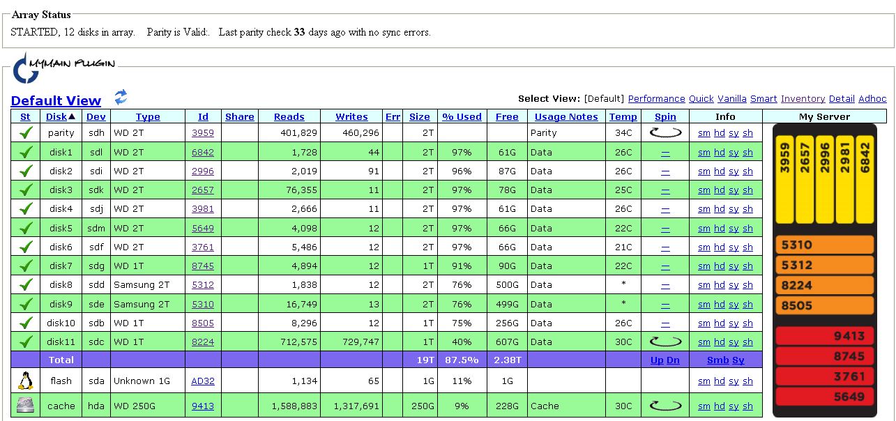

My buddy designed this image for me. What do you guys think?
That's cool.  I need to sharpen my Photoshop pencil...
It looks good, but disk4 (3981) is labeled 2981 in the 4th slot from the left on the top row in the image.
That appears to be my fat finger mistake. Thanks for noticing.
Only off by one....  ;D
