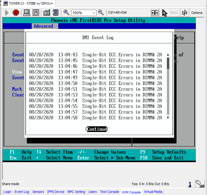

That was possibly a unrelated problem I was working on at the time of the initial reason for this post, the hardware error. I've looked in the main syslog and all I can find in there is this
LN# 2336 - Aug 12 02:26:22 Jarvlos kernel: EDAC MC1: 1 CE error on CPU#1Channel#0_DIMM#0 (channel:0 slot:0 page:0x0 offset:0x0 grain:8 syndrome:0x0)
And a couple or other entries after that but no mention of anything I know of to help that can read into, other than maybe one (or more) of my DIMM's might be on the way out.
Not super knowledgeable when it comes to ECC memory, so I would love to be wrong and this is just normal.
That looks like a correctable memory error, check the event log on the board BIOS, it might have more info and identify the slot, e.g., this is from one of my Supermicro boards:
