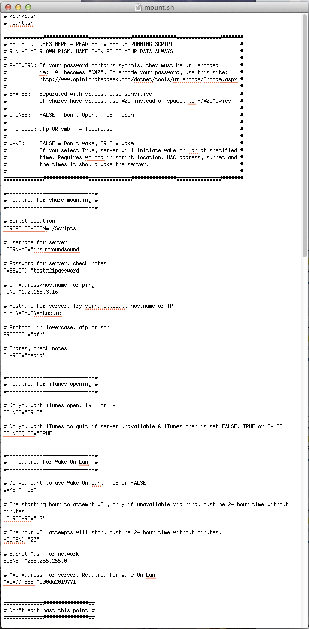

hi guys...i'm a newb...i've been trying to get this to work with no luck...
Here's what I have:
Mac Mini running Os X 10.7.3
Readynas Duo NV+ [my itunes library is in a share called "media" on this device]
Here's what I did:
1. Downloaded your file from post 1
2. Created a folder called "Scripts" and placed it in what I thought was my root folder [i clicked on the Macintosh HD icon on my desktop and placed folder inside there; I thought this was my root folder.  If it is not, please let me know how I can get there]
3. I placed the mount.sh script and wolcmd file in my newly created folder and updated according to your instructions. [i think]  I attached my textedit file just in case - passwords removed.  By the way, my true password contains an "!" so I substituted it with %21 in the script.  The URL encoding site you list does not give this as the special symbol for "!" but other URL encoding sites do.  Is this a problem?  It did not seem to work either way I did it - using a "!" or using the special code.

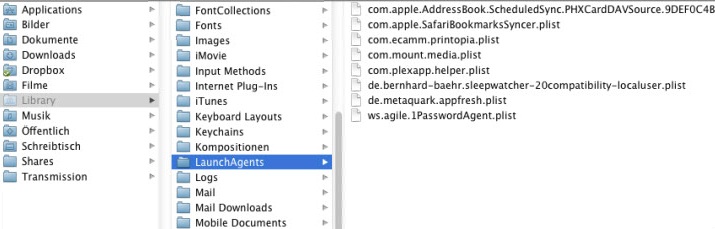

4. I placed the plist file in my user/library/launchagent directory [i turned on hidden files on my mac; I then clicked on the Macintosh HD icon; then the User folders; I then clicked on my username folder represented by the "house" icon; I then clicked on the hidden Library folder; I then clicked on the Launch Agents folder; and then I copied the file over]
5.  I then opened Terminal and copied the first line of text you said needed to go in there [minus the dash in front].  I was then prompted to enter my password, which I did.  I then copied the second line of text you said needed to go in there [minus the dash in front].
6.  I then restarted my computer, and unfortunately my NAS share called "media" did not automount.
You mentioned that if it didn't work to double-check permissions but I'm not sure where exactly you want this to be checked. [inside NAS?; mac mini; permissions to just the script file?]  As I mentioned before, I'm not a computer programmer or developer, but just trying to follow the instructions as listed.  I did navigate to my "Scripts" folder using Finder and clicked "Get Info"  I then changed all privileges for all names listed at the bottom of the window to "Read & Write".  I also did the same for the actual mount.sh file.  However, these changes did not seem to correct the problem.

When I typed "launchctl list" in the Terminal window, it returned a list of items and I did notice that it had a 1 in front of the plist file that I added. So, again, this brings me back to the possibility that I did not place the plist file in my root folder.  And I dont know how to get there.

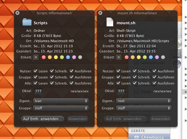

Hmm. Have you ever saved that file via text edit? Also check the permissions are ok on both the folder and the file. Your user must be set to execute. Just blanket chmod 777 the file to test.
Welcome to send me your script file and I'll check it out.

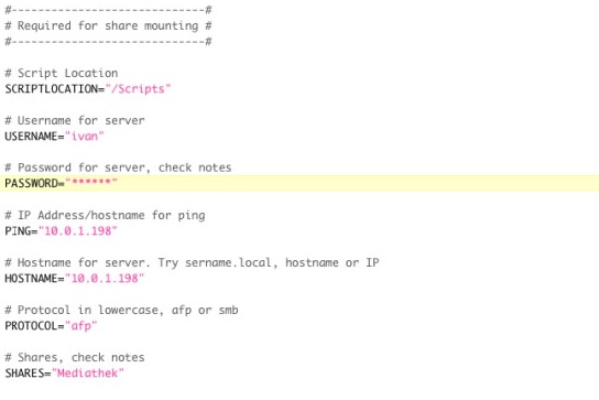

Hi!
I just checked the permissions of the folder and of the file both are set to 777...
Here's my mount.sh file:
http://dl.dropbox.com/u/5332371/mount.sh
It still doesn't work for me :(
Is this script running on other 10.7.3 machines?
I think this could be the problem:
https://discussions.apple.com/thread/3733712?start=0&tstart=0
This should be the solution:
I deleted it using xattr -d com.apple.quarantine script.sh and the script worked again.
Testing right now... Yup it works :D
