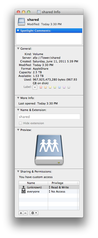

This is a great script and it is working well for me, with one small exception. I am running Lion with multiple users, and using fast user switching. I need for all of my users to have access to the shares once they are mounted and prefer that they all access the same mount point. My goal is to have a single user account setup the auto mount shares at login and for all other users to have access to it (775). Obviously, none would have access until the primary user logged in and auto mounted the shares.
The permissions for any shares created by this script is 700, and I can't seem to change it.  Any thoughts on how I could accomplish this? My config on the script posted below.
TIA for any help you can provide.

Output of ls -l on /Volumes
iMac:Volumes Erik$ ls -l
total 8
lrwxr-xr-x  1 root  admin    1 Sep 17 15:28 Macintosh HD -> /
drwx------@ 7 Erik  staff  264 Sep 17 15:30 Videos
drwx------@ 9 Erik  staff  264 Sep 17 15:30 shared
Also notice that in the Get Info window, owner is shown as 'unknown', see attached screenshot.
