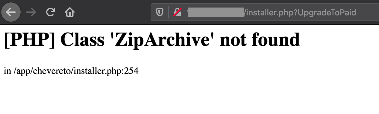

December 25, 20205 yr It was easy enough to get the container up and running but I get this error when I try to use the upgrade to premium feature in the webUI
December 25, 20205 yr On 10/1/2020 at 1:37 PM, hernandito said: Thanks.... that is where I saw the note about client_max_body_size potential solution... They also note other PHP configuration items. @hernandito you want to check the php-local.ini file located at /chevereto/php/ and make sure its got the sizes you want (restart the container for changes to take effect) After that, go into chevereto's webUI settings under image upload and change the limits there as well.
December 26, 20205 yr 5 hours ago, ClintWilkenson said: It was easy enough to get the container up and running but I get this error when I try to use the upgrade to premium feature in the webUI Dont use the linuxserver build. it has a glitch. use the nmtan/chevereto build. That will allow the upgrade.

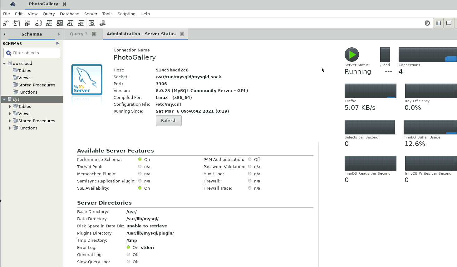

March 6, 20215 yr I am trying to set this up. I installed the MySQL docker image. MySQL says it's running. I went to the webui for cheverito to enter my info there and get the message "Can't connect to the target database. The server replied with this: SQLSTATE[HY000] [2054] The server requested authentication method unknown to the client Please fix your MySQL info." I don't know what info I need to fix? I installed the MySQL Workbench docker and I seem to be able to connect with that... So I don't know what I am doing wrong?

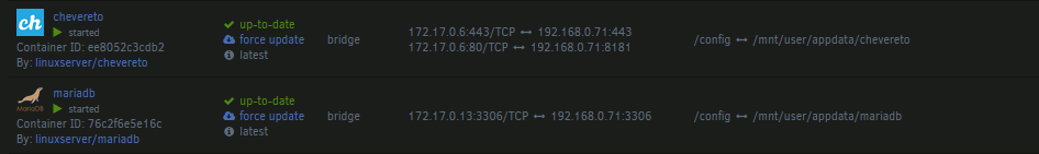

May 25, 20215 yr Running Chevereto on UNRAID utilising MariaDB. Any time i do a container update it looses my image mapping see below. I've restored mariaDB and cheverto from backup, looked at the config file cannot get the images\photos to show up. Edited May 26, 20215 yr by matda59

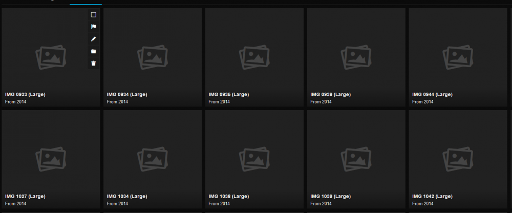

July 11, 20215 yr After a conainer update, the Chevereto only has links, but the links do not point to images. I see others have experience a similar issue. Any work arounds for this failure? Thanks, Robert Edited July 12, 20215 yr by rshuler

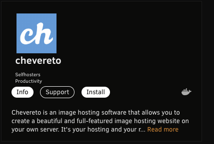

February 27, 20242 yr Hello, I'm the author of Chevereto. I think that I can help with some context. Hope is the right place to do so. The software used here is "Chevereto-Free" which I stopped maintaining and then it got removed from Unraid. On 2022-12-01 I released Chevereto free edition, which is well maintained and it gets constant new features. This new edition is available here: https://github.com/chevereto/chevereto Container images are available here: https://hub.docker.com/r/chevereto/chevereto Can Chevereto be added again?
February 28, 20242 yr 3 hours ago, rodber said: Hello, I'm the author of Chevereto. I think that I can help with some context. Hope is the right place to do so. The software used here is "Chevereto-Free" which I stopped maintaining and then it got removed from Unraid. On 2022-12-01 I released Chevereto free edition, which is well maintained and it gets constant new features. This new edition is available here: https://github.com/chevereto/chevereto Container images are available here: https://hub.docker.com/r/chevereto/chevereto Can Chevereto be added again? The SelfHosters guys still publish a Chevereto free which installs https://hub.docker.com/r/nmtan/chevereto Your best bet would be to talk to @Roxedus over on their discord https://discord.com/invite/qWPbc8R and get them to switch the repository or add a new template for Unraid
February 28, 20242 yr Yes, and they make the same mistake (use label "Chevereto" for something that's called "Chevereto-free" which I don't know why it happened. Besides the label issue, the main problem is that users are being exposed to code old as 2020. I keep updating the software but users ignore it as the label issue and everywhere reads "deprecated". This: https://github.com/rodber/chevereto-free/releases/tag/1.6.2 Is forked from here: https://releases.chevereto.com/3.X/3.16/3.16.2.html
