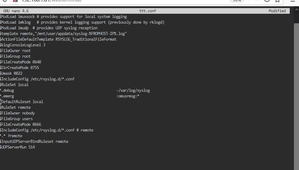

Also, can you share your /etc/rsyslog.conf ?

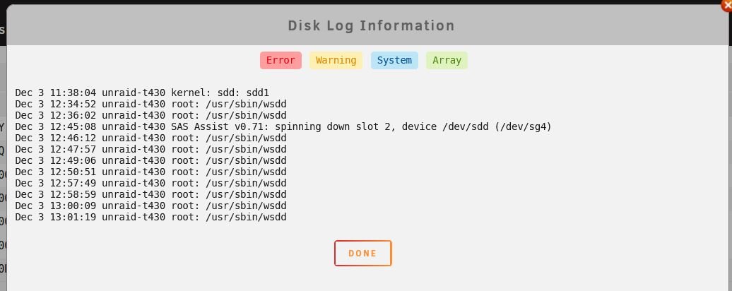

Sure,
I made some changes since I sent the forum post So hopefully the logs aren't to confusing.
When I had .6 installed I could see the drive standby also by the drive ready light going out. That no longer occurs.  Parity drives are set to never standby as they don't seem to work correctly being netapp drives. IE no grey ball and lots of logs trying over and over to spin down. 0 and 29 I think.
All others but cache are set to 1 hour. They do change to grey ball but no power savings via supermicro power consumption display. Drive ready light also stays lit on supermicro.
Thanks for your relentless pursuit to save watts!
syslog.txt

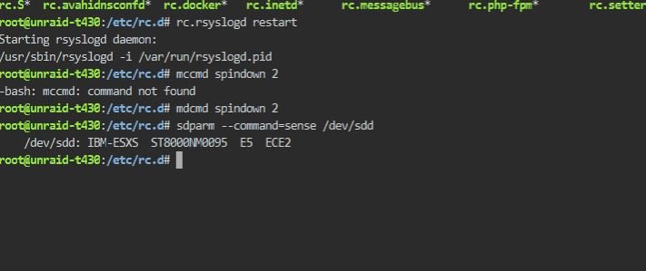

@nlcjr, can you restart your rsyslog service, then spindown one drive just once, then read sense with sdparm?
e.g.:
/etc/rc.d/rc.rsyslogd restart
mdcmd spindown 2
(wait a couple of seconds, then...)
sdparm --command=sense /dev/sdd
Edited by doron
e.g.:
mdcmd spindown 2
Here are the results.
(sorry for previous misfire, I was reading on a tiny phone)
Does this same drive react the same way to direct spindown? e.g.:
sg_start -r --pc=3 /dev/sdd

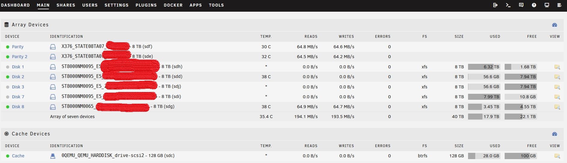

So D, you got me digging deeper. I found on those drives IDLE_B=1, IDLE_C=1, and IDLE=1. So I changed those to zero.
These drives are already sleeping according to Unraid, Grey Ball. Checked with SDPARM they show no additional lines as before. When I issue the commands sg_start and mdcmd they both work when checked with sdparm, also the light goes out on the supermicro drive bay. With in a few minutes the drive spins back up  and the supermicro light comes back on. But they are still Grey Balled and sleeping in Unraid.
Maybe the Cache directory's is not working properly. I do not see any activity on the read /writes.
