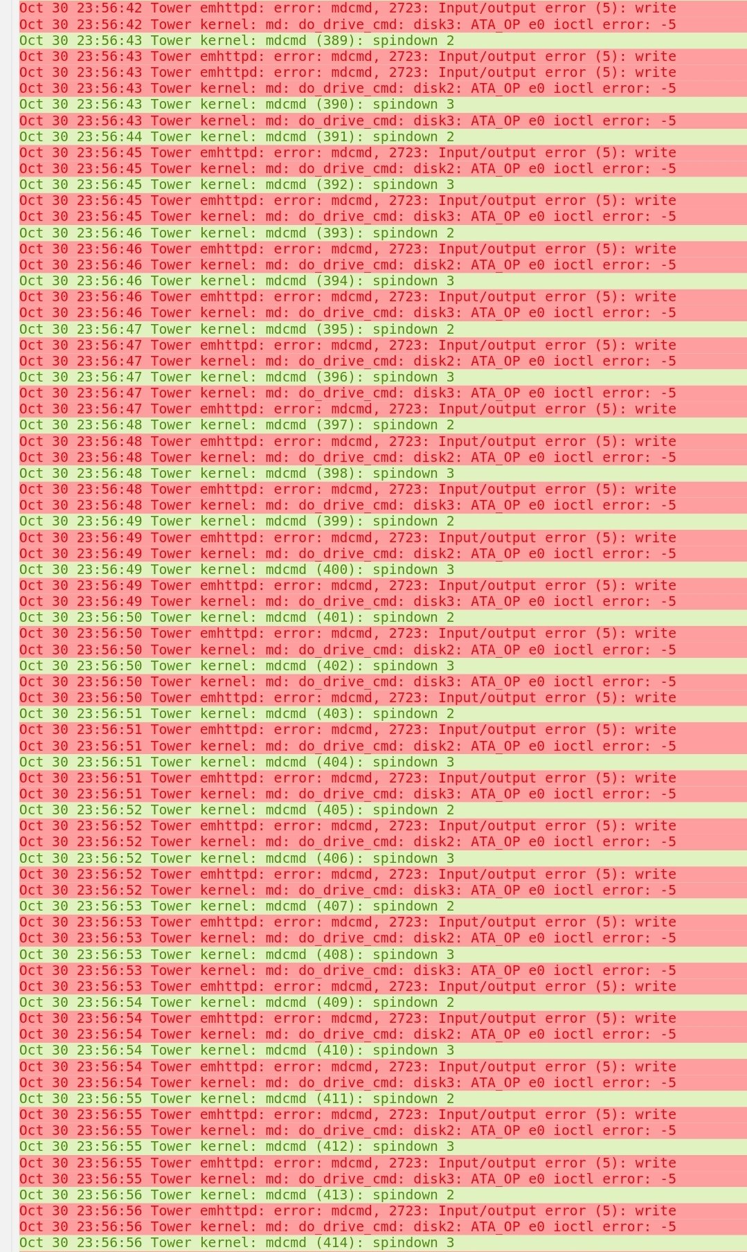

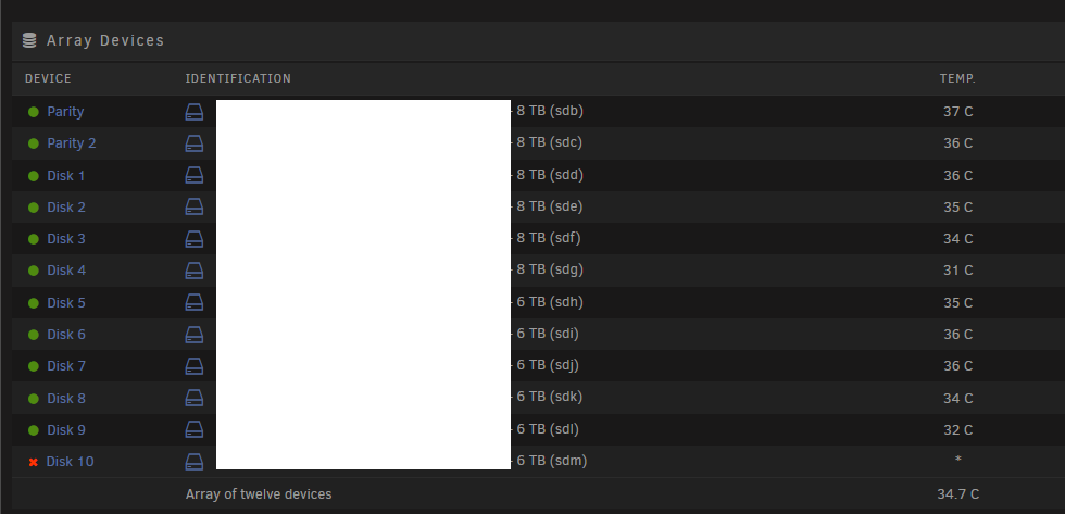

cannot restart and will not restart even on reboot of server
2020-10-30 09:34Unraid Disk 10 errorAlert [123456] - Disk 10 in error state (disk dsbl) (sdm)alert
will no come back online
Edited by Titus
For me not working as well. Instaled the plug-in under CA app.  Green signal on, error on log and drive does not spun down. Also, when put automatic spun down, i got spammed in log.
Model: HUS723030ALS640_YVJR6J5K
Edited by odirneto
When a drive is marked disabled in the array (gets the red x), it will not come back up automatically. It needs to be rebuilt; there are a few guides as to how to do that. However the drive is not physically disabled - it is probably in good shape - just needs to be reintroduced into the array and rebuilt.

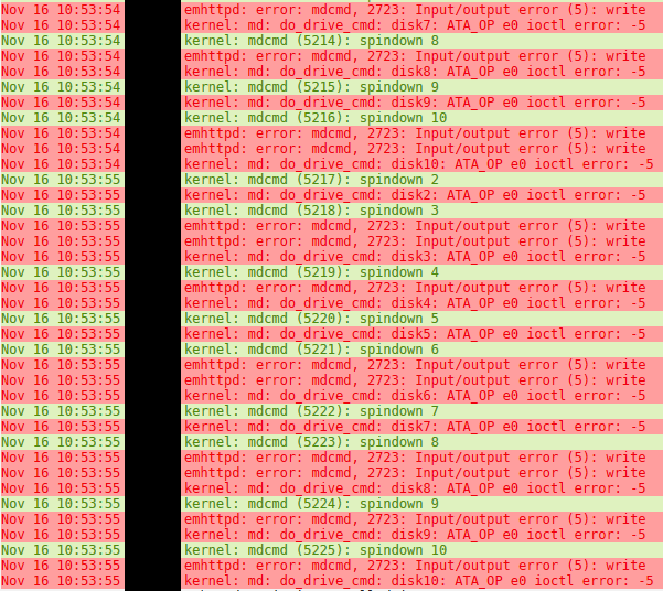

Can you share a sample of the spam you received in the log?

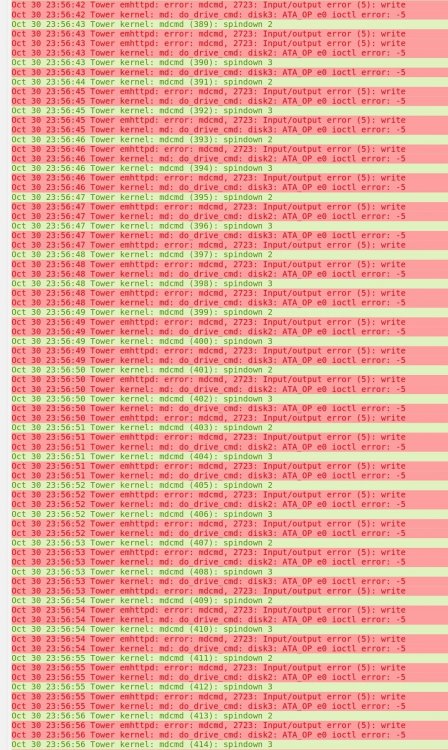

Is the same mensage from tryng to spun down, but a lot of times in a row
This is weird - unless this reflects your pushing the green buttons for disk 2 and 3 repeatedly several times in quick succession. Is this what happens?
BTW these messages are generated due to Unraid trying ATA spindown commands against a SAS drives.
The next version of the plugin (I've been sitting on it for a while, hoping to collect more data on drive/controller combos with which there's failures) filters these messages out from your log.

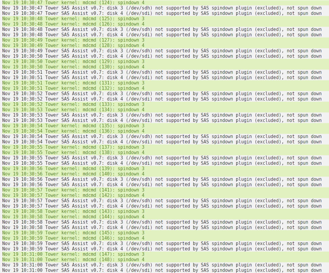

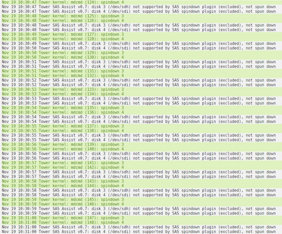

Really good work @doron! Just tried the commands against my SAS drives after upgrading firmware of the SAS controller. But "sg_start  --readonly --pc=3 /dev/sgX" disables the drive, and i need a reboot to get it back.
However, the plugin loops the "drive not supported" messages see below.
Nov 18 20:13:45 Tower kernel: mdcmd (931): spindown 3
Nov 18 20:13:45 Tower kernel: mdcmd (932): spindown 4
Nov 18 20:13:45 Tower SAS Assist v0.7: disk 3 (/dev/sdh) not supported by SAS spindown plugin (excluded), not spun down
Nov 18 20:13:46 Tower SAS Assist v0.7: disk 4 (/dev/sdi) not supported by SAS spindown plugin (excluded), not spun down
Nov 18 20:13:46 Tower kernel: mdcmd (933): spindown 3
Nov 18 20:13:46 Tower kernel: mdcmd (934): spindown 4
Nov 18 20:13:47 Tower SAS Assist v0.7: disk 3 (/dev/sdh) not supported by SAS spindown plugin (excluded), not spun down
Nov 18 20:13:47 Tower SAS Assist v0.7: disk 4 (/dev/sdi) not supported by SAS spindown plugin (excluded), not spun down
Nov 18 20:13:47 Tower kernel: mdcmd (935): spindown 3
Nov 18 20:13:48 Tower kernel: mdcmd (936): spindown 4
Nov 18 20:13:48 Tower SAS Assist v0.7: disk 3 (/dev/sdh) not supported by SAS spindown plugin (excluded), not spun down
Nov 18 20:13:48 Tower SAS Assist v0.7: disk 4 (/dev/sdi) not supported by SAS spindown plugin (excluded), not spun down
Okay that's actually a feature. Since your drives clearly can't be spun down properly, the plugin avoids them (they are on the exclude list). If it can't help, at least it avoids collateral damage...
Now, when you say "loops" - is there actually an endless loop of "spindown 3" - "spindown 4" - "spindown 3" - "spindown 4" or is this a result of your hitting the green button a few times in a row?
Actually, if all your SAS drives are on the exclude list, there's unfortunately little point for you to run this plugin at this time 😞
Edited by doron
Yes I understand that the message should display, when timer reaches for example 15min. Or hitting spin down button.
I did not push the button at all, just waited 15min, and the message loops every second. I could have provided a really long list with same messages.
Yes I know, just wanted to give it a go with the latest FW, but unfortunately it didn't work. Nevertheless it's a great project!

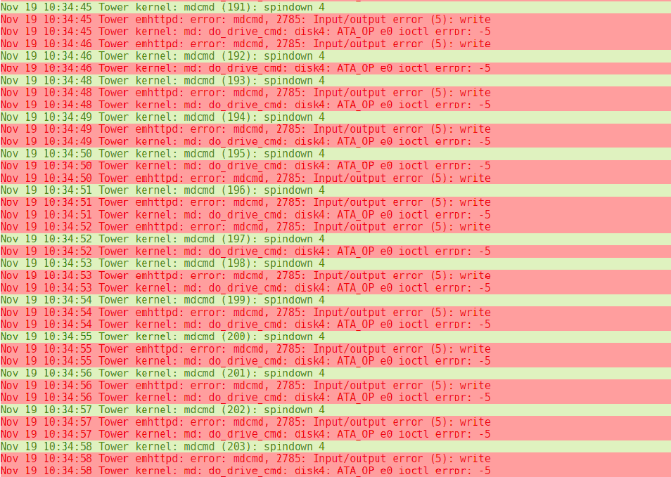

So this happens with the plugin installed; and when you remove the plugin - those "spindown 3"/"spindown 4" messages do not appear (or at least not in quick succession)?!
If so, this is puzzling and I would like to try to get to the bottom of it.
EDIT: I seem to be unable to reproduce it, and also can't see right now how the plugin will cause repeated "mdcmd spindown" to happen.
Edited by doron
I get the errors instead if i remove the plugin, so its more of an unraid thing, it tries to spin down the drive again and again... Not a problem for me as i have the disks to never spin down now.
Thanks for confirming.
(still a weird thing that I have never seen elsewhere but...)

I looks at entries in /dev/disk/by-id which correspond to the device name.  Each entry has a prefix, e.g., "ata-" or "nvme-", etc.  For SAS it should be "scsi-".  That prefix, with trailing '-' removed, is <transport>.
Thanks. I can work with that.
Note btw that in this schema, all SAS drives will be "scsi" but not all "scsi" will be SAS.
The only dependable way I found to pinpoint a SAS drive is via smartctl -i, parsing out "Transport protocol" - a field which is returned only for SAS drives (an example pasted below). Found nothing similar in neither /sys nor /dev .
I'll use that as a filter in the script, ergo "can work with that".
