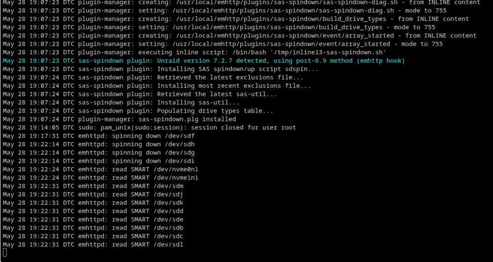

So I'm not sure if this is a problem that others are hitting, but I have noticed that since 7.3.0 this plugin seems to have stopped working. In fairness I only have a single SAS drive in my array but even clicking the spin down icon will just spin the icon for a minute and the drive never spins down. The logs do say "SAS Assist v2024.11.25: Spinning down device /dev/sda" but it never seems to actually spin down.
Might be a bug, might be my specific setup I'm not sure. The plugin did seem to work with 7.2.x though.
EDIT TO ADD: I did a bit of troubleshooting when I had a moment. It appears that all the "normal" SAS spindown commands like sdparm just don't work on that disk. Not sure what has changed... might be something at the kernel level. Probably not something you can fix unfortunately and it might be my controller... maybe a driver issue? Who knows?

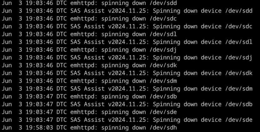

ive stumbled upon this plugin while trying to force my SAS drives to sleep, but they seems to be insomniac.
They are WD Ultrastars connected to LSI SAS 9300-16i with an IT firmware floating around the unraid forums.
4 other SATA drives on the same LSI card will sleep.
Unraid wont even try to attemp sending the command to them, which I dont understand.
It will send the wake up command, just like to the NVME caches, but no sleeps.
What could I try before we add them to no sleepy list?
Thanks
Edit:
After investigating mDNS caused by Home Asistant docker, I have left that docker offline
And the SAS drives spun down. I am confused why, as that docker does not have access to Array, but also Glad that after a year ive finaly managed to make them spin down ;D
Edited by Horrigan49

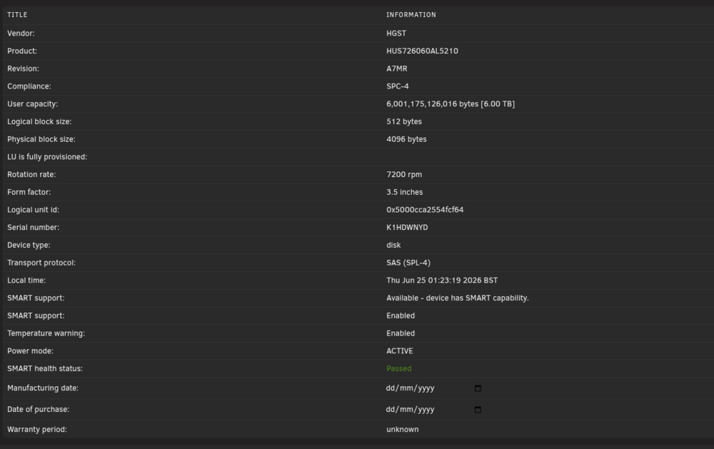

I have a SAS HUS726060AL5210 using the spin down it works. It spins up fine when I am using it and then spins down nicely but sometimes during some spin up's I get errors on unraid for that drive. Its some what random. If i try to reproduce the error I cant seem to by spinning it down and using something to spin it back up. E.g. Network Share/Plex/Manual all seems to work. Only thing I can see if it try's to run a smart test on the drive whilst its not spinning but some times its fine. Not 100% sure
Edited by Funmonkey100

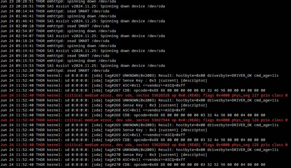

I am experiencing a similar issue to that the above poster. I have an unraid server I've had for a while that I've swapped the SAS card and drives at the same time. After doing some troubleshooting (replacing cables, repalcing the SAS card, changing spin up time outs on the card and upgrading the firmware) I am now getting the following error messages in the unraid log files:
Jun 25 09:06:35 Tower kernel: sd 0:0:2:0: [sdb] tag#3806 UNKNOWN(0x2003) Result: hostbyte=0x00 driverbyte=DRIVER_OK cmd_age=0s
Jun 25 09:06:35 Tower kernel: sd 0:0:2:0: [sdb] tag#3806 Sense Key : 0x2 [current] [descriptor]
Jun 25 09:06:35 Tower kernel: sd 0:0:2:0: [sdb] tag#3806 ASC=0x4 ASCQ=0x1c
Jun 25 09:06:35 Tower kernel: sd 0:0:2:0: [sdb] tag#3806 CDB: opcode=0x88 88 00 00 00 00 03 80 0f 17 00 00 00 00 08 00 00
Jun 25 09:06:35 Tower kernel: I/O error, dev sdb, sector 15033374464 op 0x0:(READ) flags 0x0 phys_seg 1 prio class 0
Jun 25 09:06:35 Tower kernel: md: disk1 read error, sector=15033374400
Jun 25 09:06:35 Tower kernel: sd 0:0:3:0: [sdd] tag#3808 UNKNOWN(0x2003) Result: hostbyte=0x00 driverbyte=DRIVER_OK cmd_age=0s
Jun 25 09:06:35 Tower kernel: sd 0:0:3:0: [sdd] tag#3808 Sense Key : 0x2 [current] [descriptor]
Jun 25 09:06:35 Tower kernel: sd 0:0:3:0: [sdd] tag#3808 ASC=0x4 ASCQ=0x1c
Jun 25 09:06:35 Tower kernel: sd 0:0:3:0: [sdd] tag#3808 CDB: opcode=0x88 88 00 00 00 00 03 80 0f 17 00 00 00 00 08 00 00
Jun 25 09:06:35 Tower kernel: I/O error, dev sdd, sector 15033374464 op 0x0:(READ) flags 0x0 phys_seg 1 prio class 0
Jun 25 09:06:35 Tower kernel: md: disk4 read error, sector=15033374400
Jun 25 09:06:36 Tower emhttpd: read SMART /dev/sdd
Jun 25 09:06:36 Tower emhttpd: read SMART /dev/sdb
Jun 25 09:06:36 Tower emhttpd: read SMART /dev/sdf
Jun 25 09:06:36 Tower emhttpd: read SMART /dev/sdc
The array works perfectly if i don't spin the disks down and starts no issues at boot time. The issue happens whenever a disk spins up and it happens almost immediately. I have run disk verification on all the drives before putting them into the array. The card I'm using is an LSI 9305-16i using the firmware from 45 drives. The drives are all Dell Branded Seagate Exos X16 16TB drives with part number ST16000NM010G.
Looking at the error (as I understand it) its asking the drive to spin up and then for data almost immediately resulting in a disk not ready reply that is causing the error. I'm not sure if this is correct?
My old server used 12TB SAS drives from Dell and a 9211 card and I didn't have any issues like this.
Any assistance is greatly appreciated. I am wondering if a fresh install of unraid would be the best thing or if I'm likely to have this issue again?
Additional Note: I've kept the 16tb drives and gone back to the 9211-8i with a SAS expander and I have no such issues (from a quick test). So it appears to be something with 9305 cards and I don't understand what or how to further diagnose it. Any help on this would still be appreciated.
This is somewhat unusual, I don't recall getting such issues on HGST drives, they usually play well with the SAS Spindown plugin.
One question - what happens after these messages are spewed? Things go back to normal? You're not getting the Unraid rejection of the drive (red x) or anything else that's unusual, except for these lines in the log?
With Seagates, this is unfortunately more common. Same question as to the other poster above - after this happens, does the drive return to normal operation?
I've had it both ways sometimes it just shows up as an error and the drive works but sometimes it kicks the drives out. The drive itself works fine and the smart data of the drive shows no increment of the issue counters. In my recent testing I've stopped the array as soon as it showed 1 error to prevent it kicking a disk out.
As mentioned going back to the 9211-8i and sas expander I get no issues at all. I have another pc I am going to set up with the raid controller and a couple of 16tb drives (spares) with an unraid demo license for testing. if theres anything you want me to try let me know, I need to format a couple of the disks with for the 520 vs 512 issue first.
I'm reluctant to put the card back in my main array until I figure out if its solvable.

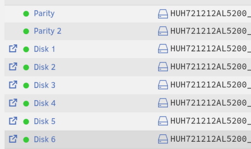

After updating to 7.3, I have the same issue as above the above poster. Using a SAS Xratex DAS with HGST drives. I don't know if I can be of any other help, let me know if there is something I can post.
Just providing an update on my disk issues with the LSI 9305 card. What I have managed to establish is the issue relates to the firmware on the drive being Dell EMC and they are returning a different scsi code than the one you'd expect for drive spun down/spinning up not ready. So short of that code getting included as an acceptable code by unraid (I assume) its a dead end.
As to why it works ok with the 9211 controller, it must be changing the scsi codes even though its in IT mode.
