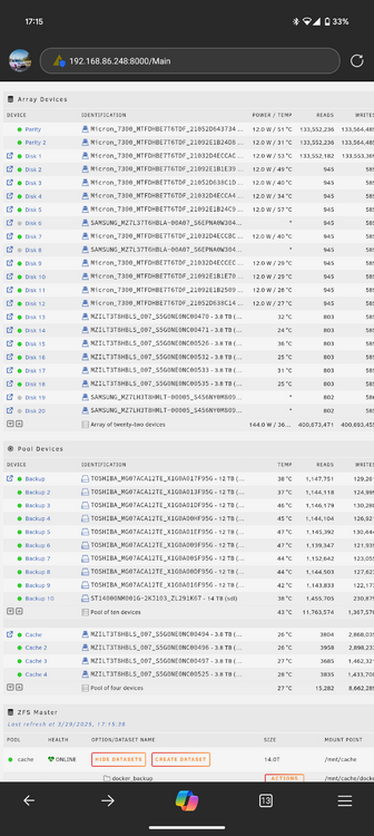

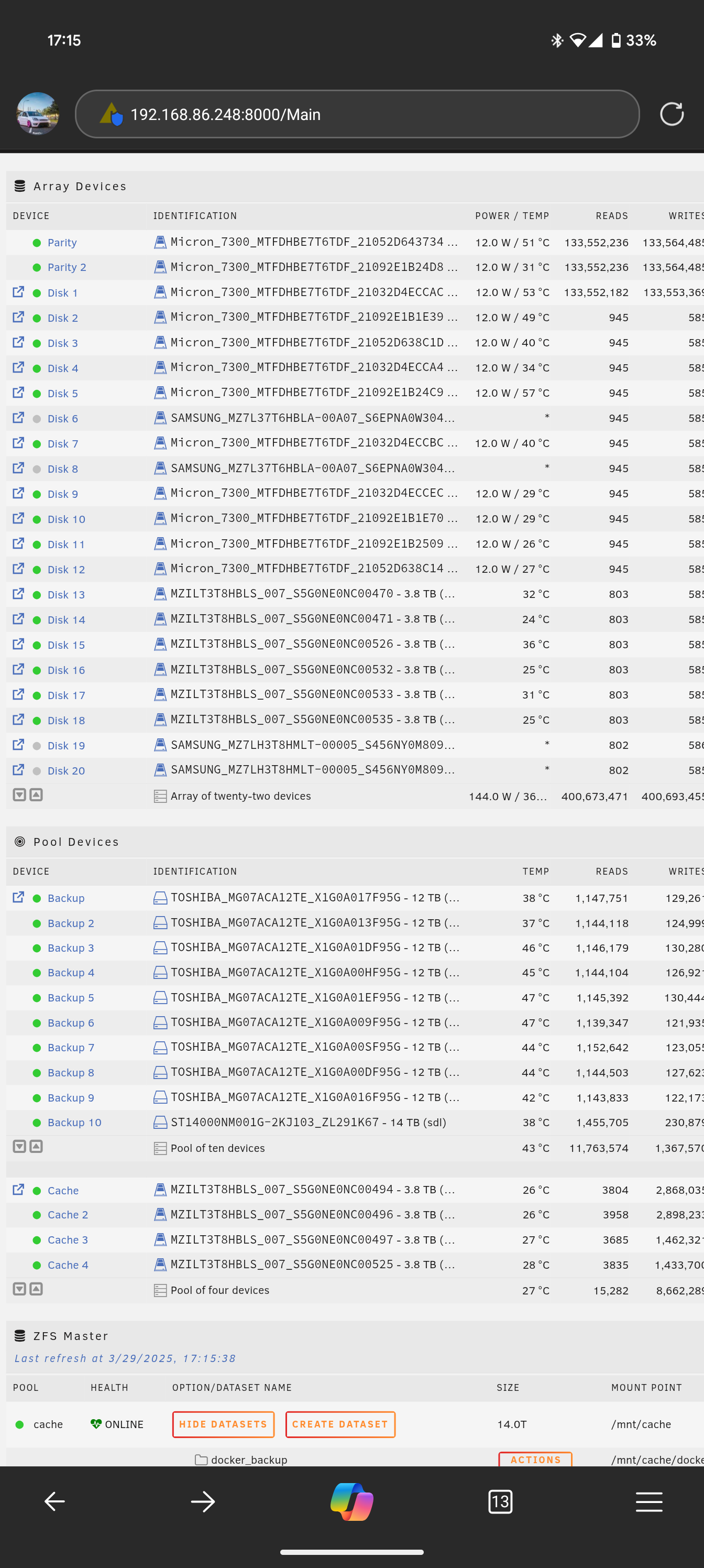

So I have just started using the array again with a few Samsung 3.84tb SAS ssds and noticed none of them are spinning down :( seen this plugin on community apps but it still doesn't seem to be spinning them down happy to provide any further information if needed.
Drives are MZILT3T8HBLS_007
Iv also got a load of NVME disks U.2 Micron_7300_MTFDHBE7T6TDF these don't look to be spinning down either any suggestions would me much appreciated!
SSDs do not spin down.
Look at the bright side though - they do not spin up, either.

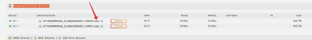

Hello everyone!
I installed the plugin because I installed the drives SAS:
Vendor: SEAGATE
Product: ST16000NM002G
Revision: E003
Compliance: SPC-5
And they don't want to turn off:
Jan 30 15:04:27 unraid emhttpd: spinning down /dev/sdx
Jan 30 15:04:27 unraid SAS Assist v2024.11.25: Spinning down device /dev/sdx
Jan 30 15:04:57 unraid emhttpd: read SMART /dev/sdx
Can anyone tell me what needs to be done to properly force the drives to turn off?
root@unraid:~# /usr/sbin/sdparm -C sense /dev/sdx
/dev/sdx: SEAGATE ST16000NM002G E003
root@unraid:~# /usr/local/emhttp/plugins/sas-spindown/sas-util
SAS Spindown Utility (v20240218.01)
sdf | ST16000NM002G | 1000:0064:1000:30c0 | n/a |
sdg | ST16000NM002G | 1000:0064:1000:30c0 | n/a |
sdy | ST16000NM002G | 1000:0064:1000:30c0 | n/a |
sdx | ST16000NM002G | 1000:0064:1000:30c0 | n/a |
Run completed. The output is at /tmp/sas-util-out.
sas-util-out
Edited by mark949
20 minutes ago, mark949 said:
Vendor: SEAGATE
Revision: E003
Compliance: SPC-5
Many Seagate drives appear not not work well with this plugin - i.e., not to respond to the "spin down" SAS wire instruction with a temporary spindle spindown; however, from your log excerpt it appears that the issue is different - something in your Unraid setup keeps issuing i/o against the drive. The message unraid emhttpd: read SMART /dev/sdx is an indication of an i/o being issued, 30 seconds after the drive was sent to sleep.
Suggest you explore who is keeping the drive busy, and check whether you can silence that entity. Might be another plugin, docker, VM, a remote access to one of your shares etc.
These new disks haven't been allocated to the data array yet.
There are no plugins or containers that work with them, they are currently in "Unassigned Disk Devices"
Understood. Still, something is waking them up 30 secs later and causing Unraid to issue a SMART read.
Let's put that aside for a moment and check whether your drives are even spinning down at all.
Can you run the following line on your console and paste the output:
sg_start -rp3 /dev/sdx ; sleep 3s; sdparm -C sense /dev/sdx
root@unraid:~# sg_start -rp3 /dev/sdx ; sleep 3s; sdparm -C sense /dev/sdx
Additional sense: Standby condition activated by command
Okay this is actually good - it means the drive does go into spindown when the command sends it there.
