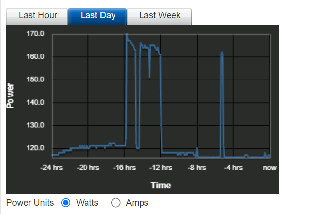

And Voila - as simple as that... Set the drive timeout to an hour. Now it spins down regular and saves power!
Checking in Idrac, looking a lot better now...
Thank you!!

20 hours ago, Elmojo said:
There are a myriad factors that can govern how certain hardware works (or doesn't) within a given environment.  There often is no simple "explanation", unfortunately.   If you find a definite culprit for the failure to sleep, other than "it's Dell's fault", then by all means, please share it! :)
1) people say that this problem affect only segate sas drives but it is not. i have wd UltraStar (SAS), WD WD20EFRX (SATA), and ST8000NM0045(SATA). it afects them all if they are connected to dell server only.
2) to wake up disks from sleep you need to access them. there is 2 options --in my case --  or unraid started by miracle  write something only when it is connected to dell machine or more prabable dell is "doing something" to wake disks up. Maby check smart or do other "checky" things. Also Dell is known from making things hard if you don't use dell hardware. and by the way i have segate exos 7e10 (S/N WREDA0LB if you want to check) branded by DELL with del firmware  and you know what it sleeps like a baby. But it shlould not becouse it is segate :)
That is why i can tell with clear conscience it is DELL fault. but i intend to check 2 things.
a) put there old hewlett packard h330 card with flashed lsi firmware. if it helps i will know that problem is not Dell server platform but controller. i need to wait for sas cables becouse this controller have diferent connectors.
b) flash hba330 with not dell firmware and if disks will stay aslep than we will know it is dell firmare not faulty controller. after that i will get back to you to point definite culprit (wishpering) witch is DELL ofc.  :)
i didn't done this thing before so it will take me some time to ask uncle google for help.
14 hours ago, Spokz said:
Are they in IT mode, no dell bs? What cards?
Yes, both in IT mode.
One is a PERC H810 in HBA mode.  That one is running my external MD1200 disk shelf.  Those drives all sleep perfectly.
The other is a PERC H730, also in HBA mode.  That one is running the internal drives connected to the backplane.  Most of the drives sleep fine, except for the 5x 6TB Seagate drives I bought a couple months ago.
