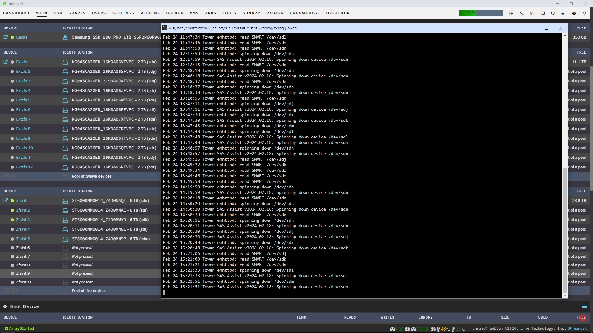

I have a mixture of SATA and SAS drives. The SATA drives stay spun down, the SAS drives spin up, one after the other, within a few minutes. I've shut down my dockers, this still happens. The open files plugin does not show any files being touched when the drives spin up - especially since the SAS drives have no files on them.
If the re-spin happens within a few minutes (rather than a couple of seconds), then it's almost certain that either (a) someone is issuing i/o against the drive or (b) some plug-in has waken up and is spinning the drive up, either rightly or erroneously (we've seen both - e.g. an old version of the autofan plugin used to do the wrong thing when inquiring about the drives, which would wake up all SAS drives).
Have you looked at your plugins? Can you disable them all and try? Then, if the issue goes away, you can add them back one by one.

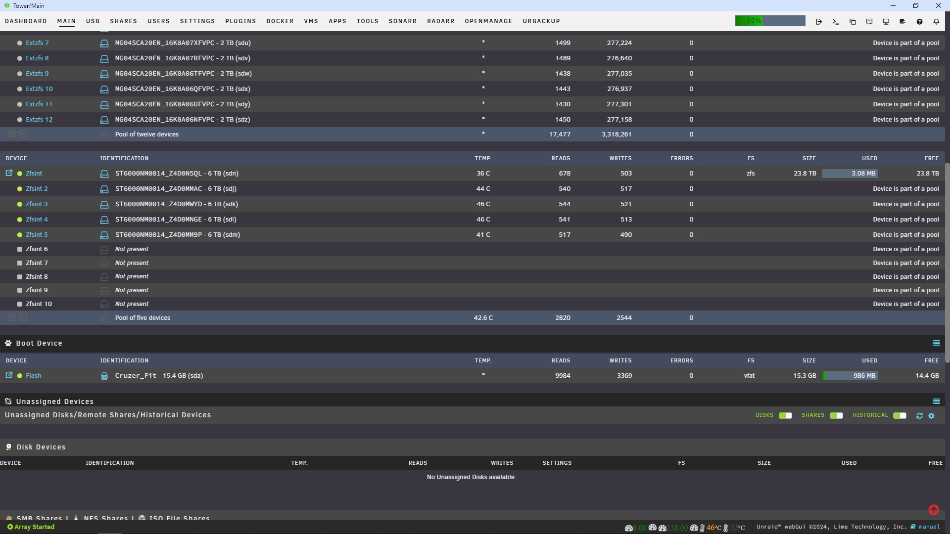

38 minutes ago, doron said:
Thanks @Elmojo . One further question: which are the zfs devices?
Re the SMART thing, this is in fact a *result* of the drive being spun up, rather than the cause, so, no...
Sent from my tracking device using Tapatalk

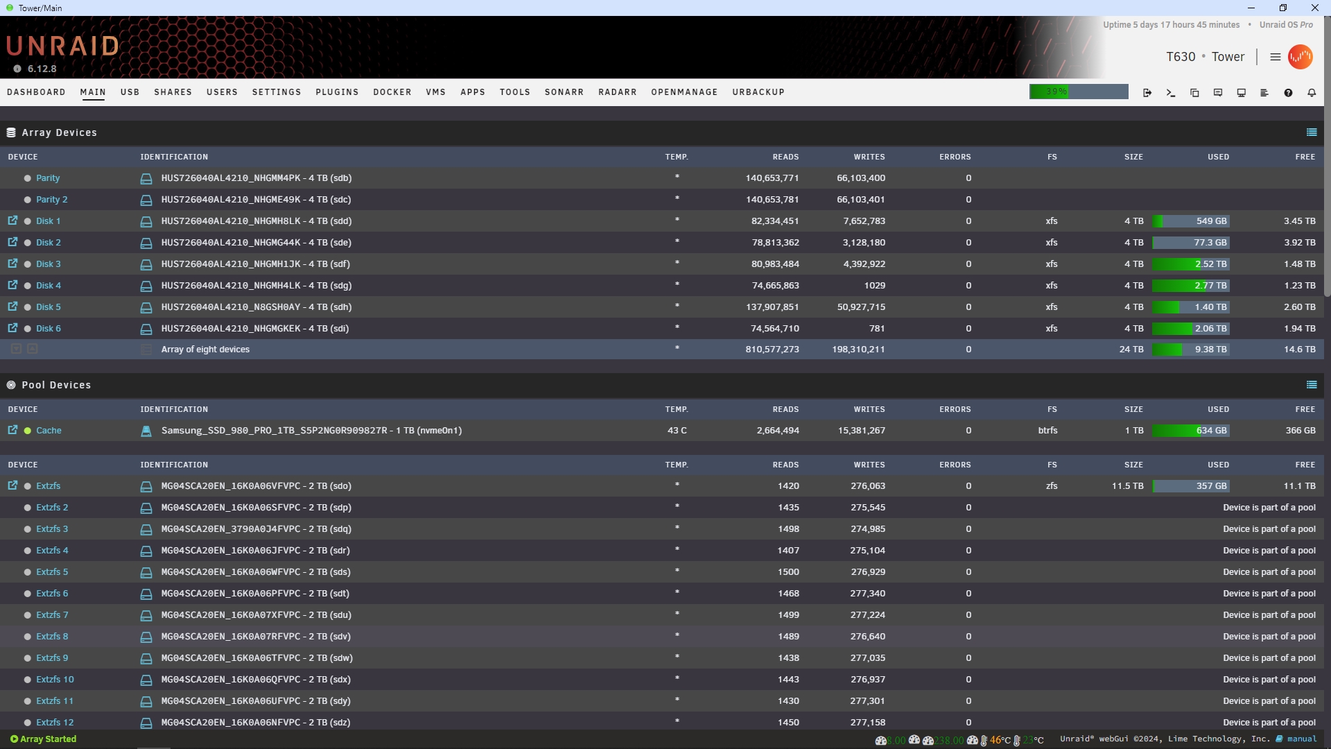

SDJ-SDN are the ZFS pool that won't seem to stay down.
SDO-SDZ are also a ZFS pool, but those are in an external enclosure, and oddly seem to be working fine.
The difference, I think, is that the first pool are Seagate drives.
Bummer about the SMART, I thought I had it figured out... lol
Here's the whole rundown, if that helps...
cap.thumb.JPG.16ee566431d4e80a1ba8771d5a9658a3.JPG935425602_cap001.thumb.JPG.c09d82d5cf41c664f13ea89a3e6cd0e8.JPG
Edited by Elmojo
added screenshots
@Elmojo, from looking at your data, it does seem that your internal ZFS pool (the one we're discussing) is in fact being accessed a short while after being spun down. You can see that the "SMART read" messages (a great indication of a drive being spun up) show up about 1-2 minutes after the respective spin down messages. This, in most cases, indicates some sort of disk activity.
 The question whether the drive in fact spins down can be answered as follows:
1. Open both a UI and a CLI terminal window, have both ready
2. Push the UI button to spin the drive down, after noting its dev name
3. Immediately thereafter (don't wait too long), issue, on the CLI terminal, this command:
sdparm -C sense /dev/sdX
replace sdX with the actual device name.
If the drive is spun down, you will see the word "standby" somewhere on the sense data.
Indeed.
root@Tower:~# sdparm -C sense /dev/sdn
    /dev/sdn: SEAGATE   ST6000NM0014      MB84
Additional sense: Standby condition activated by command
They spin down, but you see in the attached screen that sdj, sdk and sdn have already spun right back up!cap.thumb.JPG.8970714aefcc39f8bee9448a6ee13500.JPG
@Elmojo right, yet it does sometimes take it around two minutes until it spins back up. So, probably activity.
How do I go about tracking down what that activity might be?  Is there a tracer app that will tell me what processes access which devices?  If so, that sounds like it might be something a little beyond my abilities to interpret... lol
@doron So my devices hapilly spin down manually and stay down for a while before coming back up. However they never spin down automatically.

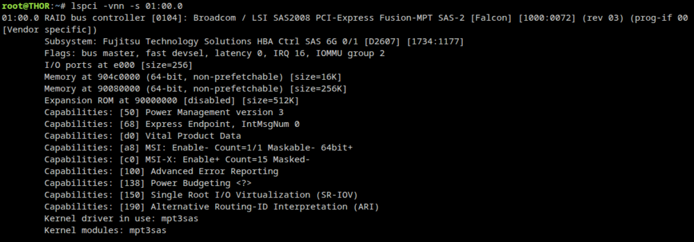

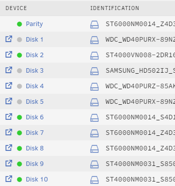

I am using ST6000NM0034 Drives on a Dell RX730.
Bit of a newbie here - Any suggestions as to what I can try??
Many thanks!
Read back through the past couple pages at least.
You appear to be having the exact same issue as me.
Hopefully someone will jump in to help us. :)
