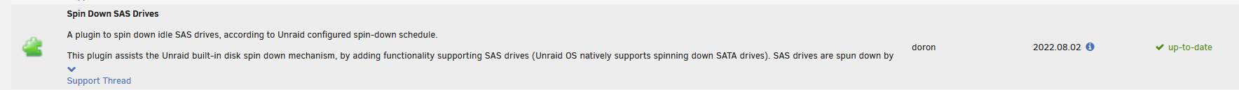

[Plugin] Spin Down SAS Drives

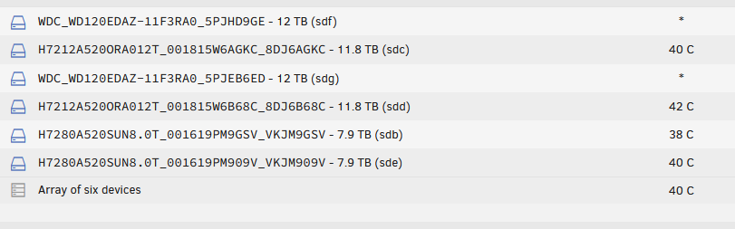

Doesn't look like you necessarily have an issue - more like there's i/o activity against your drives.
Could be either access to data from a client, or a plugin / docker etc.
6 hours ago, Dustiebin said:
This 'app' actually keeps my SAS spun down it is only my SATA's that are getting spun back up with the same SMART trigger.
Note the SMART message is not a trigger - it's a response to Unraid seeing (or believing) the drive being spun up.
More importantly, note there's a time gap between your spin-down and the SMART messages - a few minutes. That may well reflect normal drive activity.

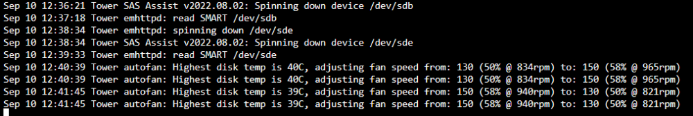

Just upgraded to 6.10.3 (Yeah, I know I wasn't a fast adopter here)
Anyways I'm getting the same issues with SAS HD's (WD's) that look like they're not spinning down.  It Seems like the smart read is spinning them up.   Anyway to set smart read setting time interval?  I'm going to try to shut off dockers this weekend to see if that solves it.   No issues w/ SAS not spinning down on 6.9.
Sep 6 16:15:21 Skynet SAS Assist v2022.08.02: Spinning down device /dev/sdd Sep 6 16:15:35 Skynet emhttpd: spinning down /dev/sde Sep 6 16:15:35 Skynet SAS Assist v2022.08.02: Spinning down device /dev/sde Sep 6 16:15:47 Skynet emhttpd: spinning down /dev/sdg Sep 6 16:15:47 Skynet SAS Assist v2022.08.02: Spinning down device /dev/sdg Sep 6 16:16:00 Skynet emhttpd: spinning down /dev/sdi Sep 6 16:16:00 Skynet SAS Assist v2022.08.02: Spinning down device /dev/sdi Sep 6 16:16:14 Skynet emhttpd: spinning down /dev/sdl Sep 6 16:16:14 Skynet SAS Assist v2022.08.02: Spinning down device /dev/sdl Sep 6 16:16:27 Skynet emhttpd: spinning down /dev/sdn Sep 6 16:16:27 Skynet SAS Assist v2022.08.02: Spinning down device /dev/sdn Sep 6 16:16:40 Skynet emhttpd: spinning down /dev/sdt Sep 6 16:16:40 Skynet SAS Assist v2022.08.02: Spinning down device /dev/sdt Sep 6 16:16:54 Skynet emhttpd: spinning down /dev/sdu Sep 6 16:16:54 Skynet SAS Assist v2022.08.02: Spinning down device /dev/sdu Sep 6 16:17:09 Skynet emhttpd: spinning down /dev/sdy Sep 6 16:17:09 Skynet SAS Assist v2022.08.02: Spinning down device /dev/sdy Sep 6 16:17:23 Skynet emhttpd: spinning down /dev/sdz Sep 6 16:17:23 Skynet SAS Assist v2022.08.02: Spinning down device /dev/sdz Sep 6 16:18:00 Skynet emhttpd: read SMART /dev/sdc Sep 6 16:18:14 Skynet emhttpd: read SMART /dev/sdd Sep 6 16:18:27 Skynet emhttpd: read SMART /dev/sde Sep 6 16:18:41 Skynet emhttpd: read SMART /dev/sdg Sep 6 16:18:54 Skynet emhttpd: read SMART /dev/sdi Sep 6 16:19:07 Skynet emhttpd: read SMART /dev/sdl Sep 6 16:19:21 Skynet emhttpd: read SMART /dev/sdn Sep 6 16:19:35 Skynet emhttpd: read SMART /dev/sdt
The "read SMART" thing is essentially Unraid's response to the drive spinning up, rather than the cause of that spin-up.
Note that in your case there seems to be a time gap between the spin-down and "read SMART" messages - like 30 seconds etc. - which usually indicates there's actually some disk activity that spins them up.
From the log snippet you provided, it seems as if only some of the drives spin back up, but not all. If that is indeed the case, I'd probably look for a share or folder that lives specifically on these drives, and try to figure out who accesses this share/folder. Just a thought.

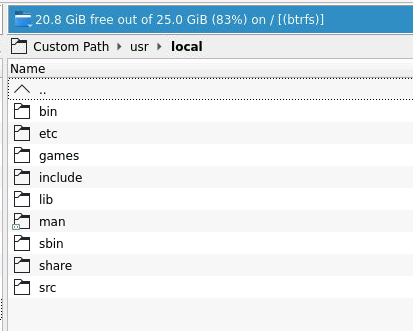

 Pardon what I'm sure are some extremely stupid questions, but is this a directory you need to make? I cant seem to find where this is to drop the script into. I dont see anything like this when I browse either my shares, my boot flash drive or my cache disk. I assume the plugins are installed in the config folder of my boot flash drive, but I don't see where this directory would be or would be created (I assume this is all going on the flash drive).
furthermore can I use the userscripts plugin to automate having this run everytime I boot up? I see discussion few posts after this "hack" to fix autofan was posted but unfortunately that is greek to me as well. I dont shut down very often, but I like to streamline where I can as I am such a novice I try to get it running in a fire and forget sort of way.

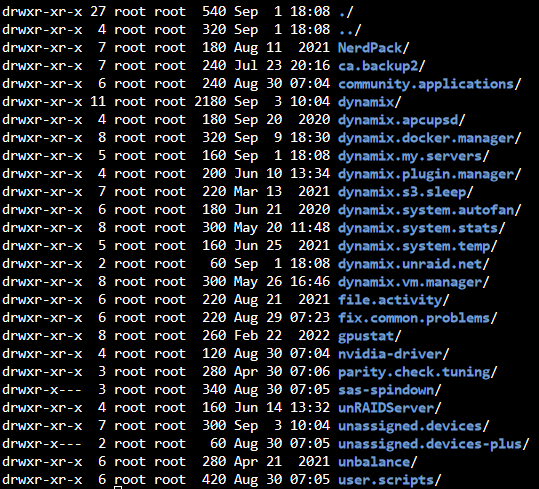

You need to put in  /usr/local/emhttp/plugins/dynamix.system.autofan/script it should exist if you have autofan installed.
you can add cp and a chmod +x to the go file to install at boot or use a user script.
So excuse my ignorance, but I used Krusader to search for the "emhttp" folder, because thats where I can't seem to go any further.

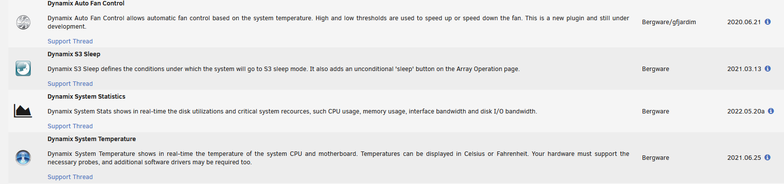

19 hours ago, doron said:
Don't be. Mystery solved. Indeed, Autofan is doing that. It has a bug which causes SAS drives to be spun up every few minutes. Scroll back in this topic for a full discussion. I actually offered a software fix (pull request pending) but the plugin author hasn't responded.
Ahhh -   if I disable autofan then bios will control the fan right?
I was reading your script "hack" and I was wondering if I got this right - then I would have to do this everytime I started the array?  Can it be added to the userscripts plugin?
Edited by cbr600ds2
I think this will be the root fs of the docker not of the host. you may need to add a mapping for the host root.
Open a terminal and run  ls /usr/local/emhttp/plugins/dynamix.system.autofan/script

And just to be like confirming I am not an idiot (hopefully), I have both SAS spin down and Auto Fan installed and enabled. You can even see the SAS only not spinning down in my gui.
Those are 2 shucked WD drives, they spin down with no issue.
and a picture of my log, the only activity I have is the temp being polled. image.thumb.png.1a1bc3bf1b1fad408aca2ad54b46bb7b.png

See previously in this thread. The autofan plugin has a bug that causes SAS drives (only) to be spun up periodically (every few minutes - basically, the polling interval).

Can you post the output of:
ls -la /usr/local/emhttp/plugins

Sorry missed the s off the end.
root@Tower:~# cd /usr/local/emhttp/plugins/dynamix.system.autofan/
root@Tower:/usr/local/emhttp/plugins/dynamix.system.autofan# ls
FanSettings.page  README.md  default.cfg  icons/  images/  include/  scripts/
root@Tower:/usr/local/emhttp/plugins/dynamix.system.autofan# ls scripts/
autofan*  rc.autofan*

This is showing it there right? still confused how I am missing the folder if it comes with the autofan install.
So everything is working now, I assume somewhere along the way (beyond the typo in SimonF's post, which I didn't catch either) I assume I must have had a typo myself. Though I find it very strange that I can't browse to the folder in Krusader, I am sure I have a setting not checked somewhere.
The big thing was finally seeing something about the MC command, which might be second nature to all your Linux guru's but until I remembered that is how you easily navigate and do things like put this script in the folder I felt like I was taking crazy pills a bit. One of those things where there is just so much info, and so many spaceinvader videos, that finding what you're looking for, and I spent a semi long googling and searching around these forums, can end up being quite daunting since you get a lot of relevant but not specific info.
Anyways, thanks to both @SimonF and @doron . If I can trouble you for one more question, now that I see what I did, why would you need a script or anything further to make this work everytime on boot? Since we replaced the already used script with your new code, wont this just automatically run on boot since Autofan uses this script?
All these folders are re-created each time you reboot Unraid (technically, all plugins are re-installed on boot). The filesystem you are seeing is in memory. So, yes the hack needs to be replaced each boot.
Good news is that author of autofan has finally picked up my fix and hopefully he will make it into an official fix.
