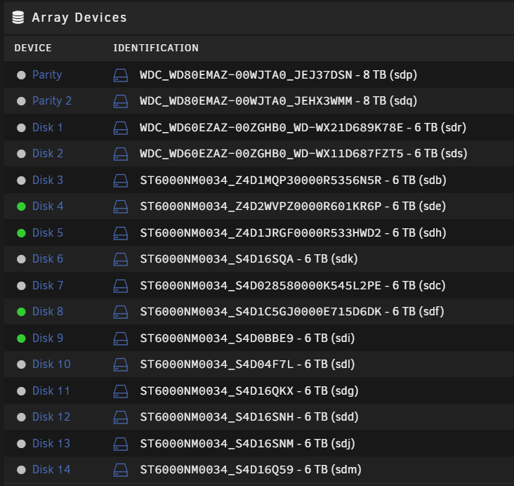

Thanks for the plg. But no luck on my 6.11.1 server. I've got 4 Seagate SAS ST6000NM0034, none of which willingly spins down at the spindown delay according to the system log.
Please provide some more context as to what does in fact happen.
Seagate SAS drives are known to not always play nice with the spin down/up instructions, but to be able to respond specifically, some info is required.
Thanks for the reply.
After I installed it nothing happened nor sas spindown operation could be found in the system log though I set spindown delay to 15m which worked well on other sata drives.
Please provide diagnostics, and/or reply --
- Do you see any syslog messages from the plugin ("SAS Assist")?
- When you click the green button to the left of a SAS drive, what do you see in syslog?

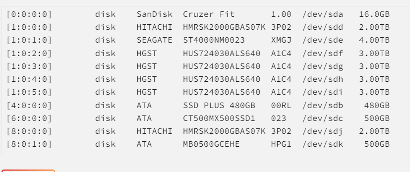

I am working on putting several Hitachi/HGST 3 TB SAS drives (models HUS723030ALS640 and HUS724030ALS640) into service on one of my UnRAID servers and am running into the same issue. All of the SAS drives are currently in a pair of external enclosures attached to the server via a single LSI 9201-16e with no SAS expanders.
Spin Down SAS Drives was installed via Community Apps on UnRAID 6.11.1.
Clicking on the spin-down ball results in spinning green arrows, returning to a green ball. Nothing appears to be logged in syslog.
Diagnostics attached.
eris-diagnostics-20221104-1138.zip
I don't see any SAS spin down messages in the logs. Disk 20 was creating errors.
What are you using to run the web gui from as there are loads for nchan out of memory errors.
Disk 20 was suspect and is mid-preclear. I'm pretty sure it's going to get disposed of.
Default web GUI inside a Vivaldi tab. Behavior is the same (spins, goes back to green ball) from Edge and Chrome with all other web browsers closed when trying.
Most recent nchan error looked to me to be about 6 hours before I pulled diagnostics (and a few hours before I started looking into SAS spindown), and I'd rebooted my desktop between then and trying to get Spin Down SAS Drives installed/working.
edit: typo

2 hours ago, DiRiN said:
Greetings all,
I have an issue with a few disks also not spinning down. I've noticed this was happening ever since my upgrade to 6.11. I'm currently running 6.11.5. I've uninstalled every app / plugin that reads anything from disk or reports smart information (temp, fan control etc) and disabled docker completely. I've changed spindown to 15 minutes and I see the calls to SAS Assist, but seconds later a Read call for SMART is kicked in and it spins the disk back up. The drives with issues can be seen with green mark below:
My System Log looks like the following:
Nov 27 13:15:40 Tower  emhttpd: spinning down /dev/sdt
Nov 27 13:15:40 Tower  emhttpd: spinning down /dev/sdn
Nov 27 13:15:40 Tower  emhttpd: spinning down /dev/sdo
Nov 27 13:15:41 Tower  emhttpd: spinning down /dev/sdu
Nov 27 13:16:07 Tower  emhttpd: spinning down /dev/sdm
Nov 27 13:16:07 Tower  emhttpd: spinning down /dev/sdj
Nov 27 13:16:07 Tower  emhttpd: spinning down /dev/sdk
Nov 27 13:16:07 Tower  emhttpd: spinning down /dev/sdh
Nov 27 13:16:07 Tower  emhttpd: spinning down /dev/sdg
Nov 27 13:16:07 Tower  emhttpd: spinning down /dev/sdd
Nov 27 13:16:07 Tower  emhttpd: spinning down /dev/sde
Nov 27 13:16:07 Tower  emhttpd: spinning down /dev/sdb
Nov 27 13:16:07 Tower  emhttpd: spinning down /dev/sdr
Nov 27 13:16:07 Tower  emhttpd: spinning down /dev/sdf
Nov 27 13:16:07 Tower  emhttpd: spinning down /dev/sdc
Nov 27 13:16:07 Tower  emhttpd: spinning down /dev/sds
Nov 27 13:16:07 Tower  emhttpd: spinning down /dev/sdi
Nov 27 13:16:07 Tower SAS Assist v2022.08.02: Spinning down device /dev/sdm
Nov 27 13:16:07 Tower SAS Assist v2022.08.02: Spinning down device /dev/sdg
Nov 27 13:16:07 Tower SAS Assist v2022.08.02: Spinning down device /dev/sdj
Nov 27 13:16:07 Tower SAS Assist v2022.08.02: Spinning down device /dev/sdd
Nov 27 13:16:07 Tower SAS Assist v2022.08.02: Spinning down device /dev/sdh
Nov 27 13:16:07 Tower SAS Assist v2022.08.02: Spinning down device /dev/sdb
Nov 27 13:16:07 Tower SAS Assist v2022.08.02: Spinning down device /dev/sde
Nov 27 13:16:07 Tower SAS Assist v2022.08.02: Spinning down device /dev/sdk
Nov 27 13:16:07 Tower SAS Assist v2022.08.02: Spinning down device /dev/sdf
Nov 27 13:16:07 Tower SAS Assist v2022.08.02: Spinning down device /dev/sdi
Nov 27 13:16:07 Tower SAS Assist v2022.08.02: Spinning down device /dev/sdc
Nov 27 13:16:25 Tower  emhttpd: read SMART /dev/sdh
Nov 27 13:16:25 Tower  emhttpd: read SMART /dev/sde
Nov 27 13:16:25 Tower  emhttpd: read SMART /dev/sdf
Nov 27 13:16:25 Tower  emhttpd: read SMART /dev/sdi
Nov 27 13:16:38 Tower  emhttpd: spinning down /dev/sdq
Nov 27 13:16:38 Tower  emhttpd: spinning down /dev/sdl
Nov 27 13:16:38 Tower  emhttpd: spinning down /dev/sdp
Nov 27 13:16:38 Tower SAS Assist v2022.08.02: Spinning down device /dev/sdl
Nov 27 13:31:26 Tower  emhttpd: spinning down /dev/sdh
Nov 27 13:31:26 Tower  emhttpd: spinning down /dev/sde
Nov 27 13:31:26 Tower  emhttpd: spinning down /dev/sdf
Nov 27 13:31:26 Tower  emhttpd: spinning down /dev/sdi
Nov 27 13:31:26 Tower SAS Assist v2022.08.02: Spinning down device /dev/sdh
Nov 27 13:31:26 Tower SAS Assist v2022.08.02: Spinning down device /dev/sdf
Nov 27 13:31:26 Tower SAS Assist v2022.08.02: Spinning down device /dev/sde
Nov 27 13:31:26 Tower SAS Assist v2022.08.02: Spinning down device /dev/sdi
Nov 27 13:31:45 Tower  emhttpd: read SMART /dev/sdh
Nov 27 13:31:45 Tower  emhttpd: read SMART /dev/sde
Nov 27 13:31:45 Tower  emhttpd: read SMART /dev/sdf
Nov 27 13:31:45 Tower  emhttpd: read SMART /dev/sdi

Nov 27 12:59:55 Tower kernel: sd 1:1:20:0: [sdf] Write Protect is off
Nov 27 12:59:55 Tower kernel: sd 1:1:20:0: [sdf] Mode Sense: db 00 10 08
Nov 27 12:59:55 Tower kernel: sd 1:1:20:0: [sdf] Write cache: enabled, read cache: enabled, supports DPO and FUA
Nov 27 12:59:55 Tower kernel: sd 1:1:20:0: [sdf] Preferred minimum I/O size 4096 bytes
Nov 27 12:59:55 Tower kernel: sdf: sdf1
Nov 27 12:59:55 Tower kernel: sd 1:1:20:0: [sdf] Attached SCSI removable disk
Nov 27 13:00:19 Tower  emhttpd: ST6000NM0034_S4D1C5GJ0000E715D6DK_35000c50099185123 (sdf) 512 11721045168
Nov 27 13:00:19 Tower kernel: mdcmd (9): import 8 sdf 64 5860522532 0 ST6000NM0034_S4D1C5GJ0000E715D6DK_35000c50099185123
Nov 27 13:00:19 Tower kernel: md: import disk8: (sdf) ST6000NM0034_S4D1C5GJ0000E715D6DK_35000c50099185123 size: 5860522532
Nov 27 13:00:19 Tower  emhttpd: read SMART /dev/sdf
Nov 27 13:00:25 Tower  emhttpd: shcmd (45): echo 128 > /sys/block/sdf/queue/nr_requests

Have you tried the file activity plugin to see if any files being accessed.

I looked into the File Activity plugin as suggested. I was having issues with it, and with investigating how to get it to work I had installed the Fix Common Problems / Tips and Tweaks Plugin. I then adjusted the Tips and Tweaks plugin setting for Max Watches 'fs.inotify.max_user_watches': to 6524288 and changed the settings of the File Activity Plugin to the following:
After making all the above changes to get the Plugin for FIle Activity to work correctly, then my SAS Spindown started working correctly. lol. So now I have no idea what was causing it. But if I had to make a guess it's the inotify changes I made in Tips and Tweaks. I'll leave it as it is now that it's working. Odd little workaround, that the changes required for one to work properly causes this plugin to work properly.
System Logs as of now:
Nov 27 20:04:09 Tower  emhttpd: spinning down /dev/sdm
Nov 27 20:04:09 Tower  emhttpd: spinning down /dev/sdj
Nov 27 20:04:09 Tower  emhttpd: spinning down /dev/sdk
Nov 27 20:04:09 Tower  emhttpd: spinning down /dev/sdh

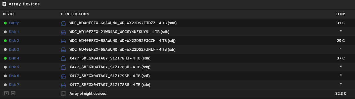

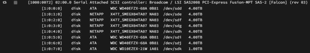

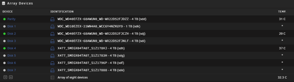

I installed the plugin 2 days ago (Unraid 6.11.5) and it wasn't working at all, then I just rebooted the server and magically it started working without any issue.
Thank you so much for your work, really appreciate it! :)🙌
Btw, I'm using a mix of SAS and SATA drive, SAS drives spin down perfectly like SATA ones, both for inactivity (set at 15 mins) and when asked manually too, no issue at all!
SAS drives are recognized as NETAPP X477_SMEGX04TA07 in Unraid, but in reality they are Seagate Constellation ES.3 ST4000NM0023 (most probably they've been rebranded by Netapp).
