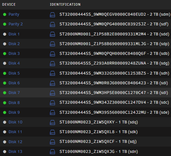

I have some consistency problems with the plugin, sometimes it works, sometimes not.
Currently, drives of type "ST32000444SS" are not able to spin down, I have tried restarting the server, reinstalling the plugin, checking for disk access and running some of the suggested commands, but nothing seems to work.
Here are some logs from what I have tried:
sas-util output.txt sas-util.txt syslog.txt

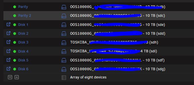

OK, I have a number of "Factory Refurbed" Seagate Exos WL 10TB SAS 12G 3.5 drives in my backup system.
They won't spin down for the life of me. Is there any troubleshooting I can do?
They show as the ever so "I trust this name" as "OOS1000G"
Are you running any apps that would poll these drives for status? E.g. Autofan or Telegraf?
When you spin the drives down can you hear them spin down and back up again?
You might just be unlucky, but I managed to get mine working by putting exclusions in telegraf and Autofan.

Hah, no its definitely the drives. I can click spin down forever, and they never do, not even for a second and then spin up.
This is on a very bare bones server that I use for backups. It sits in S3 sleep until woken by my main Unraid server. Then 5 minutes later backups run. Then after 30 minutes of activity the drives should spin down, then 15 minutes later go back to sleep.
The Toshiba SATA drives spin down nicely, and the SAS drives in my main server spin down, its just these particular odd drives.

On 3/22/2023 at 3:16 AM, SimonF said:
Do see any entries in the log for SAS Spindown Helper?
Yeah, and I think I know whats going on, but I have no idea how to stop it:
Mar 23 15:10:35 Backup SAS Assist v2022.08.02: Spinning down device /dev/sdd
Mar 23 15:10:54 Backup emhttpd: spinning down /dev/sdf
Mar 23 15:10:54 Backup SAS Assist v2022.08.02: Spinning down device /dev/sdf
Mar 23 15:11:21 Backup emhttpd: read SMART /dev/sdd
Mar 23 15:11:21 Backup emhttpd: read SMART /dev/sdf
So as soon as they're spun down for some reason SMART is read and spins them back up again.
