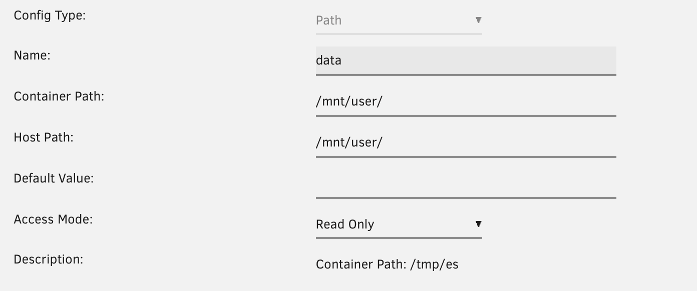

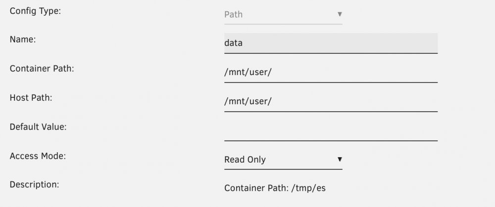

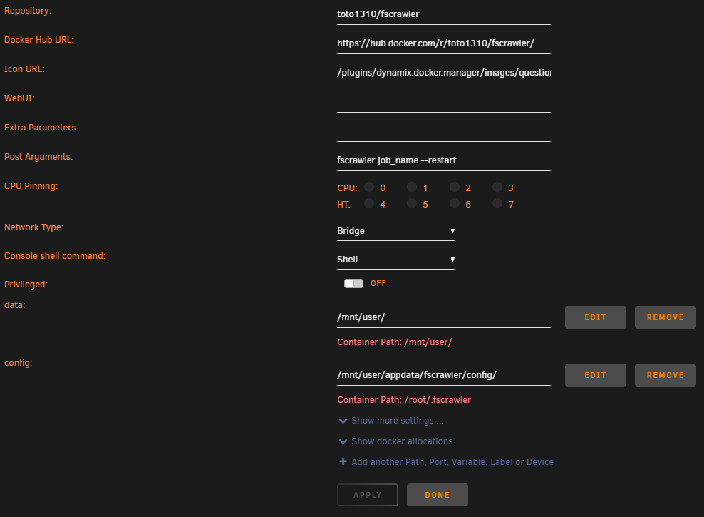

In the template, you need to set the config and data directories. The data directory mount point in FSCrawler needs to match the real mount point in unraid as this path is written into the Elasticsearch index later on, and then needs to be valid for SAMBA to read it. I used /mnt/user/ to be able to search all shares later on.
To start the docker, the following post argument needs to be added (turn on advanced mode in the template):
Post Arguments: fscrawler job_name --restart
The option "--restart" causes a full re-index of the whole share. This option is only needed for the first execution of the crawler, later on this option can be removed so that the crawler only monitors the data directory for changes and feeds these into the Elasticsearch index.

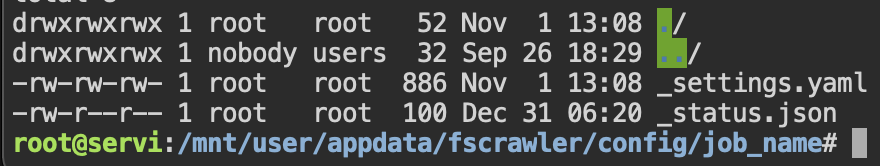

After the first run, FSCrawler creates a _settings.yaml file under /mnt/user/appdata/fscrawler/config/job_name/_settings.yaml
This file needs to be edited. I have the following content. Please change the IP for your Elasticsearch interface and add the excludes that you do not want to be crawled. The URL needs to match your mount point as this will serve as the "root" directory.

It is a bit like a chicken and egg problem. The file should get created after the first run, but after this time has passed I don't remember if I manually added the file or if I copied it from inside the docker (so not mapping the config file at all and then copying the file outside of the docker via docker command).
One way would be to manually create the file:
1.) Go to /mnt/user/appdata/fscrawler/config/ and create the folder "job_name" (permissions 999, root / root)
2.) Inside the new job_name folder, create a file called _settings.yaml and paste the content from my initial post. Please make sure to change the IP. address at the bottom of the file (- url). Later on there will be as well a 2nd file called _status.json, but I don't think this is needed initially.
