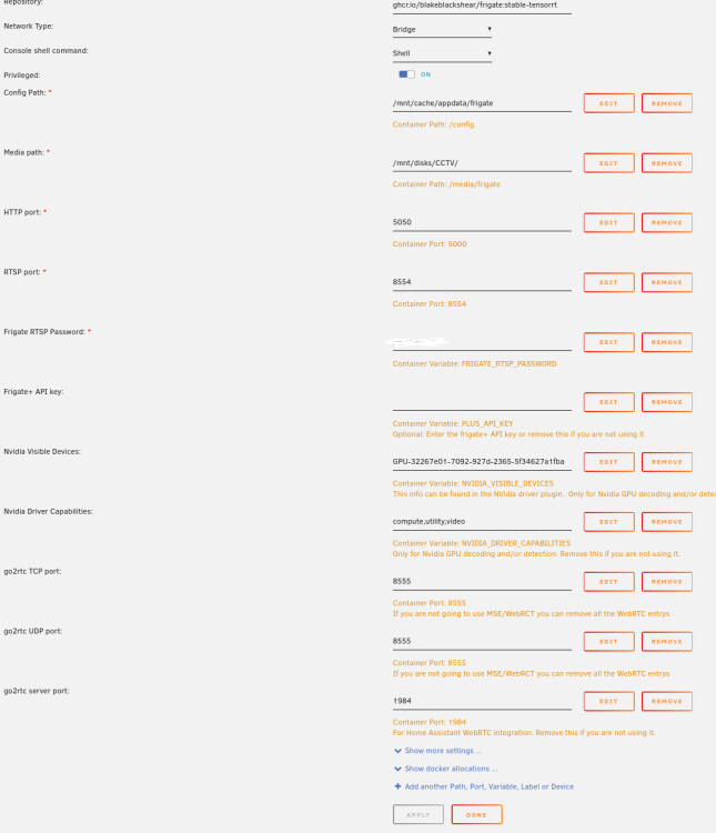

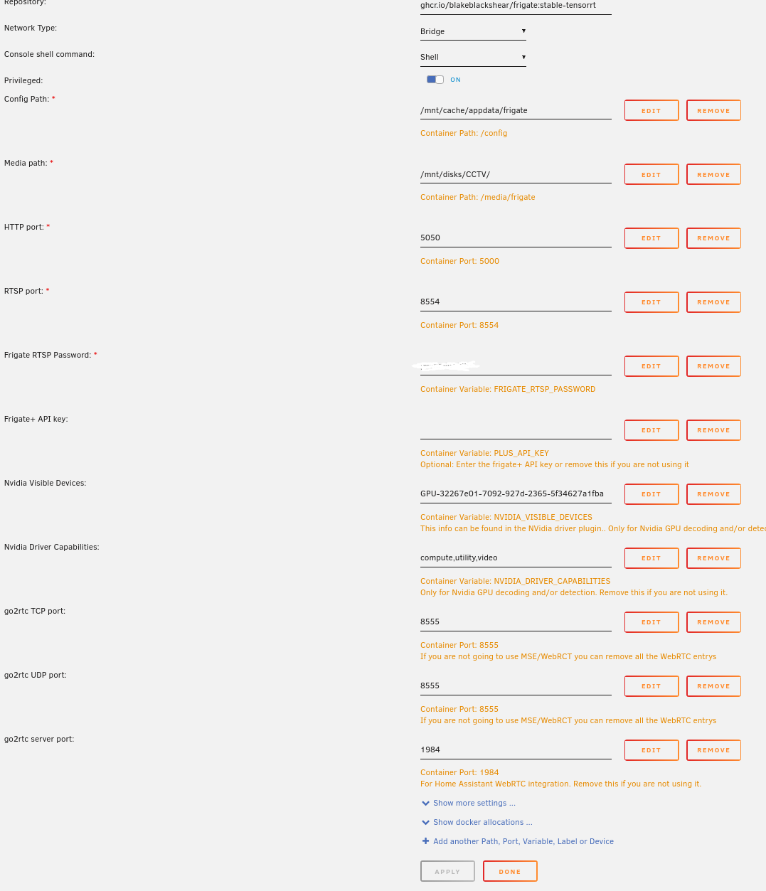

So turns out my server locks up were not tied to the USB Coral device I was trying to use but rather out of memory issues that seem to be related to the ffmpeg process. Not sure where I've gone wrong, it works for days/weeks and then at the most inconvenient times it hard locks.
mqtt:
  host: 10.0.0.3
  port: 1883
  topic_prefix: frigate
  client_id: frigate
  user: frigate
  password: **CENSORED**
  stats_interval: 60
ffmpeg:
  hwaccel_args: preset-nvidia-h264
detectors:
  cuda:
    type: tensorrt
model:
  path: /config/model_cache/tensorrt/yolov4-tiny-416.trt
  labelmap_path: /labelmap.txt
  input_tensor: nchw
  width: 416
  height: 416
record:
  enabled: true
  retain:
    days: 7
    mode: motion
  events:
    retain:
      default: 5
      mode: active_objects
    pre_capture: 3
    post_capture: 10
snapshots:
  enabled: true
  retain:
    default: 30
  timestamp: true
  bounding_box: true
birdseye:
  enabled: false
  restream: true
  width: 1280
  height: 720
  quality: 8
  mode: motion
go2rtc:
  streams:
    driveway:
    - rtsp://frigate:**CENSORED**@10.0.0.8:554/cam/realmonitor?channel=1&subtype=0
    driveway_sub:
    - rtsp://frigate:**CENSORED**@10.0.0.8:554/cam/realmonitor?channel=1&subtype=2
    front:
    - rtsp://frigate:**CENSORED**@10.0.0.6:554/cam/realmonitor?channel=1&subtype=0
    front_sub:
    - rtsp://frigate:**CENSORED**@10.0.0.6:554/cam/realmonitor?channel=1&subtype=2
    front_door:
    - rtsp://frigate:**CENSORED**@10.0.0.5:554/cam/realmonitor?channel=2&subtype=0
    garage:
    - rtsp://frigate:**CENSORED**@10.0.0.7:554/cam/realmonitor?channel=1&subtype=0
    garage_sub:
    - rtsp://frigate:**CENSORED**@10.0.0.7:554/cam/realmonitor?channel=1&subtype=2
    livingroom:
    - rtsp://homeassistant:**CENSORED**@10.0.0.9:554/cam/realmonitor?channel=1&subtype=0
    north_deck:
    - rtsp://frigate:**CENSORED**@10.0.0.5:554/cam/realmonitor?channel=4&subtype=0
    south_deck:
    - rtsp://frigate:**CENSORED**@10.0.0.5:554/cam/realmonitor?channel=3&subtype=0

I have the exact same issue. I know the Coral USB device is working fine because it works through Codeproject.ai and Agent-DVR. I would like to move over to Frigate though, but I won't unless this issue is fixed. It's obviously something to do with Frigate. I've done all the same things you have but still I get the TPU not detected error in Frigate
I even had luck with the coral tpu m2 wifi card. Slotted it in, changed config in frigate to pcie:0 and up working straight away.
Not sure what else to suggest. Must be a passthrough issue in the iommu groups or something like that.
Can you see the device in settings> System Devices? Under the groups?
Yes, It's there in System Devices. Like I said, it works fine in the codeproject.ai docker... It's just Frigate doesn't seem to be able to detect it
Can you post a screenshot of how are you launching the template and the config file?
 This is the error log:

2024-04-02 17:15:37.827044855  [2024-04-02 17:15:37] frigate.detectors.plugins.edgetpu_tfl ERROR   : No EdgeTPU was detected. If you do not have a Coral device yet, you must configure CPU detectors.
2024-04-02 17:15:37.829317565  Traceback (most recent call last):
2024-04-02 17:15:37.829413360    File "/usr/lib/python3.9/multiprocessing/process.py", line 315, in _bootstrap
2024-04-02 17:15:37.829420736      self.run()
2024-04-02 17:15:37.829425892    File "/usr/lib/python3.9/multiprocessing/process.py", line 108, in run
2024-04-02 17:15:37.829435494      self._target(*self._args, **self._kwargs)
2024-04-02 17:15:37.829471948    File "/opt/frigate/frigate/object_detection.py", line 102, in run_detector
2024-04-02 17:15:37.829477049      object_detector = LocalObjectDetector(detector_config=detector_config)
2024-04-02 17:15:37.829481993    File "/opt/frigate/frigate/object_detection.py", line 53, in __init__
2024-04-02 17:15:37.829486382      self.detect_api = create_detector(detector_config)
2024-04-02 17:15:37.829492015    File "/opt/frigate/frigate/detectors/__init__.py", line 18, in create_detector
2024-04-02 17:15:37.829537086      return api(detector_config)
2024-04-02 17:15:37.829542505    File "/opt/frigate/frigate/detectors/plugins/edgetpu_tfl.py", line 43, in __init__
2024-04-02 17:15:37.829548939      self.interpreter = Interpreter(
2024-04-02 17:15:37.829553570    File "/usr/lib/python3/dist-packages/tflite_runtime/interpreter.py", line 348, in __init__
2024-04-02 17:15:37.829558394      _interpreter_wrapper.CreateWrapperFromFile(
2024-04-02 17:15:37.829595433  ValueError: Model provided has model identifier '
This is the config:
mqtt:
  enabled: false
ffmpeg:

this i show i run the docker:
First thing I don't see in your unraid config is the /dev/bus/usb.
Extra params also: --gpus=all --shm-size=256mb --mount type=tmpfs,target=/tmp/cache,tmpfs-size=100000000 --restart unless-stopped
Try these 2 changes first. Make sure your CPAI is not sharing the usb also.
You are missing the usb passtrough. I suggest you to start again with a clean template without deleting this:
Also, I see in the config file that you are trying to use a yolo model with the coral and that is not posible. As you can read in the docs, the best option is to use the default model that is just fine, so you should comment or delete this part:
model:
  path: /config/model_cache/tensorrt/yolov7-320.trt
  input_tensor: nchw
  input_pixel_format: rgb
  width: 320
  height: 320
Yolo models are great for nvidia or openvino detectors, but the coral is a different chip that has its own requirements to create a model. If you want to use another custom modelwith the coral, it must be a tflite model. You can find here most of the pretrained models.
