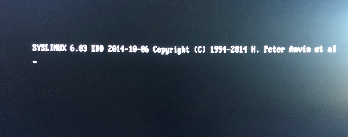

Last night I connected to my server to do a Plex Server Update.  When I connected, the top header was white vs. my personalized header and the only warning was showing drive space on one of my drives running at 97% (2T free overall)... all other notifications were green (pass).  Something was funky and coming from a Microsoft State of Mind (when in doubt, reboot)... I restarted the server.  Now it boots up sitting at 'SYSLINUX 6.03 EDD 2014-10-06 Copyright... ' (pic attached) and I cannot access from my other computers.
I wanted to check with the forum before I did 'anything'.  Any help regarding next steps would be greatly appreciated.  Hopefully just my USB key is having an issue and everything else is ok.  It is a Samsung 64gig USB3 (MUF-64BB/AM) and this server has been running happily for a year.
Try redoing the flash drive, backup the config folder, re-do it using the USB tool, restore the config folder.
That was the issue.  Yesterday I assumed it might be a bad flash drive and booted from an 'old' usb flash I had lying around and it booted up... only to find I did not have a USB Flash backup made 'after' I bought and installed my key  :(
So, I ordered a new USB flash from Amazon, which came today (next day on a Sunday... thanks Amazon :) ) .  Created the drive and everything booted up... YAY... although, registering my Key using the link I had on file, did not appear to work.  Then I took a look at the Old USB drive and the data on it was accessible.  I copied it over to the new drive and it booted up with all my drives setup happilly like nothing ever happend... BUT and it is a big BUT... It is telling me my key is Invalid.  What a PITA!!  So, even though I have the key file from the failed USB Flash Drive and the original link from my purchase, it is still forcing me to 'Replace Key'... Am I doing something wrong???

The GUID is a hardware feature of a particular flash drive so a licence is tied to the flash drive for which was issued.   Any time you change the USB drive you need a new key file that matches the GUID of that new drive.     Limetech allows for an automated transfer of a licence to a new drive once a year (which then blacklists the old drive).    If you need a transfer before then you need to contact the Limetech via email.
Did the key request and now I'm back up and running.  1st thing I did was a new Flash Backup!!  I also purchased an extra USB flash drive in case this happens again.
