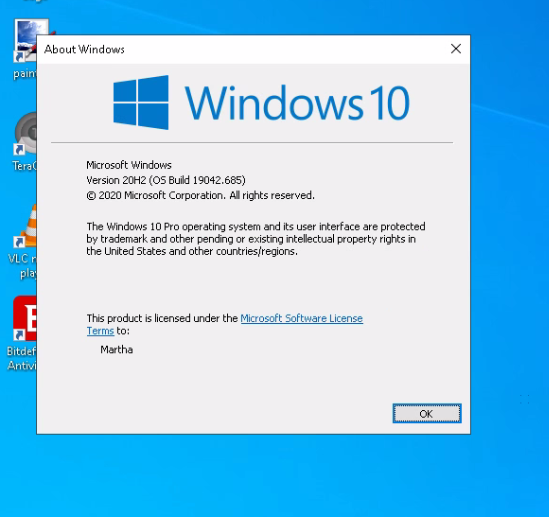

What version of Windows are your running?  (  winver  typed in search window of Taskbar will find this.)   What favor of Windows?   (Pro, Home, Edu, Enterprise?)   Did Windows recently do a 'feature' upgrade?  -- not the monthly security upgrade!

Version 20H2 so the newest one with all of the problems. This is the pro version.
Sorry, I was forced (by my ownn stupidity) to 2004, so I will not be of much help to you.  (I did find that the upgrade reset the access permissions to Windows public peer-to-peer shares.    Control Panel   >>>  Network and Sharing Center   > Advance share settings    But this did not affect access to Unraid public shares.)   Look at the last few pages of the thread that @trurl pointed you to.  Even if you have made these changes in the past, double check that MS did not reset them for you!!!!

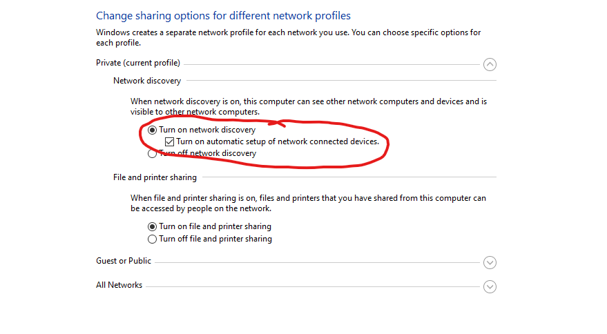

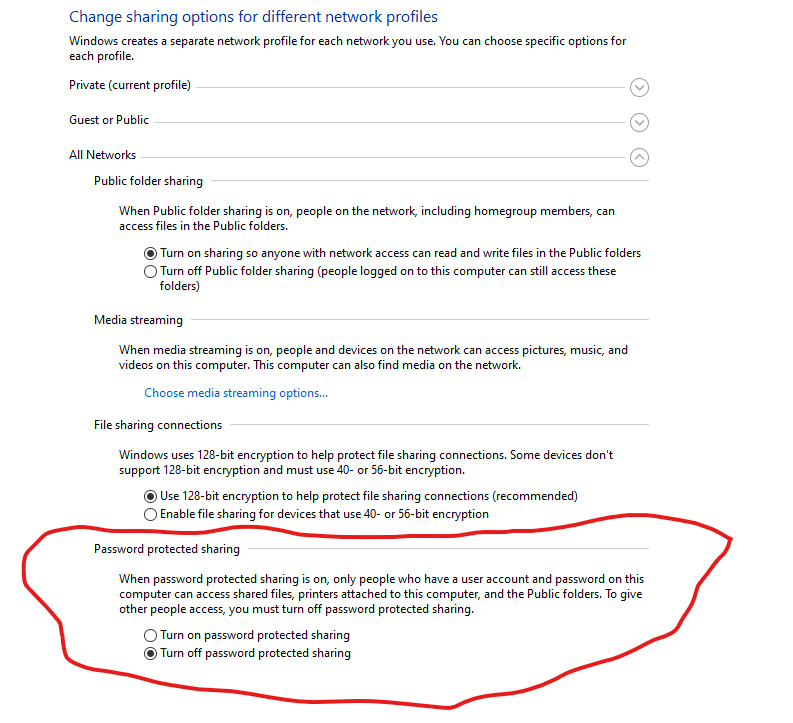

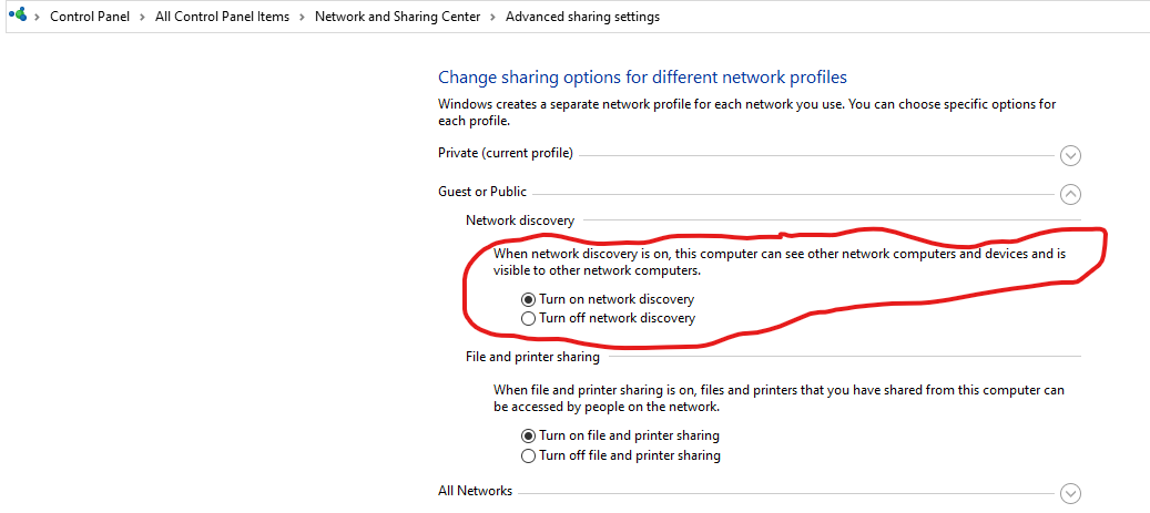

Make double sure that you have these turned on:
NOTICE that this allows your Windows client computer to see other Network computers.
NOTICE that this allows your Windows client computer to see other Network computers.  Observe that it appears in two different sections.   This seems to be the problem that you are having...
This last one in the 'All Networks' dropdown seems to imply that it could be a two way street.  You may well not be able to access other resources that are not password protected.
