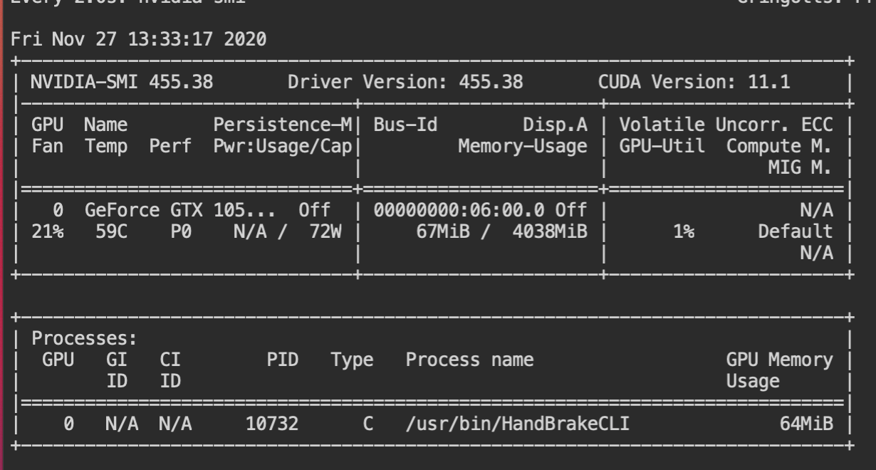

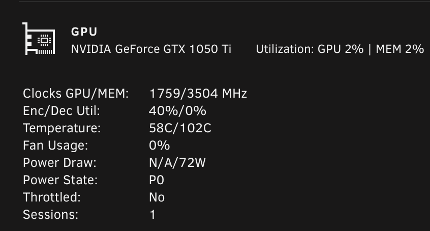

  10. Ah, wait, I do see it using the GPU now.

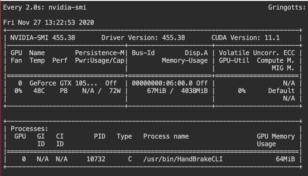

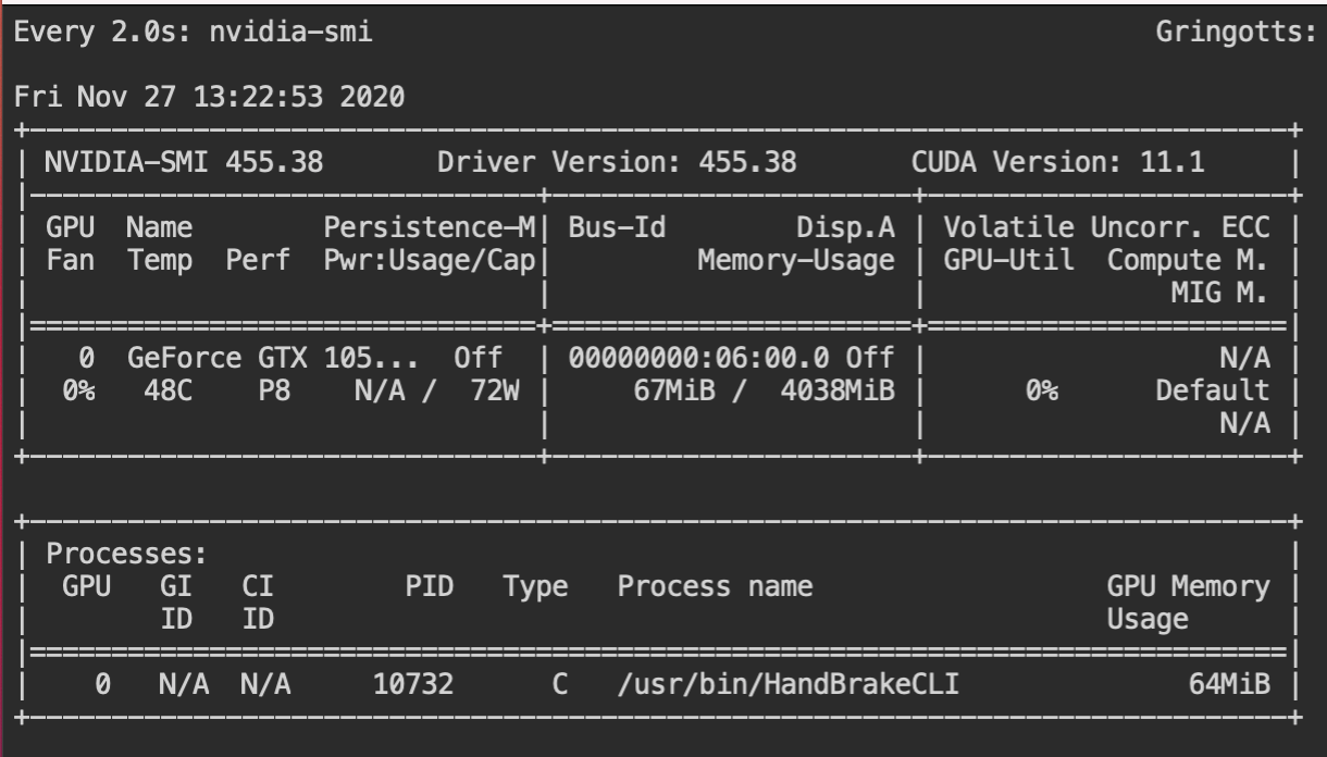

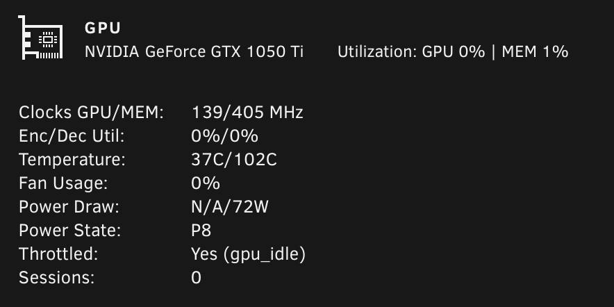

  11. I can see the PID, but zero utilization from it. This is an auto start, using these settings.

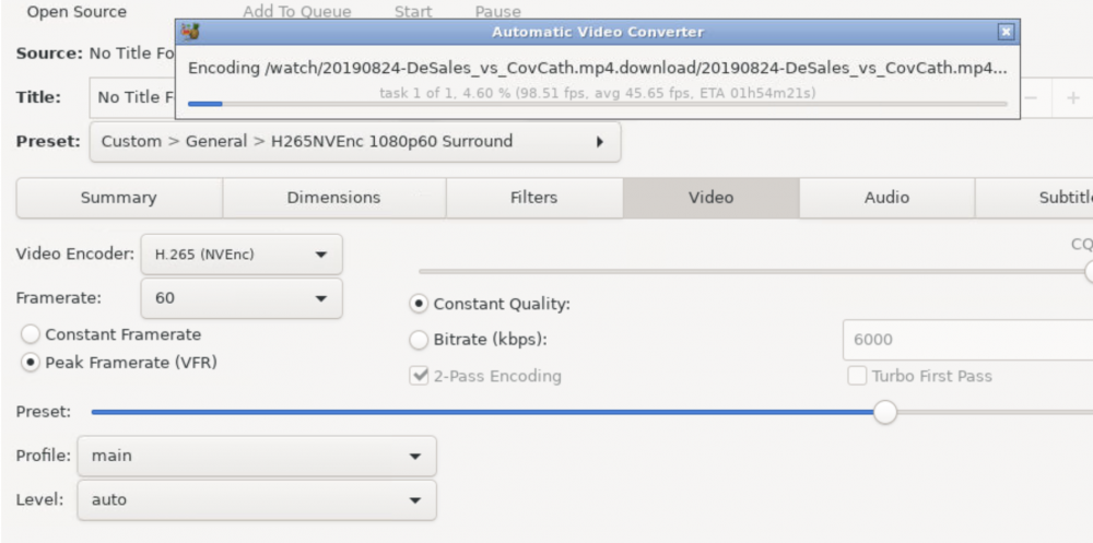

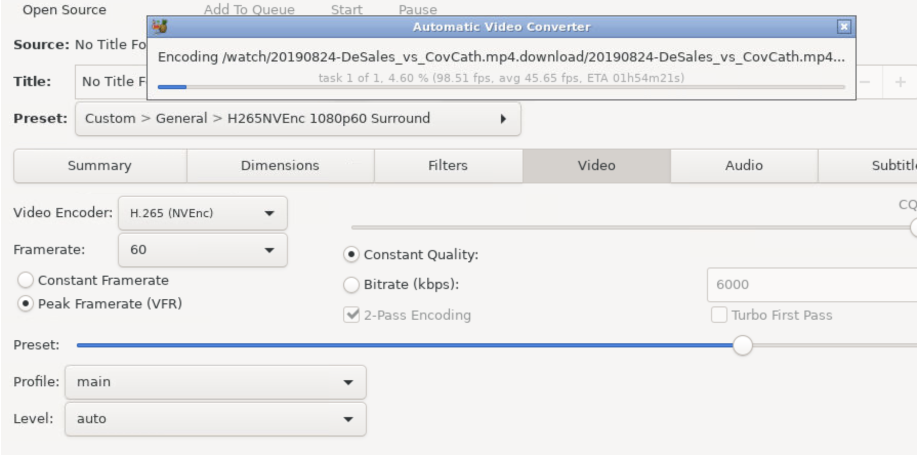

  12. it starts the process OK. I have to wait for it to finish and I'll let you know if it plays or not..

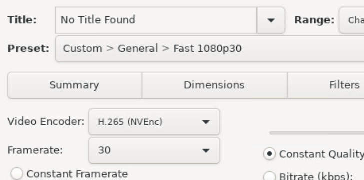

  13. I'm unable to get my Nvidia card to work with Handbrake on Unraid 6.9.35. It's working with Plex, so I believe I have it configured correctly. I am trying to use the H.265 NVEnc encoder. But when I look at my GPU stats, it says it's idle. I have host key 6 set to all (NVIDIA Capabilities) and the GPUUUID set in the handbrake docker image. I have also gone into the gui and tried several combinations in there, choosing both the h265 and h264 NVEnc encoding options. Nothing seems to work to engage my Nvidia card. Any thoughts? my-HandBrake.xml
