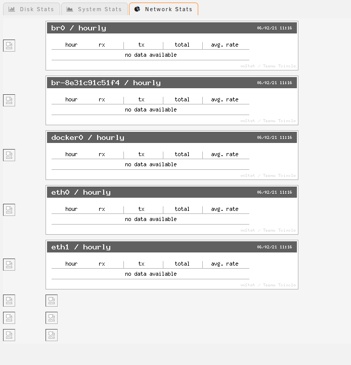

Can somebody support me in this case? My network stat get not complete displayed... Best regards, Phil
