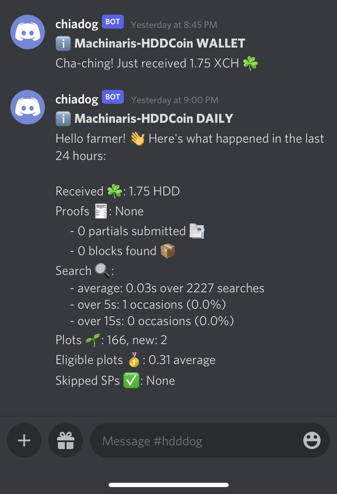

You might have received 1.75HDD. HDDCOIN ran a giveaway for folks who joined the hddcoin foxypool at some point in time. I also got a notification saying I got 1.75XCH from my HDDCOIN chiadog whereas what I actually received was 1.75HDD. Notice the first message.
