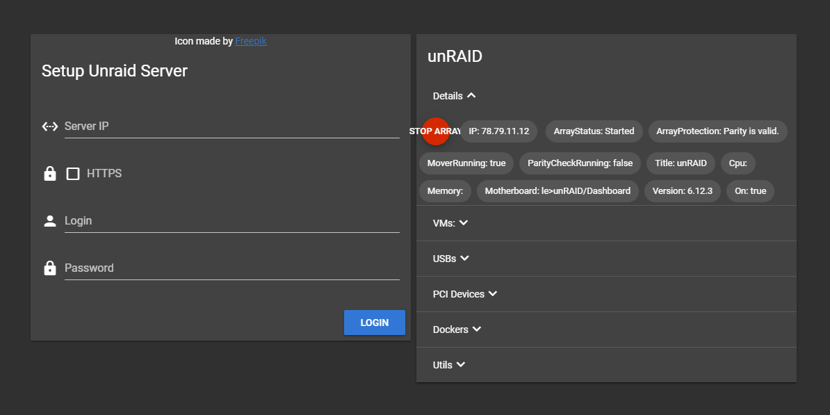

Hi! great Idea I also need an API (mainly for waking up the drives).
But beeing a newby with this api stuff (never used the original one before), I have some problems with the basic setup already.
It asks me for "Server IP", but my unraid is running on a different port. I've entered <ip>:<port> as usual and it seems to work a bit
but I am getting constant errors like
Jul 19 06:33:09 F nginx: 2023/07/19 06:33:09 [error] 13914#13914: *235440 limiting requests, excess: 20.753 by zone "authlimit", client: 172.17.0.5, server: , request: "GET /login HTTP/1.1", host: "192.168.0.4:800"
Jul 19 06:33:14 F webGUI: Unsuccessful login user root from 172.17.0.5
Jul 19 06:33:14 F nginx: 2023/07/19 06:33:14 [error] 13914#13914: *235463 limiting requests, excess: 20.229 by zone "authlimit", client: 172.17.0.5, server: , request: "GET /login HTTP/1.1", host: "192.168.0.4:800"
Jul 19 06:33:14 F nginx: 2023/07/19 06:33:14 [error] 13914#13914: *235464 limiting requests, excess: 20.229 by zone "authlimit", client: 172.17.0.5, server: , request: "GET /login HTTP/1.1", host: "192.168.0.4:800"
Username and password are correct, so I assume, it needs some other settings in unraid. or should i use somebody else (not root) ?
root will work fine, I am not sure about the errors, you are getting. Do you use a config folder?

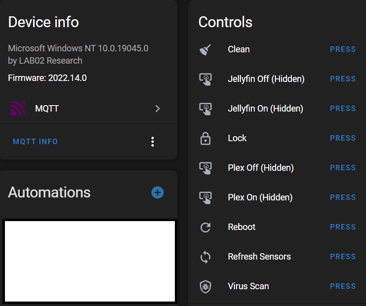

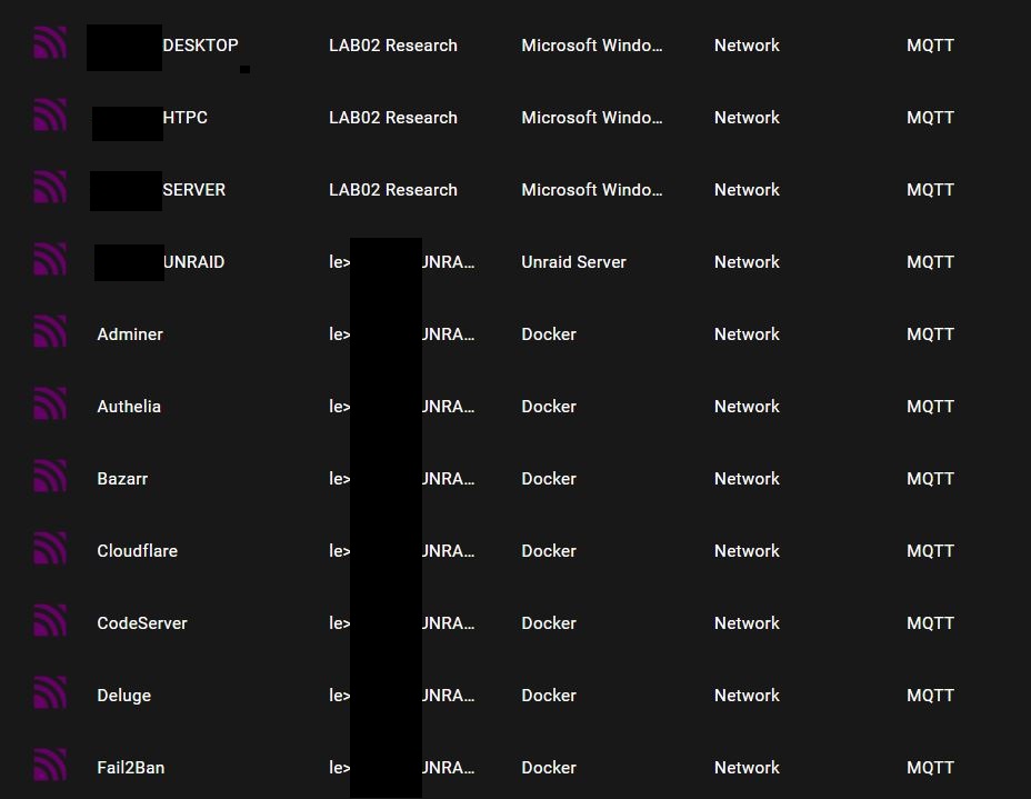

@Bokker
Some nice to haves, just if its possble. Im really glad that you fixed it as it is so everything else is icing on the cake.
Restart fix
If i restart HA the unraid api devices will go unknown and i need to restart urnaid api docker to get it up and running again. Old problem and  not a major issue. Is there something that can be done from Unraid APIs side?
Sorting
The dockers and vms is own devices under HA MQTT plugin, is it possible to group them under UNRAID mqtt device. I use HASS Agent for windows machines and that adds all sensors and switches under the machine. So my machine called Server gets for examble plex on and off buttons under itself, would be nice to get all dockers switches/sensors under Unraid. Its just less cluttered and is easier to find stuff.

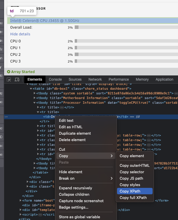

I am looking into the option of grouping the mqtt devices into a single device. Currently only found this https://community.home-assistant.io/t/how-to-group-entities-into-a-device/262600 without luck of it working. Only a single device shows up.
Also looking at fixing the missing/broken properties, like cpu/motherboard/ram. I will need to change the way we extract the data from html dom, currently the project just uses string.substring() manipulation. I am looking into a way using xpath.
There might be better frameworks for selectors in nodejs/xml that I am not aware of.
Preferably the selectors should be editable from the UI (loadable from a config file). In case there is a new version, users should be able to fix the broken properties themselves just by replacing the selectors.

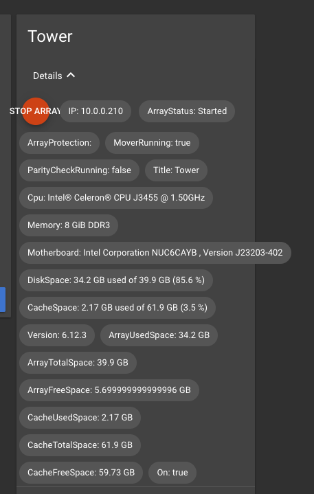

I updated the master and the 6.12 branch, currently this is the info I get on my test device. The grouping seems to work also on my device, but I havent done any changes there, maybe the other changes fixed the HA groups
Edited by BoKKeR
Parsing is better, unraid UI is smooth again, although "MoverRunning" is still always true and I still get 153 separate MQTT devices
Edited by Kilrah
I think the old devices dont disappear but there should be a new device with grouped entities. Could you double check
No I had them all removed, there was no unraid-related device in HA until I started the new version
Also scratch the unraid UI being smooth, that only lasted a few minutes. Seems it goes from being smooth to slow and back to normal repeatedly...

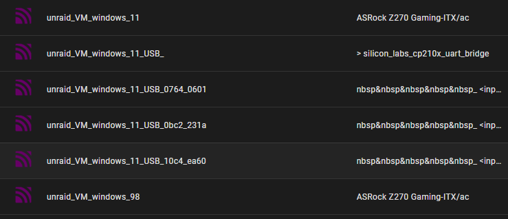

It may be having issues with the USB plugin that adds a page to the UI, I get all USB devices to each VM with broken parsing
image.png.b743b24e0dd048631999593283369318.png image.png.72256356458e66ffd5da94152ef0c0fb.png
The usb device names get scraped wrong, will have to check on that, its unrelated to the usb plugin
