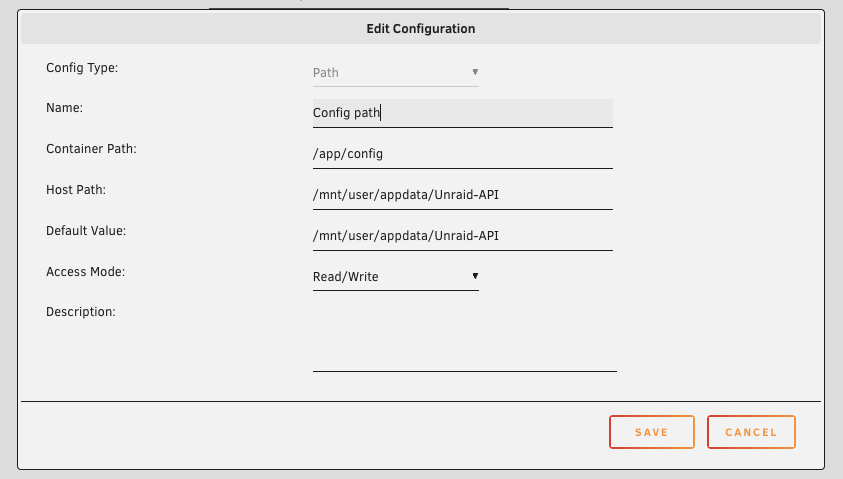

6 minutes ago, Puntoboy said:
6.12.10
I don't see that path on my server. This is my container setup.
Also you are running the tag 6.11 with unraid 6.12. They have to match

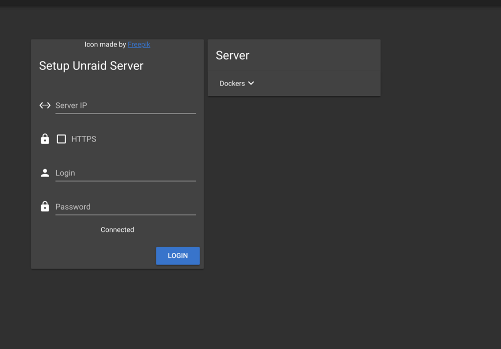

I've just seen there was an update for the Docker container, so due to my issues, I've updated it. However when I access the web UI the container stops.
To see if there was a problem with the Unraid container, I deployed the one on HA. I get the same now, only seeing the single docker container in the WebUI (no other details about the Unraid server) and I've seeing these errors in the logs. When I restart the add-on the Unraid server details disappear. I assume something to do with this?
so the two issues I have are:
1. The Docker WebUI only shows the docker container status.
2. Home Assistant isn't getting any MQTT data (I can see the successful connection, but that's it)
