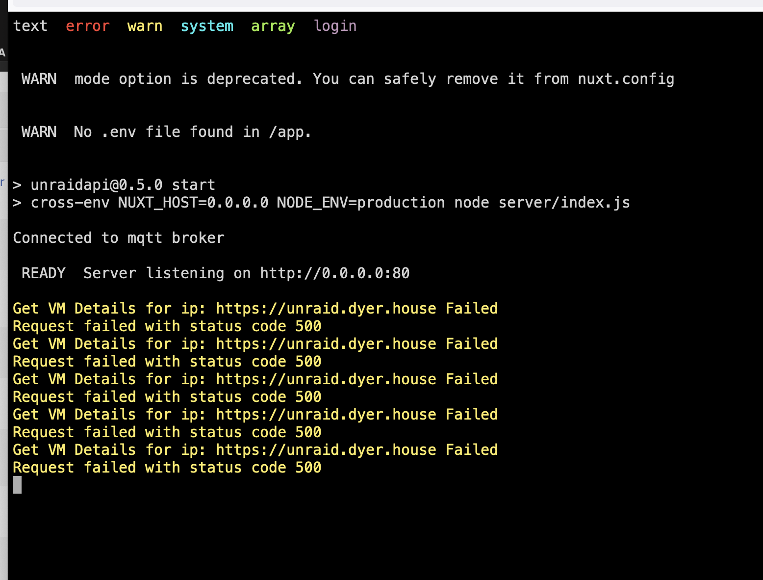

Both, disabled in settings and I dont have any

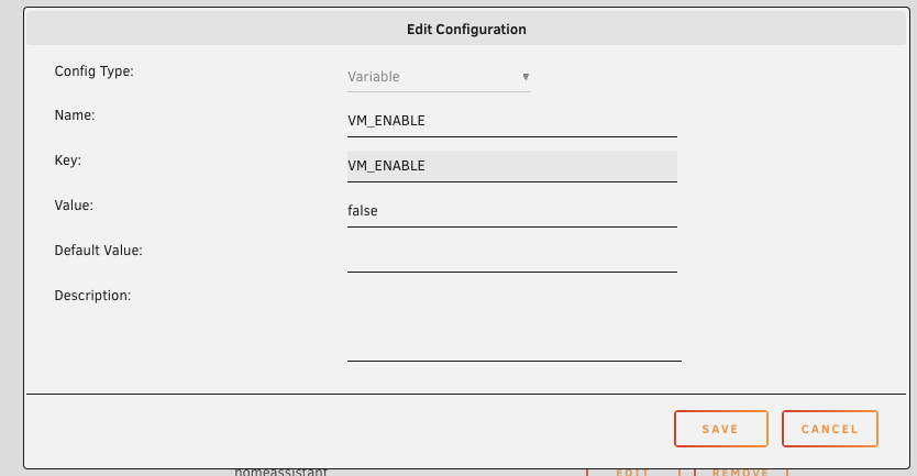

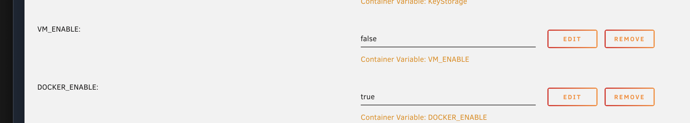

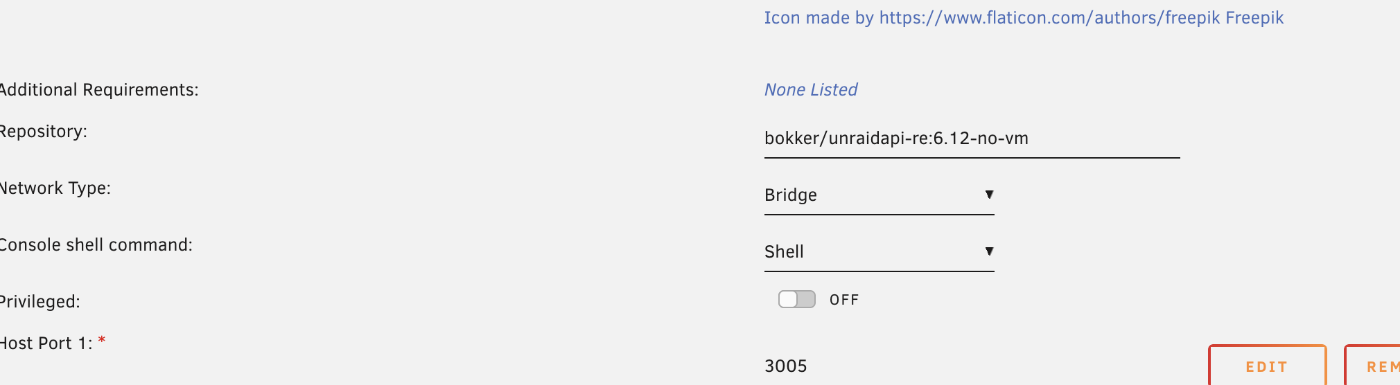

Could you try the following tag: bokker/unraidapi-re:6.12-no-vm
I added the following 2 variables which can be set to false using docker env variables
VM_ENABLE, DOCKER_ENABLE
This should disable VM checking for you. I will have to do more work on it, since I think its possible to have this work just by detecting if the VM tab is available or not in the UI, without using the env variable.
Still getting the error here is my config
Did you change the tag ?
yes

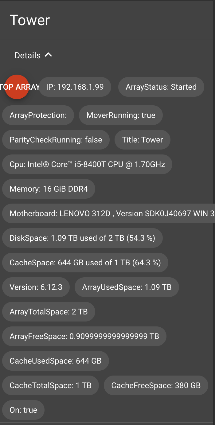

On 8/13/2023 at 8:44 PM, BoKKeR said:
Do you get the free space data in the unraid-api dashboard? I will have to look into mqtt grouping.
yes i do friend
