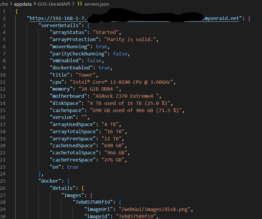

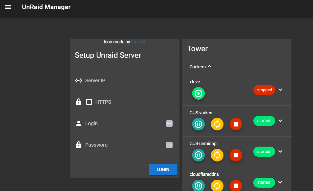

hello I can't connect through HTTPS
I can see this in logs:
getaddrinfo ENOTFOUND
I put the long address ended in myunraid.net
Any help please?
Thank you

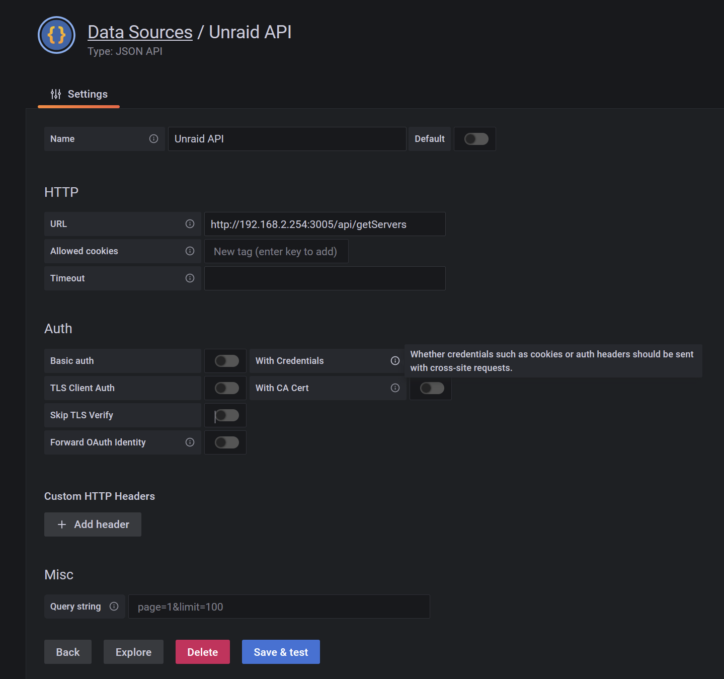

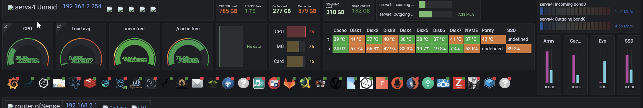

Did you do anything special to get this to work? I am having trouble adding the data source to Grafana.
I am following the guide here: https://github.com/HStep20/Ultimate-Unraid-Dashboard-Guide
Which details how to add the data source below:
UnraidAPI
Hit 'Add Data Source' and choose an 'JSON API' data type
With the containers being on the same docker compose network, we can refer to them by container name in URLs.
Top fields:
URL - http://YOURSERVERIP:YOURUNRAIDAPIPORT/api/getServers
Note: The default unraidapiport is 3005. If you did not edit the docker-compose.yml, set the port to 3005
When I do this, I am presented with the following error:
JSON API: Internal Server Error
Any advice on how to get this to work?
Data Source: Type: JSON API
Data Source Config:
my server is on 192.168.2.254
port of the api: 3005
So the URL must be http://192.168.2.254:3005/api/getServers

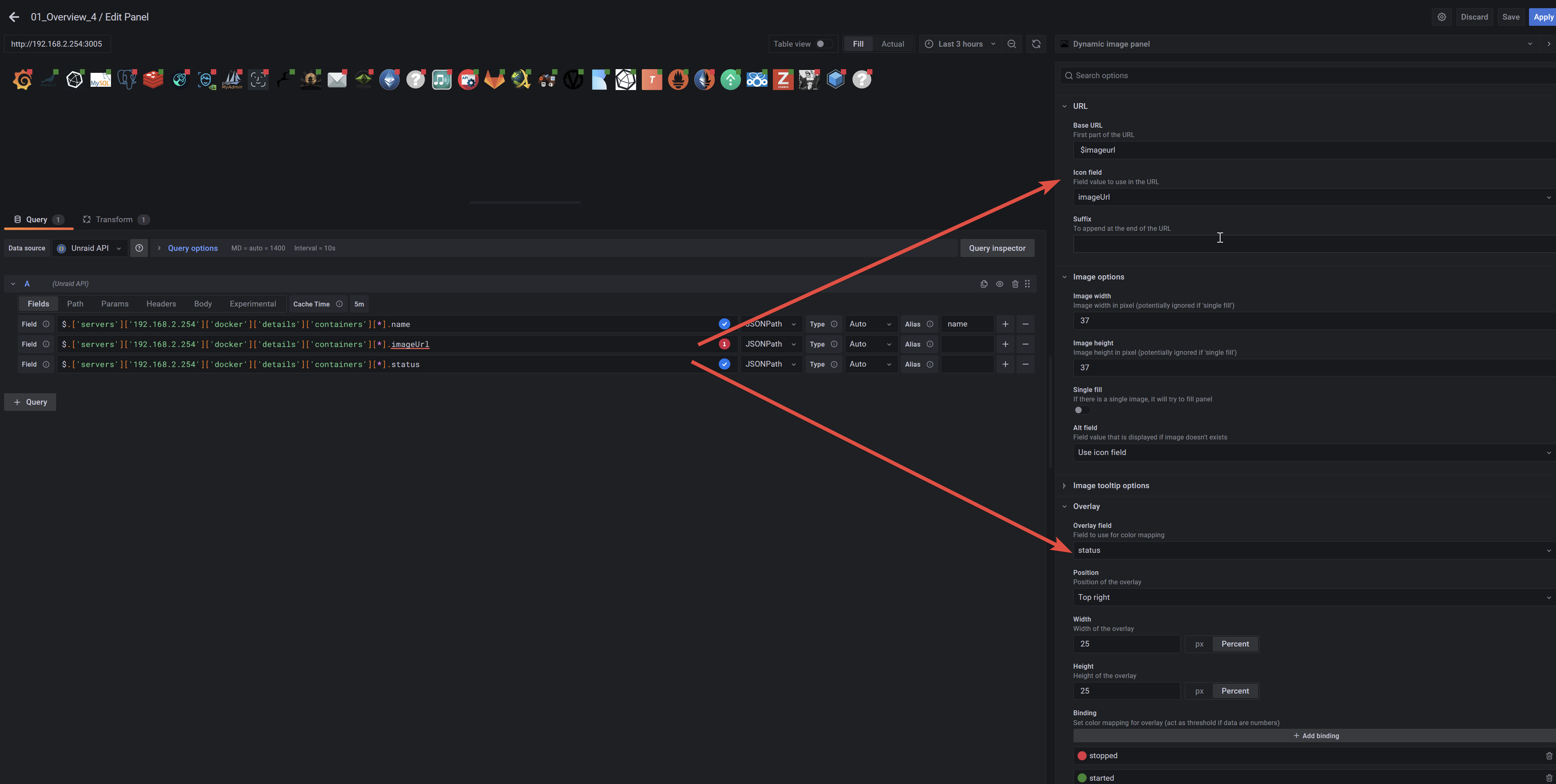

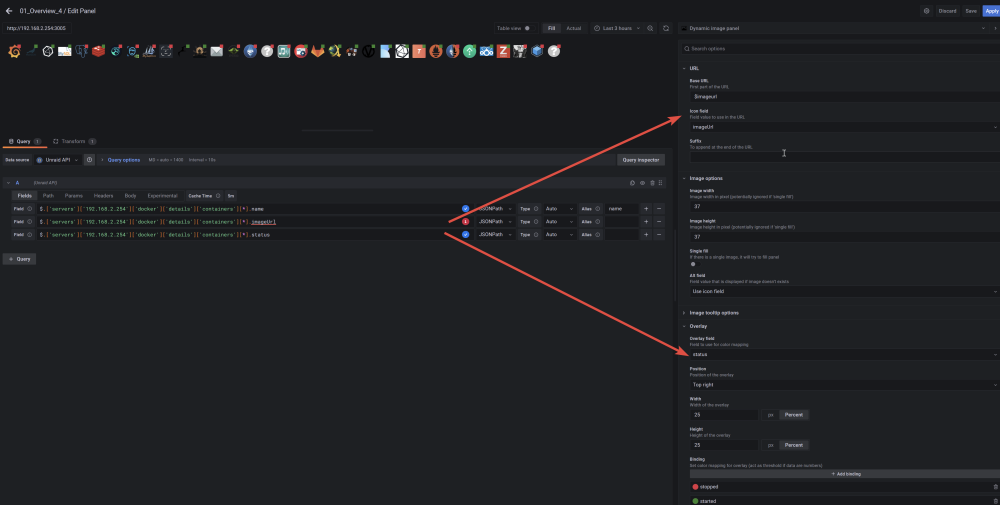

Grafana Panel Config for Docker Container:
Panel https://grafana.com/grafana/plugins/dalvany-image-panel/
use your IP!
$.['servers']['192.168.2.254']['docker']['details']['containers'][*].name
$.['servers']['192.168.2.254']['docker']['details']['containers'][*].imageUrl
$.['servers']['192.168.2.254']['docker']['details']['containers'][*].status

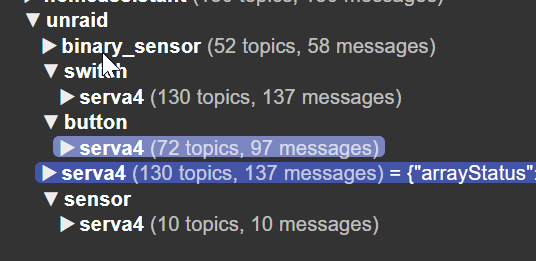

I'm looking for a way to filter what is published via mqtt to not clutter up my home assistant with dozen of switches again.
Sadly with autodiscover ON in HA I can't filter which devices are discovered.
With autodiscover, it woudl create 130 switches, 52 sensors, aso.
I found the mqttDisabledDevices.json in the appdata folder, but no documentation or example how to use this file.
In the end, I only want to have 2 docker container controlled via HA and don't want all the information inside HA.
Edited by corgan

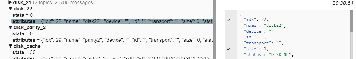

switches are not working, mover status is constant true and parity status is not working either.
Thank you.

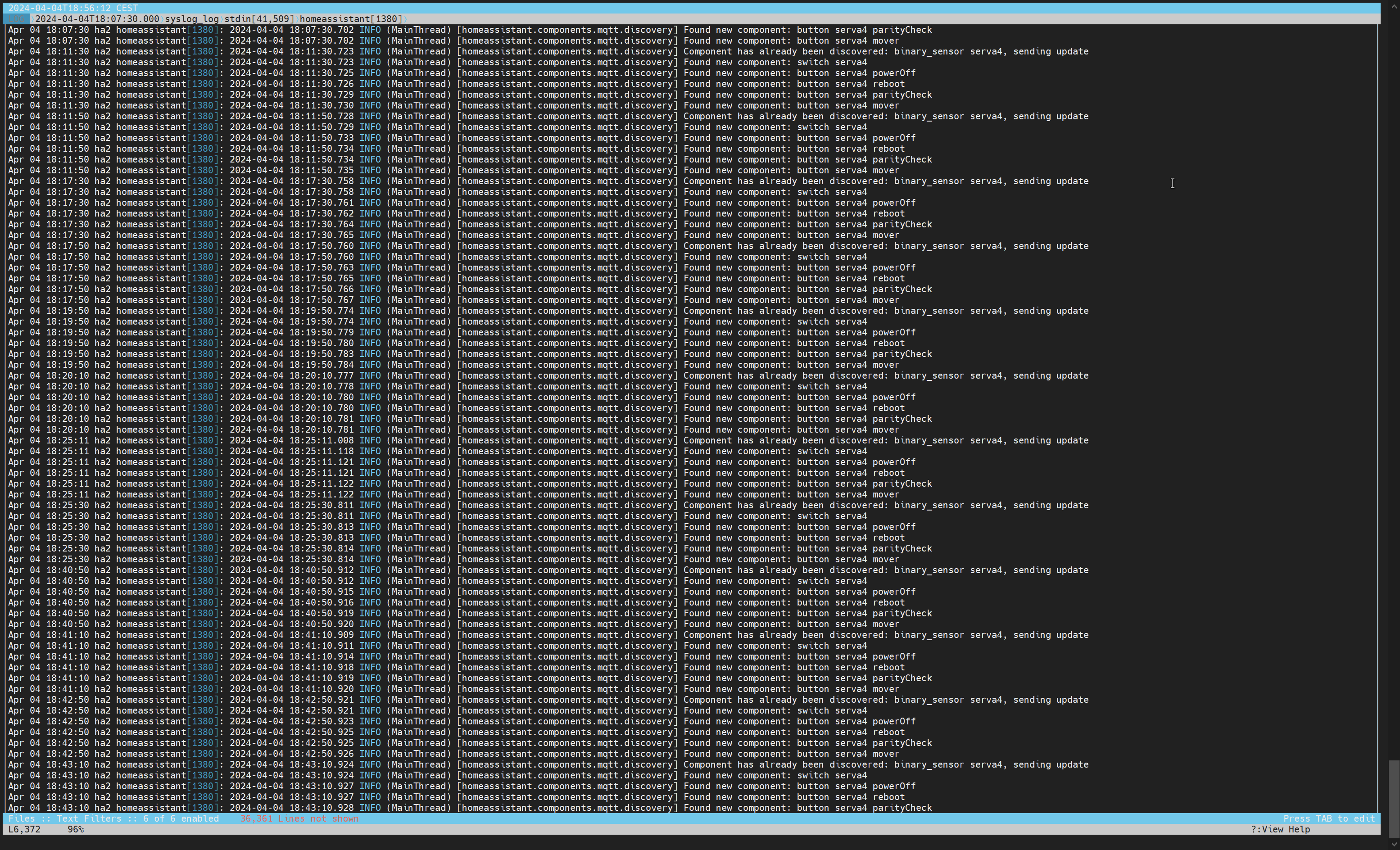

I have some questions regards the update interval. Is there any rule that defines how often components are updated?
Sometimes it takes forever after a Home assistant restart till the components are available, and sometimes there are dozens of updates in one minute.
And is there any way to request or trigger an update?
Is it an expected behavior that the API sends the discovery message over and over, or is there something broken?
For me, the API sends all sensors from the server, docker and the VMs. I don't have broken entities after discovery.

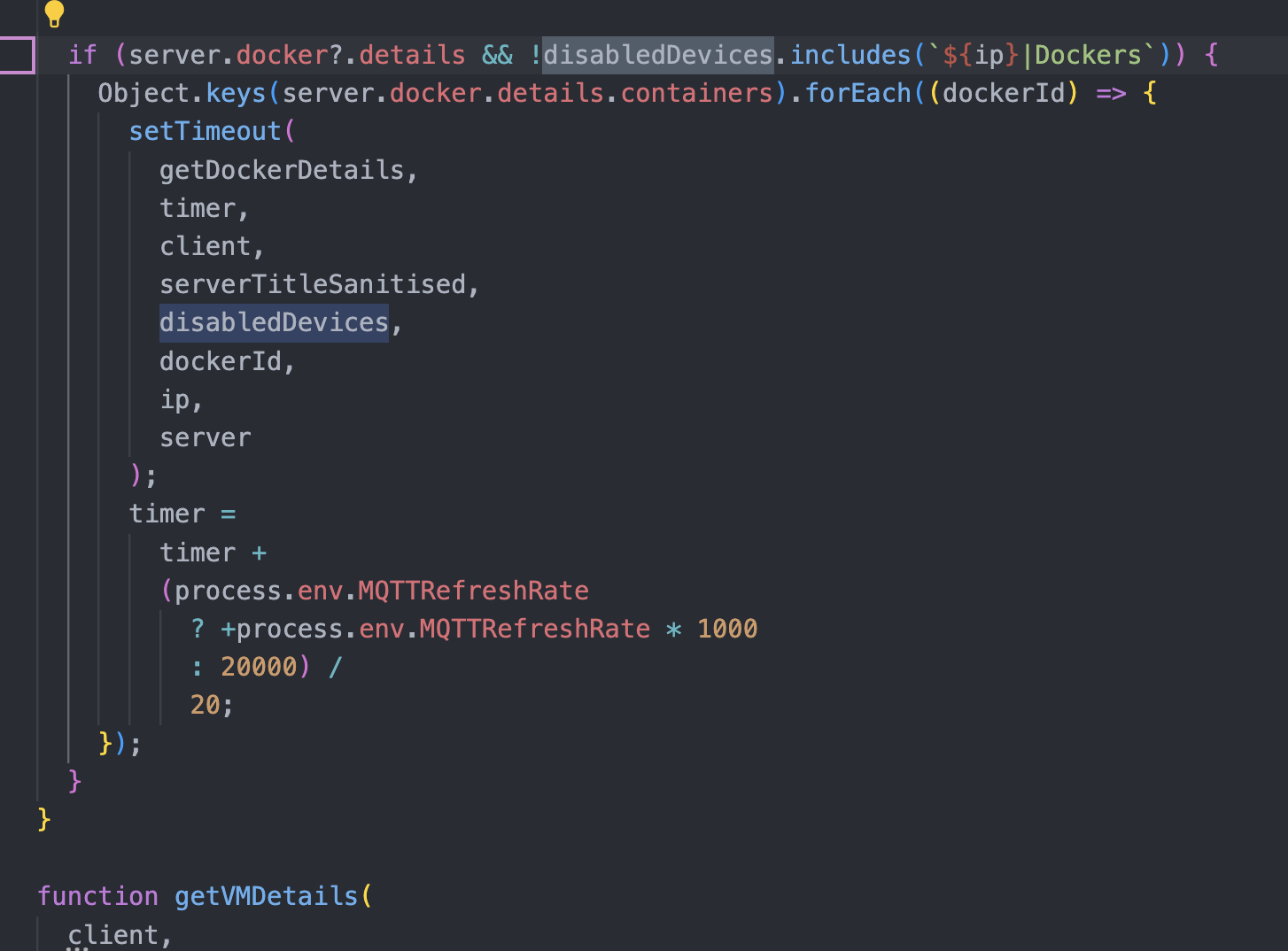

@corgan I am not sure how mqttDisabledDevices.json works,
It looks like you can disable docker for a full host, but not really specific containers?
I could look into disabling auto discovery since its quite messy with the docker containers... I am also not sure if the discovery feature is broken. I have not touched it from the old project and frankly I am not sure how that feature should behave. I will have to do some research or you can fill me in on the details if you have experience.
The update intervall can be possibly adjusted with an environmental variable `MQTTRefreshRate` also seen on the screenshot.

Is there no way to slow down the polling frequency of the disks? Every 30 s is way too fast for me, my server rarely changes over a day or two.
Also, is there really no way to prevent unneccessary entities from the MQTT queue? I have 4 disks + a cache drive but the API seems to think I have 23 or so...
Edited by emilgil
No granular way to set polling on each feature, you can slow down polling as a whole by changing MQTTRefreshRate=20000

34 minutes ago, BoKKeR said:
@Puntoboy what version are you running of unraid?
The config folder is the one thats set in the template, probably
/mnt/user/docker/Unraid-API
6.12.10
I don't see that path on my server. This is my container setup.
