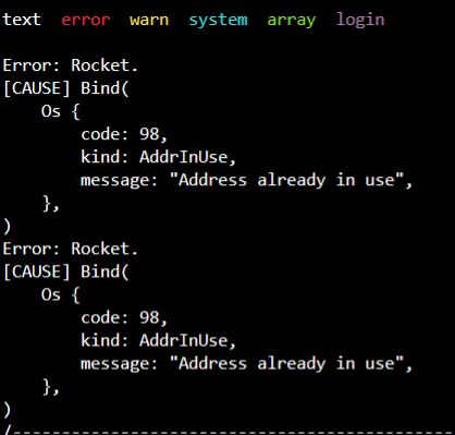

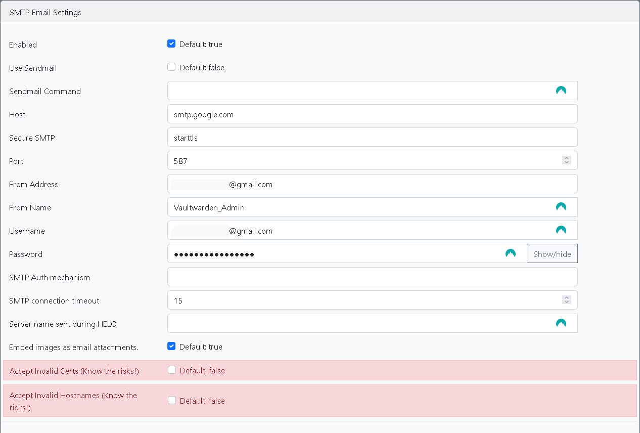

Many thanks! Changing to smtp.gmail.com did the trick. It works under reverse proxy and bridge now. Although the container does not start under host at all, showing an error "Address already in use"

Hello guys, I have installed the Vaultwarden for the first time with a SWAG reverse proxy. I can access the server's webUI from Internet, but I am stack on SMTP settings. I set up SMTP with my Gmail App password at the Vaultwarden's Admin setting page as per screenshot. Then I get an error "Error sending SMTP test email SMTP error: Connection error: Cannot assign requested address (os error 99)" I googled this error and tried many things as another App password, "force_tls" with the port 465, "Plain" and "Login" and so on. I also tried another mail service with the same result. Could you please help me to find out a SMTP error root cause?

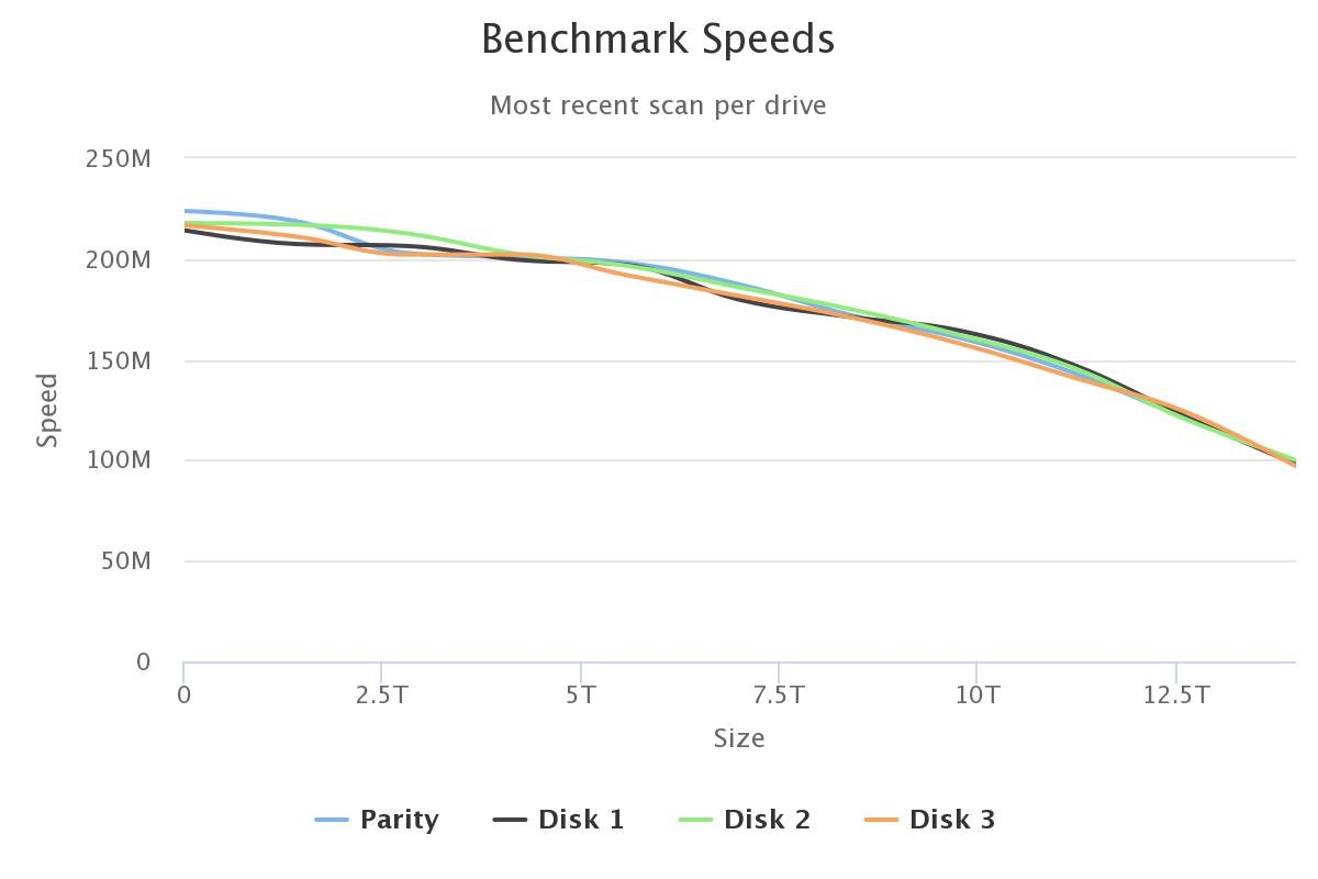

Thanks for the reply. I was just wondering what these lines in the log may mean? I switch off the server daily as there are no overnight tasks and also in order to save some electricity, which became 3 times more expensive in Europe. As for the benchmark, it did not show any significant difference between 4 drives. I will do the parity check next time and post an update with the diags if it does not improve.

Hi to everyone! There is a question about a hard drive and a parity check speed. May be these issues are independent, I cannot say. The array is 4x14TB WD White from WD Elements. 3x WD140EMFZ-11A0WA0 1x WD140EDFZ-11A0VA0 They have been working a little over 2 years without problems. I noticed that for the last 2 monthly Parity checks it took 4 hours longer, since the average speed fell from 158 MB/s to 136 MB/s. Action Date Size Duration Speed Status Errors Parity-Check 2023-03-06, 16:34:51 (Monday) 14 TB 1 Day, 4 HR, 3 Min, 57 Sec 138.6 MB/S OK 0 Parity-Check 2023-02-03, 02:47:57 (Friday) 14 Tb 1 Day, 4 HR, 30 Min, 12 Sec 136.4 MB/S OK 0 Parity-Check 2023-01-07, 07:53:01 (Saturday)14 Tb 1 Day, 30 Min, 26 Sec 158.7 Mb/S OK 0 Parity-Check 2022-12-05, 09:06:33 (Monday) 14 Tb 1 Day, 25 Min, 40 Sec 159.2 Mb/S OK 0 I checked the logs of the discs, the WD140edFz showed the following entry twice in the log "kernel: ata7.00: supports DRM functions and may not be fully accessible". WD140emfz does not have such lines in the log. HW is all the same, I did not change anything in the config either. Bios has been updated in early December, before the last quick parity check. I tried to google it, but did not find an understandable answer. Could you advise me, what may this mean and how to deal with it? Could it be the SATA cable issue leading to both slower speed and errors in the log?

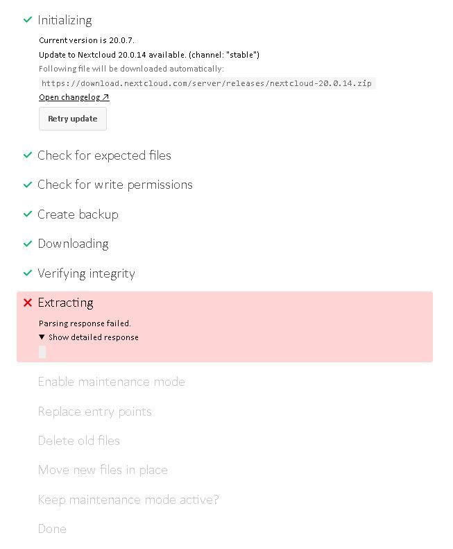

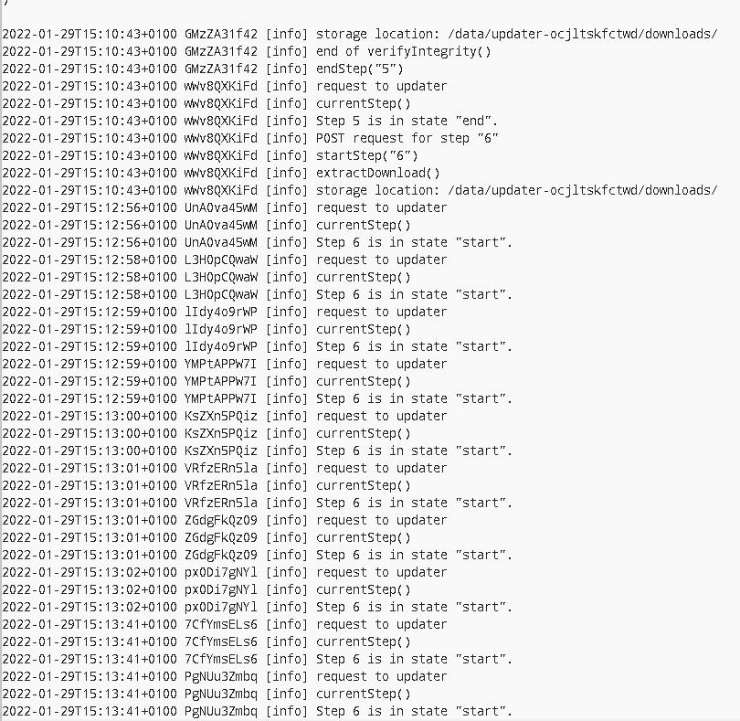

Hi guys, I have got an error by updating Nextcloud from 20.0.7 to 20.0.14 for some reason. I checked the updater log and it says that I am stuck on the step 6. Restarting does not work. I tried to change in the config file Maintanance to "false" and also deleted ".step" file in the updater folder, but it does not help. After that I need to change update secret in the config file and the process repeated with the same error. Sometimes in the detailed response in the red field it shows "Step 6 is currently in process. Please reload this page later." I am stuck Could you please advise what else can i do? I'd prefer to avoid reinstalling to secure that the user data is not deleted. Thanks in advance

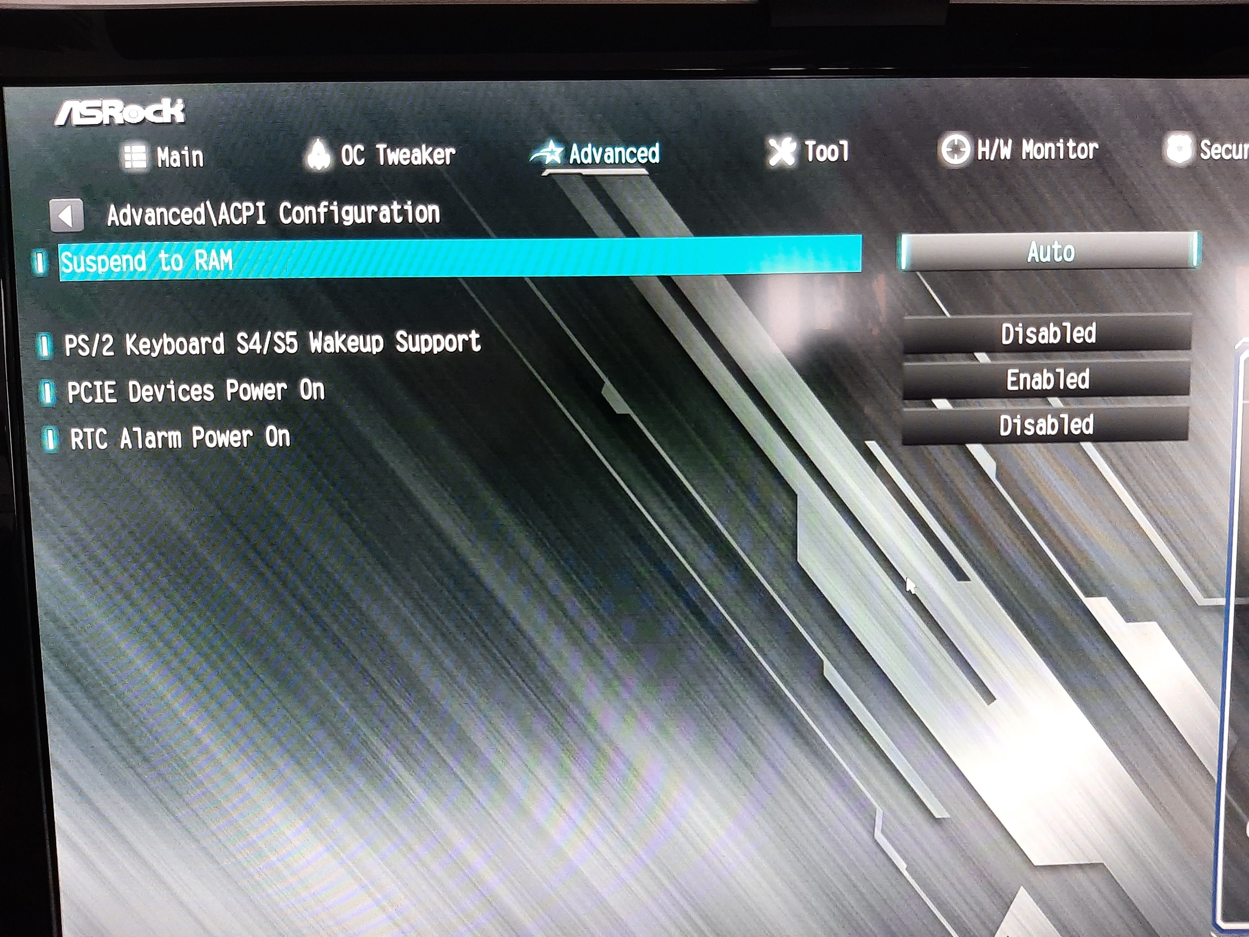

I got the final response from ASRock on the non-working WOL from PCIe devices. They confirmed that X570m Pro4 does not support it, despite of the specification for the Motherboard on their website: Here's what I received exactly: "got final feedback from headquarter: After checking with BIOS and HW RD, we found it is a compatibility issue between X570M Pro4 and some specific LAN card. We also verify AMD reference board and it also has the same problem. If User would like use the WOL function, please help to ask user using the onboard i211 LAN." PS: WOL is works well on Gigabyte x570 motherboards. I checked it with the MASTER edition.
WOL on 10Gbe NICs (Intel X550 & AQC107)
There is nothing else in BIOS settings of x570m pro4 for WOL. Actually only Intel chips provide additional section in BIOS settings. I have this option with N/A on X550, just like you shown. But Intel's 10Gbe NICs have no WOL at all. Only if I activate "Boot from LAN", I see additional options for DHCP of NICs, but it had no influence on WOL functionality. My new MB from Asus is already on the way and I will check WOL on it. Another thought is to get the Asrock MB replaced by the same model through the Asrock support.
