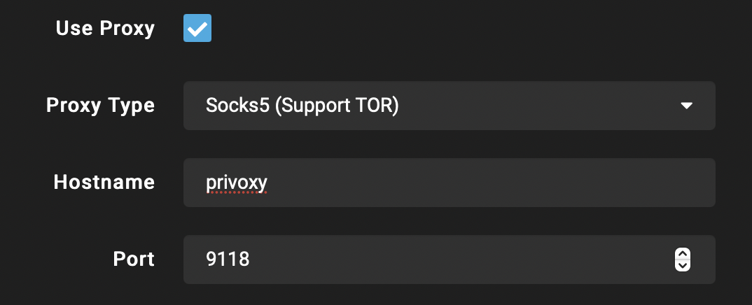

  7. Where previously it was possible to use link, I believe the expected way to do this now is to have the containers on the same docker network. You'll have fun trying to get them to talk on something like a macvlan network, so I'd stick to Bridge to keep things simple. So, sssuming your primary Bridge network is called br0 they would both be on br0. Then, as docker dynamically assigns IPs to the containers when they start, and these local IPs don't always persist, the best thing to do is refer to the containers using the container name as a host name. Assuming you're trying to get Radarr to route via a binhex-delugevpn's Privoxy: Make sure both containers are on the same Bridge network so that they can see each other. Find the container name (Assuming privoxy but it's probably binhex-delugevpn) and port (Assuming 9118 for Socks5) Visit Radarr's WebUI > Settings > General > check Use Proxy, and enter the details from step 2: You'll want to use the same configuration for the Downloader, etc. as well. There is multiple ways to do this, but this is (I believe) the developers' intended way for users to set up this kind of network. Once you have it set up that way, the GUI should be visible while Radarr routes it's traffic via Privoxy. It's a similar setup for the other containers mentioned as well. Unless you're trying to use Privoxy as a reverse-proxy and I'm missing something? In case anyone is interested, here's the page in the docs that talks about using --network container:name
