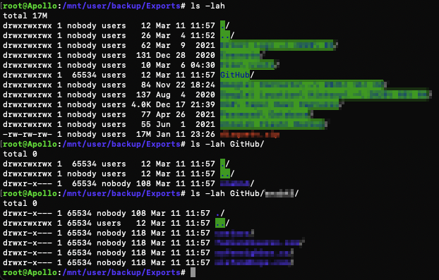

Not sure if this is changed or something weird on my end, but I just installed this and by default my GitHub folder is owned by "65534". The folders inside it are part of the group "nobody" so I think something went weird, like an overflow.
I ran
sudo chown -R nobody:users -R GitHub/
But after restarting the container it just went back to 65534:users
I just saw this docker today in the community apps spotlight but it looks like it hasn't been updated in a year and no responses here. Is this project abandoned? Do you need someone to take it over?

For me its shows owner and group as nobody. Which meant i cannot access the folders via SMB. I think the group is supposed to be "users". After changing the group it worked for me.
I also tried to set the PGID in the container but it seems it doesnt make a difference.
