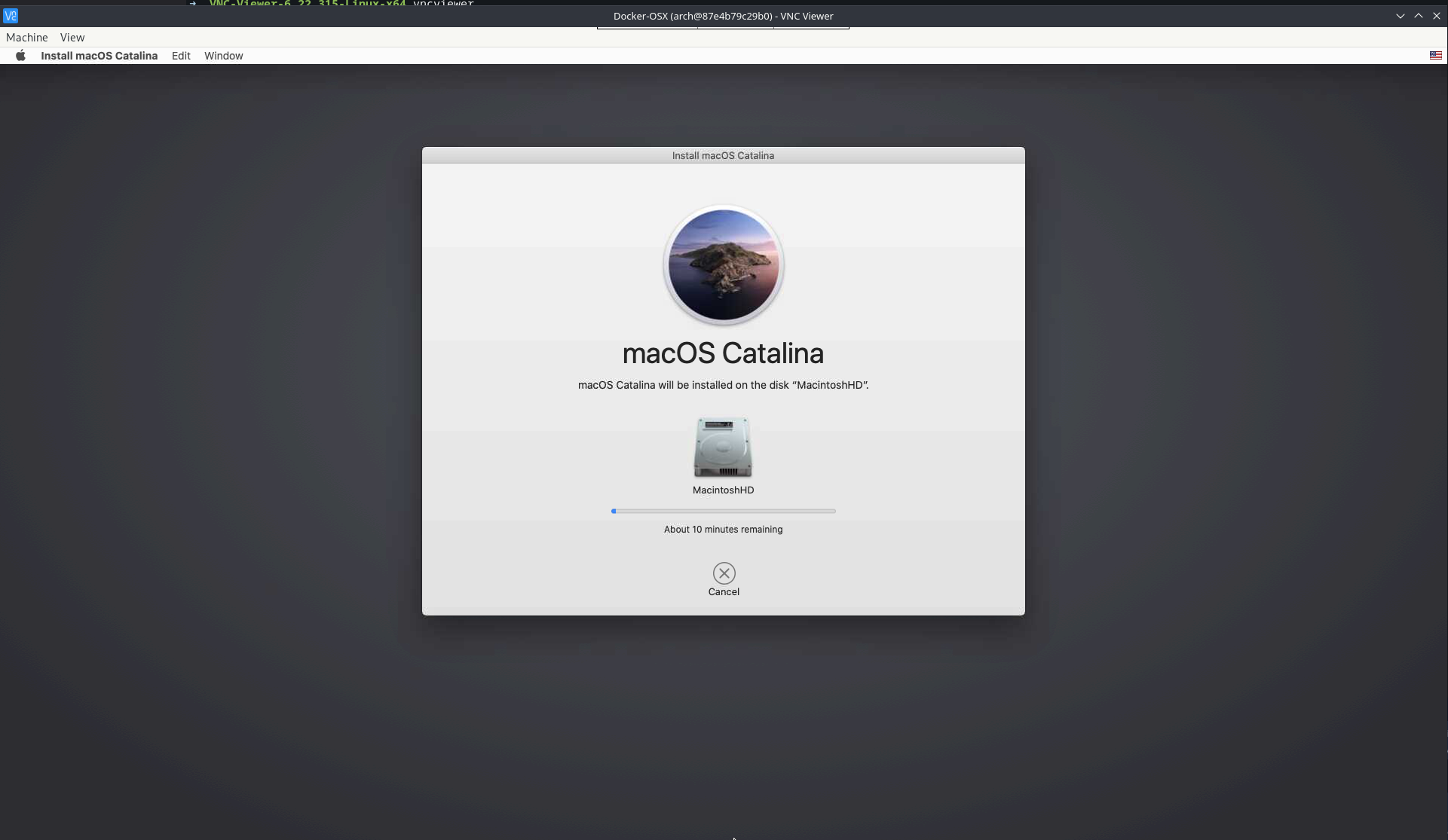

Oh my god.. Not only is this container amazing, I got it to work! ☺️
For anyone interested, it's not too difficult. I had to set some permissions, clone the source and build the vnc-version but it works.
