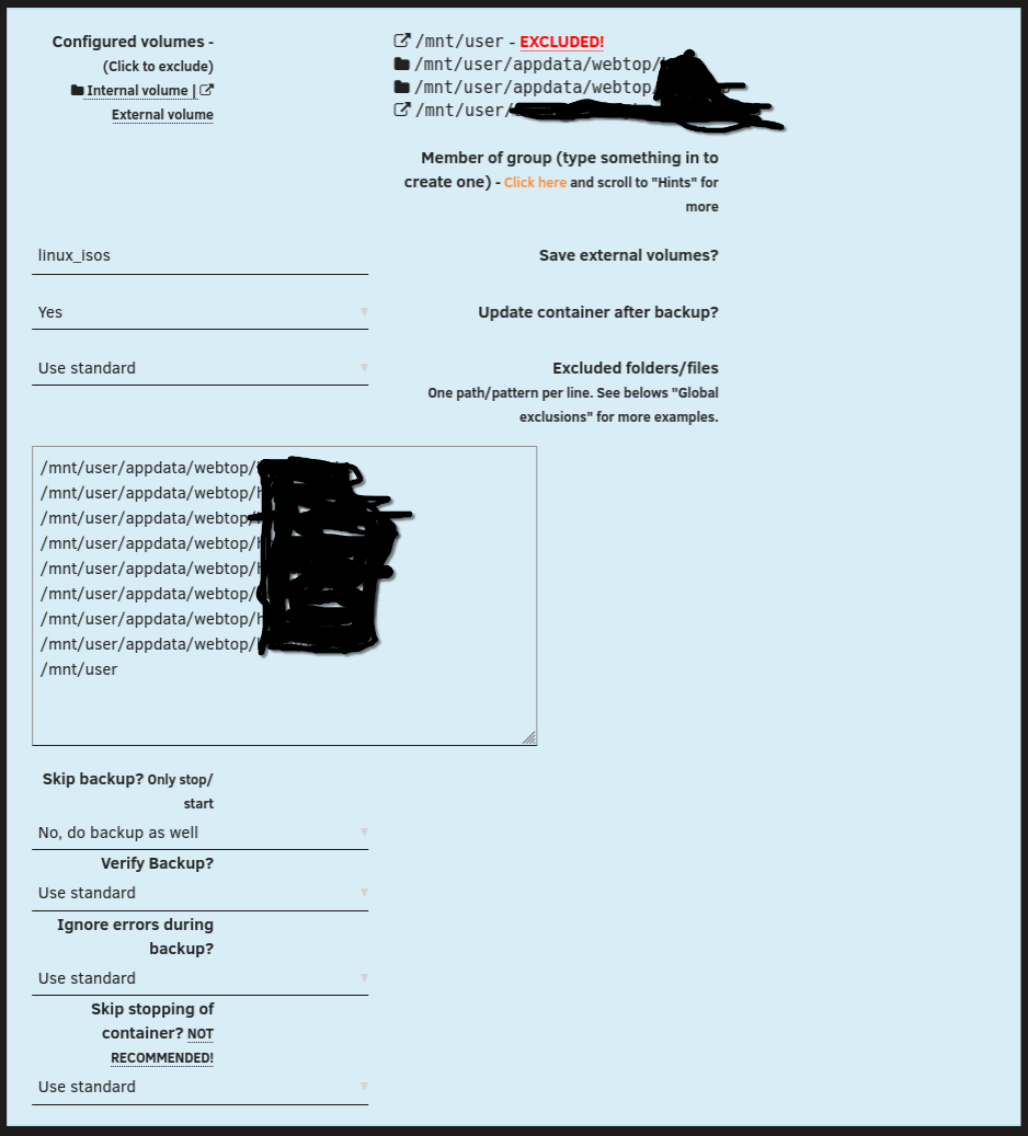

  2. I have a container that has always failed to backup and I finally tracked down the root of the problem, it's with the tar command itself but I have a workaround that the plugin's cleanup logic is preventing when saving. The config for that container I have Save external volumes? set to yes because I want one of the external volumes backed up, but that means I need to exclude /mnt/user obviously. I figured out the problem with tar is the --exclude '/mnt/user' by taking the Generated tar command from the logs and by adding a trailing / it works. I have a feeling it's because of the /mnt/user0 folder, which I'm not sure why that exists but I'm still troubleshooting that. The problem is if I change the line in the UI to /mnt/user/ when I save it goes back to `/mnt/user` For now I've disabled Save external volumes? and have a separate script handling the one external volume, but I don't like that solution long term

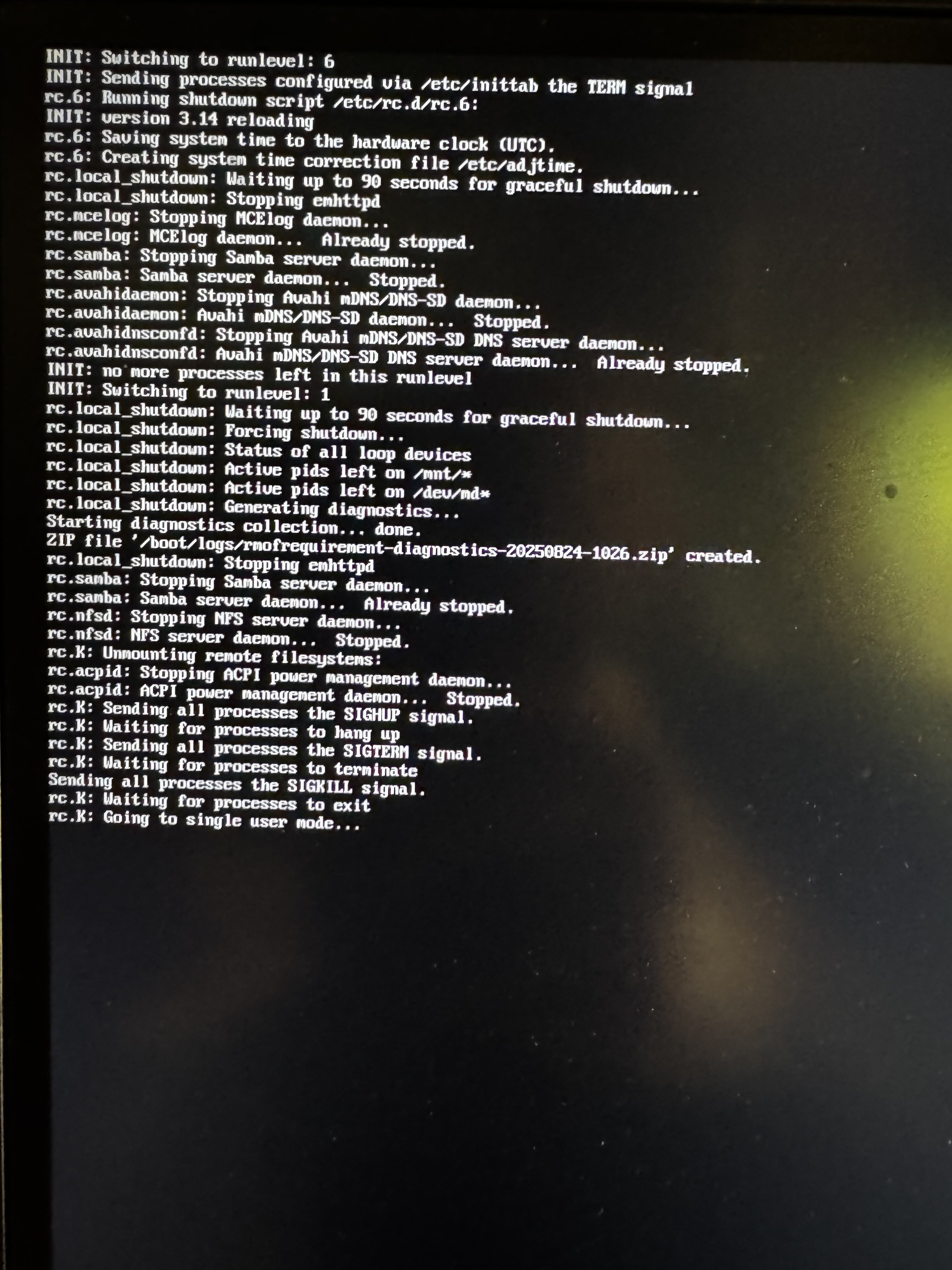

  4. I've been having this issue a lot lately but it got really bad recently, just had one take longer than the 15mins my UPS had and seems to be the cause of corruption on one of my cache disks. I've already looked at my array stop times, that's under a min so it's not any of those causes Today has been the worst case. While in safe mode to work on recovering my corrupted drive, my array shut down very quickly and 10 mins after that with nothing in the syslog I logout of the directly connected gui, ssh in and run 'shutdown now' from terminal. Nothing in the syslogs for a few mins other than from the shutdown command. Then after a few mins, all happening in less than half a second, the syslog is inundated with the same line repeatedly 'publish curl to diagnostic tool failed', the gui session ends, my ssh session ends, and the direct monitor connection goes to the console with minimal logs (attached photo). After all that I wait another 20mins of nothing written to console, short press power, nothing, repeat a couple times. Wait another 5mins, still nothing new on the console and just gave up and did a hard reset
