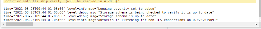

  12. Got this set up, ran through the config guide, and when I try to access via local ip (http://192.168.1.xxx:9091), my browser just gives me the generic Chrome error "This site can't be reached". In the Authelia container logs, I see: What'd I miss?
