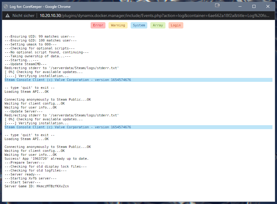

  24. Oh sorry! Didn't mention, that i blanked out half of the GameID for safety. I tried a bit and it's joinable from my laptop, but not from my Steamdeck. So maybe it's a Linux issue? I can PN the GameID if you want. Thank you for helping
  25. CoreKeeper connection issue: Hey ich777 I really enjoy your game server dockers, great job! But i´m facing an issue with CoreKeeper. Every time i want to join a server on my unRAID the game crashes on my client device. The log file has no errors in it. Any idea what i can try to fix this? Thank you very much
