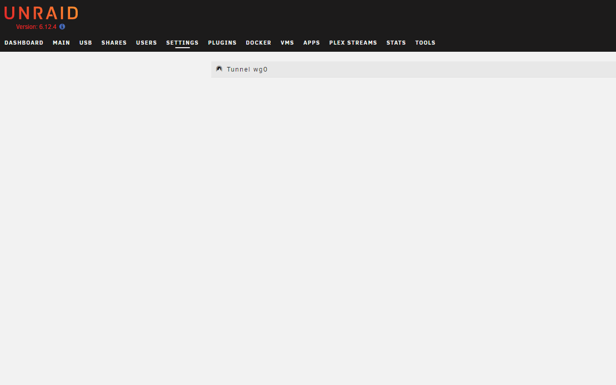

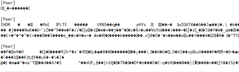

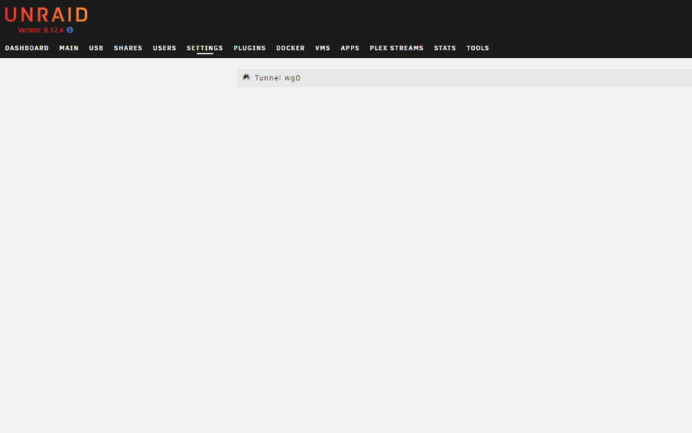

  6. I found the Solution...very simple, just delete the wireguardconfig that looks not very healthy in the flash drive. As you can see in the picture it does not look as a config should look like. As i explained first i forgott to extract the vpn config from the zipfile and uploaded the complete zipfile. So i think wireguard somehow tryied to build out of bits and bytes from the zip a vpn configuration and that in the picture is the result. My other VPNs were still funktional but i could not go to the adminpage of wireguard in the webgui. I think the webgui just coud not present those kind of symbols. Strange that there is no securitylayer that prevents somebody uploading a zipfile but thats how it is. I hope - if somebody does the same mistake in the future like i did now - this post will help.
  7. Hello there, i wanted to import a new wireguardtunnel - by mistake i did not unzip the tunnel first and uploaded the complete zipfile instead of the cfg file to import. After that my Gui in wireguard is looking like in the pikture. As far as i can tell wireguard is still working in the background but my webgui is gone. Even after a clean restart of unraid its not showing anything...so now i am not sure what to do. Any suggestions ? Did anybody had this problem before?

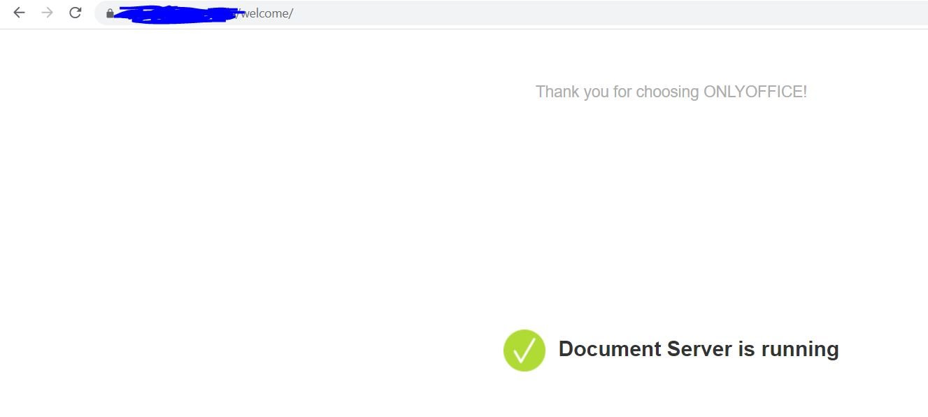

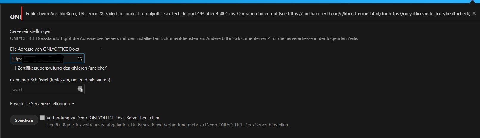

  14. Hello there, i posted it in General Support and now moved it into here. Nextcloudversion: 22.2.3 PHP Version showed in Nextcloud: 7.4.26 i updated my Nextcloud and sadly my Onlyoffice is not working anymore. I get this Errormessage: Fehler beim Anschließen (cURL error 28: Failed to connect to DOMAINNAME.de port 443 after 45001 ms: Operation timed out (see https://curl.haxx.se/libcurl/c/libcurl-errors.html) for https://DOMAINNAME/healthcheck)✖ My Onlyoffice is working and accesible over the Domainname in the Browser with a Certificate - i use Nigrin Proxymanager. I analysed some logfiles but cant figure out what the problem is, i just get the timeout which says no connection. Thanks for your help!
  15. Hello there, Nextcloudversion: 22.2.3 PHP Version showed in Nextcloud: 7.4.26 i updated my Nextcloud and sadly my Onlyoffice is not working anymore. I get this Errormessage: Fehler beim Anschließen (cURL error 28: Failed to connect to DOMAINNAME.de port 443 after 45001 ms: Operation timed out (see https://curl.haxx.se/libcurl/c/libcurl-errors.html) for https://DOMAINNAME/healthcheck)✖ My Onlyoffice is working and accesible over the Domainname in the Browser with a Certificate - i use Nigrin Proxymanager. I analysed some logfiles but cant figure out what the problem is, i just get the timeout which says no connection. Thanks for your help!
