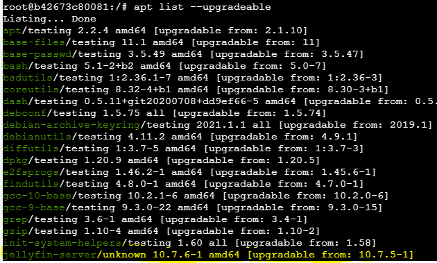

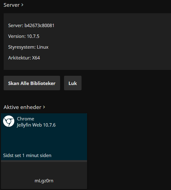

  17. @ich777 Do you know why the Jellyfin server in your container is not updating to 1.0.7.6 when the web client is?
