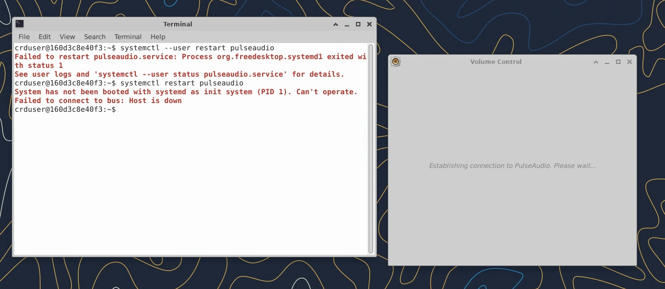

  1. Ok some great news so I figured out the audio issue it looks like the Pulse audio just fails to start with the system so it's simple pulseaudio --start actually gets the service running I'll need to just check if I can get it to start with the system so I don't have to keep turning on every time I restart and the Chrome seems to be working with the commands you provided I've added it to the desktop shortcut so you can simply open Chrome in that mode Thanks all!!

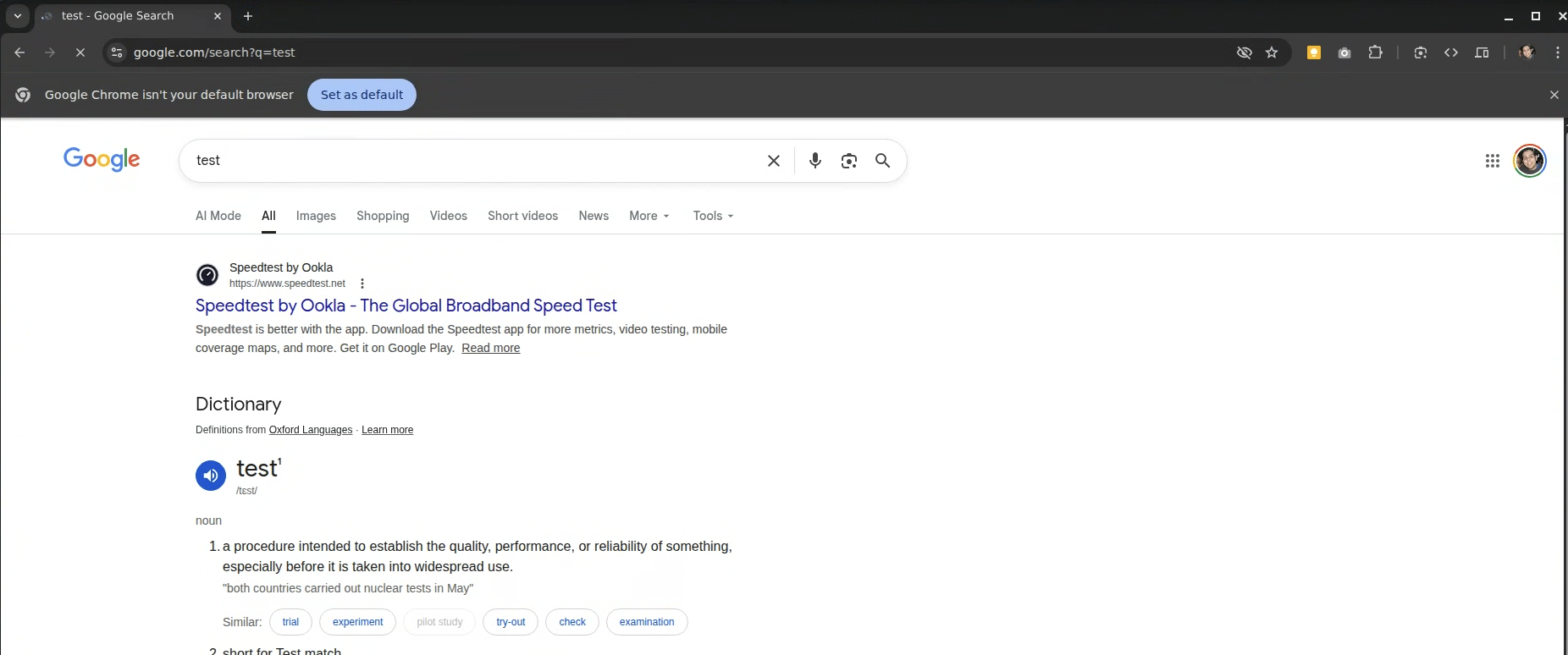

  2. Awesome! That works! Now I need to work out how to make that tthe default global metthod to lauch it. Ill try an keep trouble shootting the audio issue, but at a bit of a loss on that one.
  3. Hi Sure, so I load up chrome stable and initial page loads, but anything you do after that, like navigate to a page it just falls over: Does that help? I am also seeing the audio out just handing I tried to restart the service but got an error

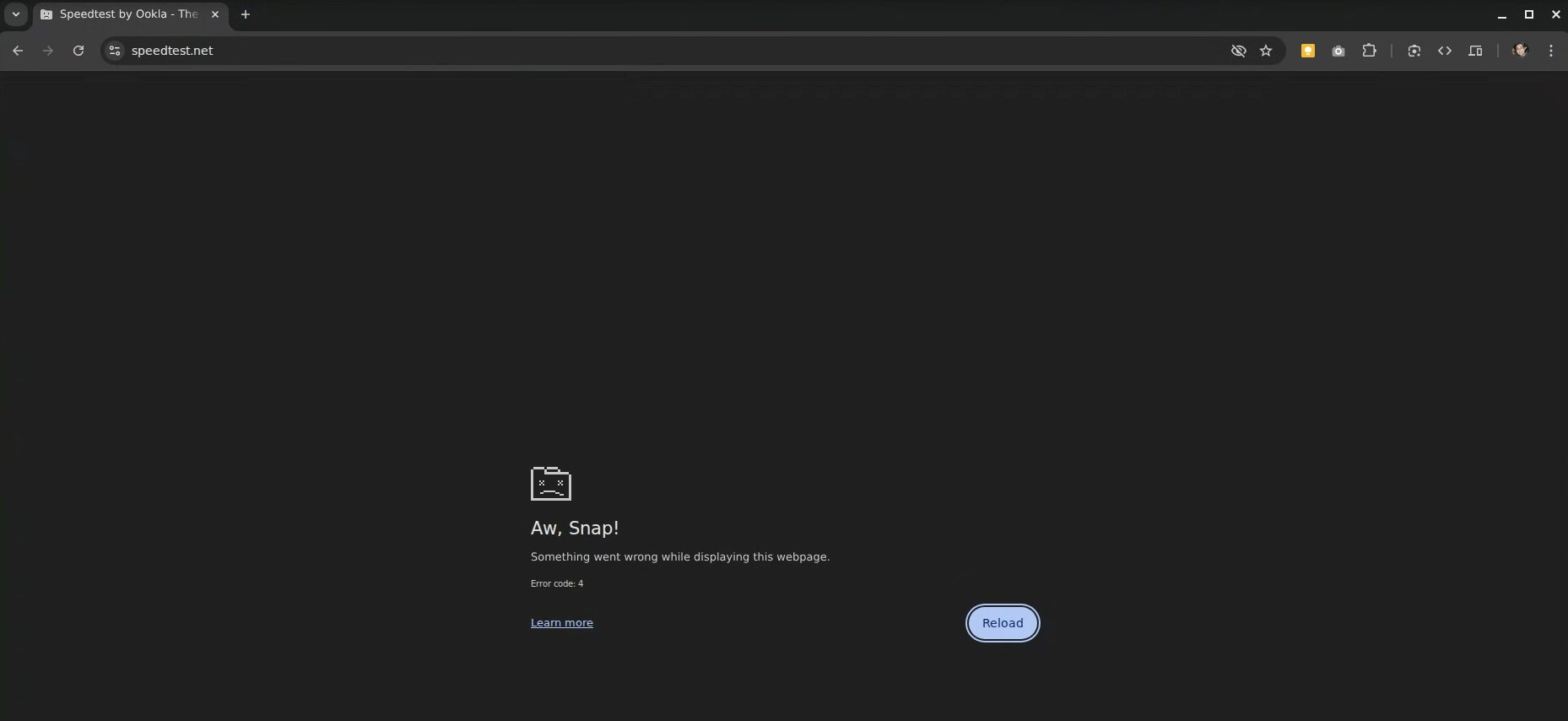

  4. Thank you so much @googleg this is a GREAT app. I fixed chrome not starting by checking prevlidged mode in tthe docker settup but chrome seems to error aftter trying to load any page, I gett error 4 anyone know what could cause it? Alsightly unrelated, I wanted to install the app PIA for all network to go through VPN if needed but I can not seem to get tthat working, it installes but it can not access any config files. Am I doing something obviously wrong?
