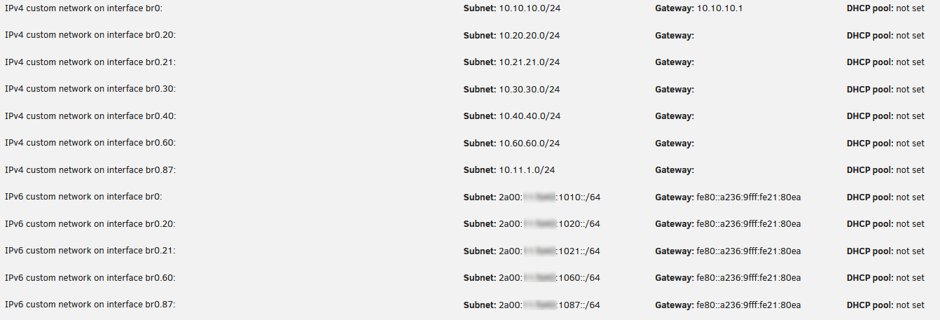

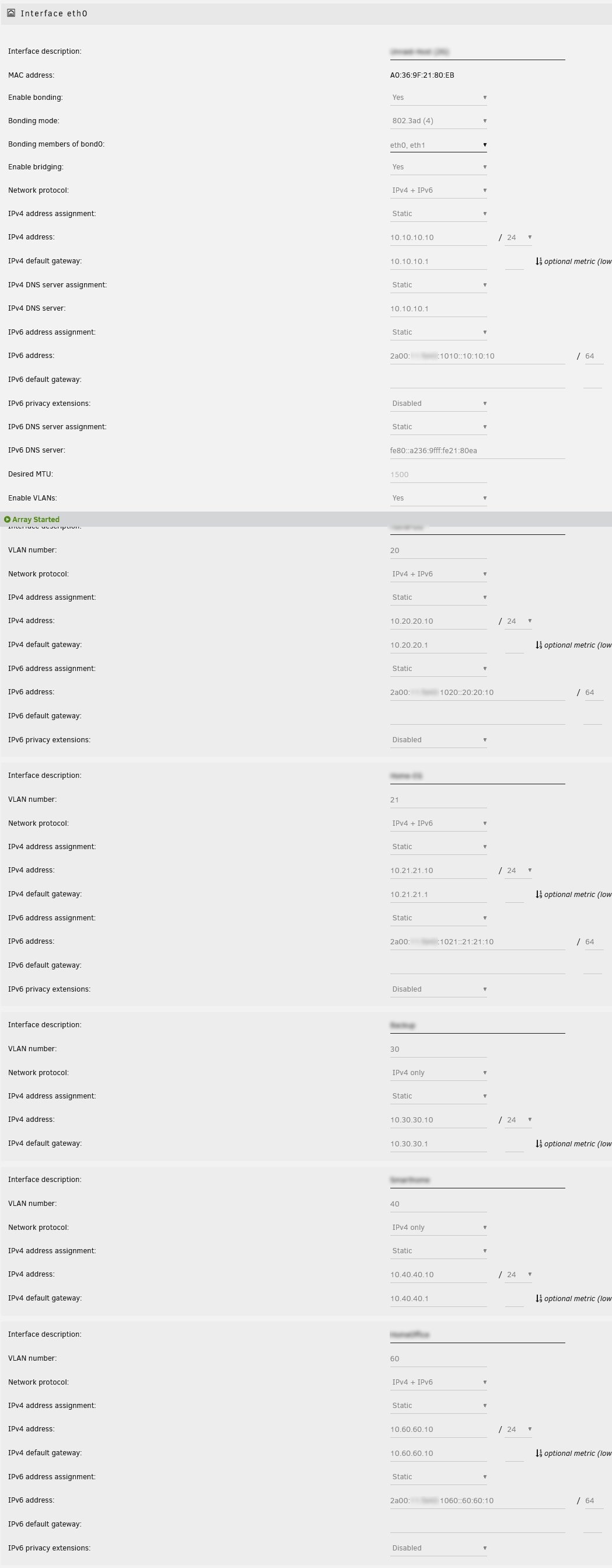

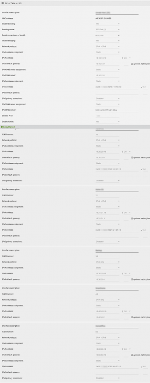

I use OPNsense as router. There DHCPv6 with Router Advertismenents is active. Fortunately, my provider has assigned me a fixed IPv6 prefix. For the Docker I would like to use static addresses. For testing I tried to reach the Docker from the router via ping. The Dockers are also in different VLANs. Here are the settings:
